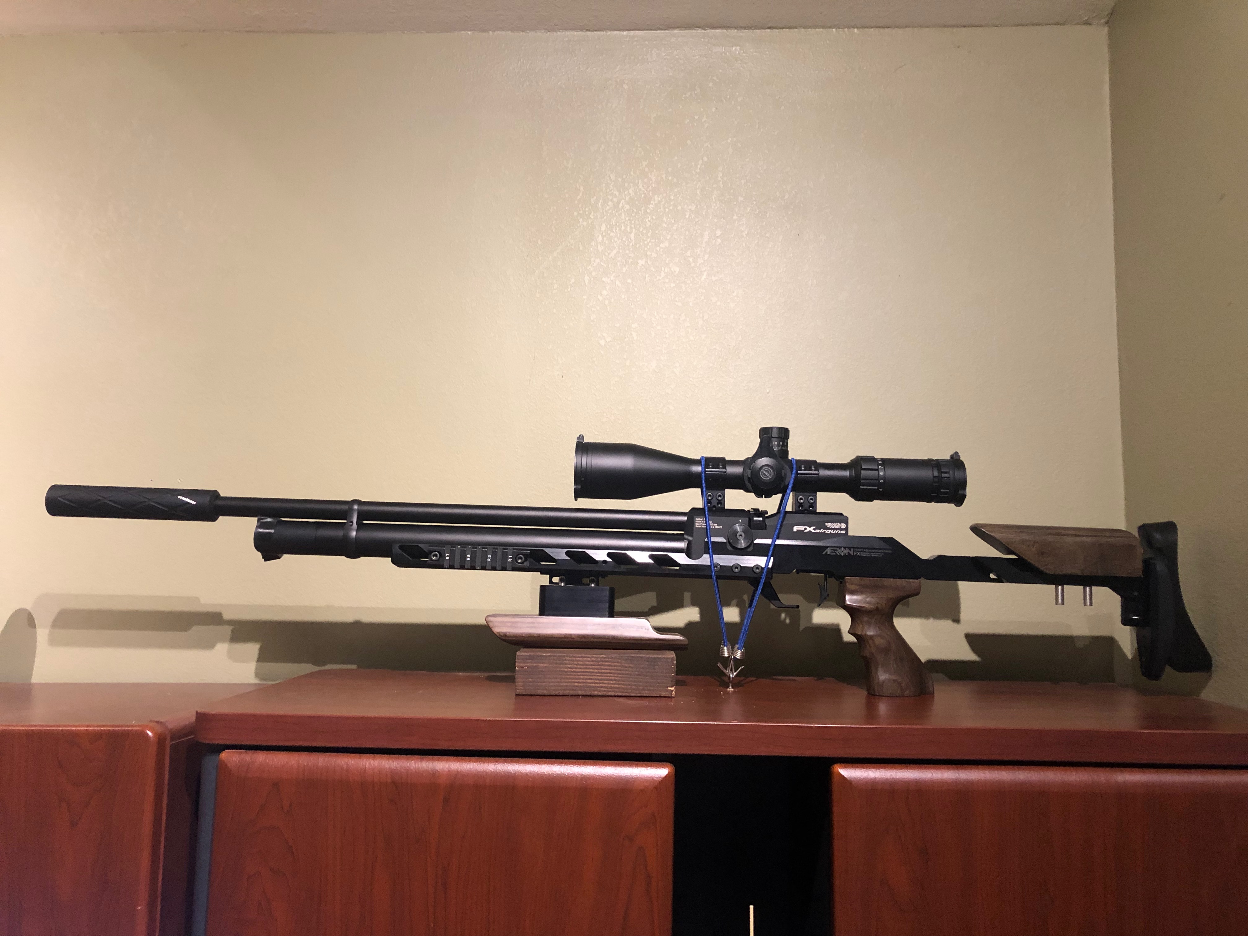

I was looking at an FX Dreamline that Utah Airguns had in Field Target trim that had a chassis rather than a regular stock. It looked a little bit like that. I wondered if the Dreamline regulator setup could be adapted to the Streamline. The Dreamline's regulator is in a tube that is the same diameter as the pressure tube and sits between the pressure tube and the receiver area. If you could just put that short regulator housing section on a Streamline you could have external regulator adjustments.
I ended up going with the Crown because it does have a bottle and an easy hammer adjustment for swapping barrels. I got .22 and .177 barrels with it to try a few things. I liked the GRS stock so I went with that but apparently there are companies that make chassis setups for them.
