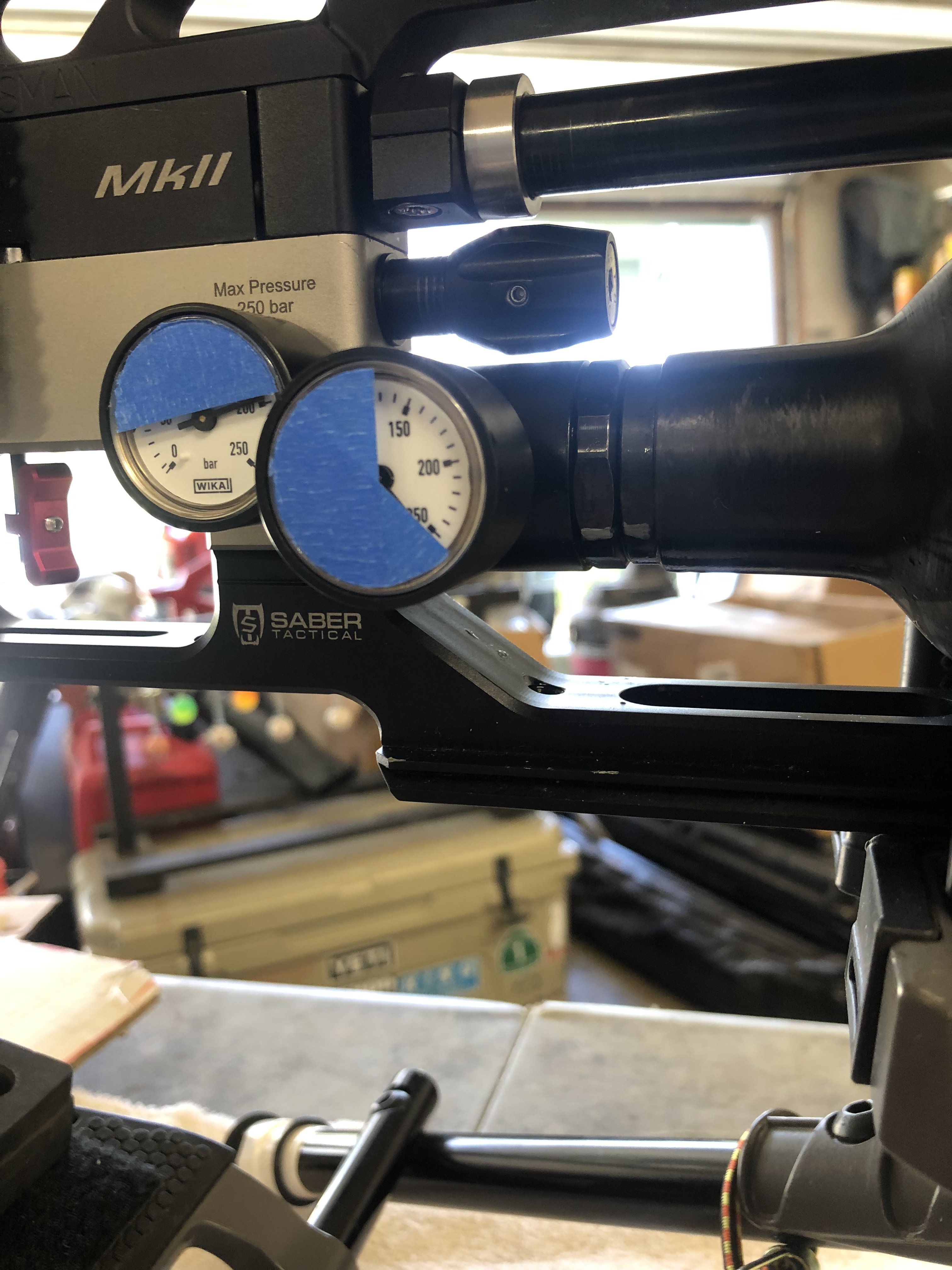

Leaks. A negative that goes with this pcp hobby. Before you stress out and feel like your whole guns gonna have to be in pieces, check the Dowty seal at your bottle to block connections first. It’s been my experience that these types of leaks start of really really minute, like less than 5 bar in 24 hours. It could easily be passed off as a pressure loss due to temp fluctuation. I monitor my air pressures regularly and have gone as far as permanently marking my gages with tape as a small leak if gone un noticed will eventually erupt into a large one at the worse time.
