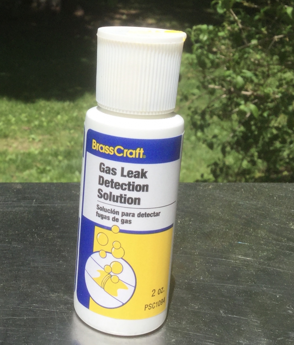

This is what I use, I got it at Lowe’s, it’s viscous so it clings and show them tiny bubbles.
I'm sure the purpose built stuff is best, but I've had good luck with any medium viscosity oil, assuming I can get the applicator to the joint. I've never used WD-40, but it seems that something a little thicker would stay in place longer to disclose a small, slow leak. I've always heard of soapy water too, but I would only use it if the location can be thoroughly dried afterward.

I admit the leak detector I used; barely barely revealed my slow leak. It showed only very very tiny bubbles. I was about just place the whole gun in the bath tub filled with water. I was about to ask about potential implications but refrained due to the potential for embarrassment. Depending on leak location, leak detectors will not work.
