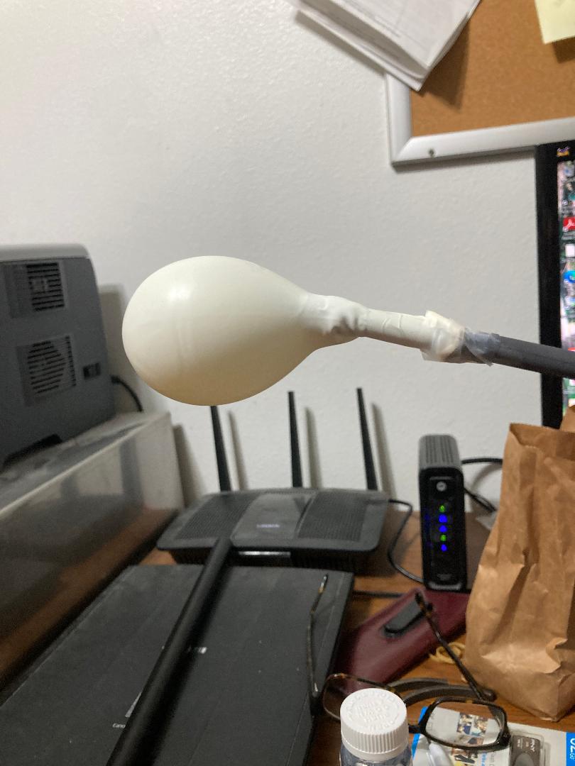

I will second this. I did exactly this on my streamline (dry fire down) and now the valve is leaking. Going to have to buy a new one because of my dry fire.
this what i did
