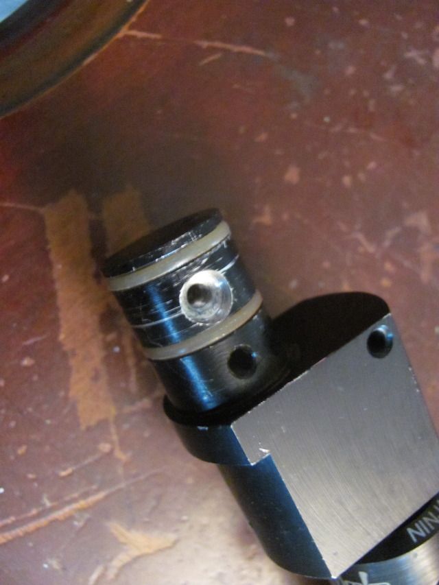

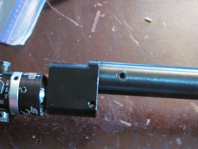

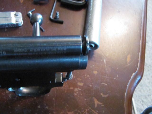

The adaptor screw on the left side was the main culprit ( I thought ) and note the screw is much heavier grade and placed further back than factory QB sthuff

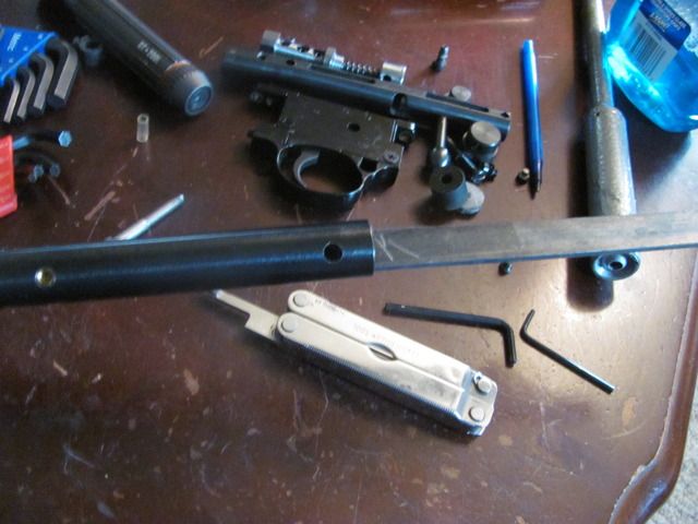

On the adaptor you can see where this one is drilled for the new anchor screws compared to the factory screw holes much closer to the end, standard PB o-ring

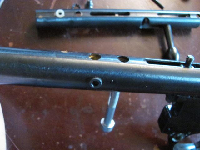

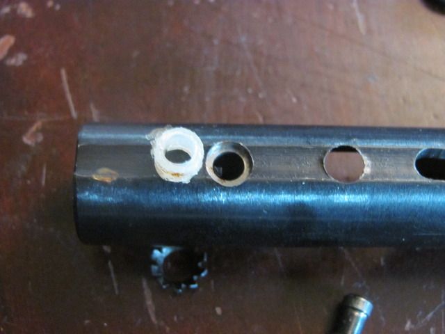

Barrel must be removed to expose phillips head screw under pellet tray ( machined into barrel )

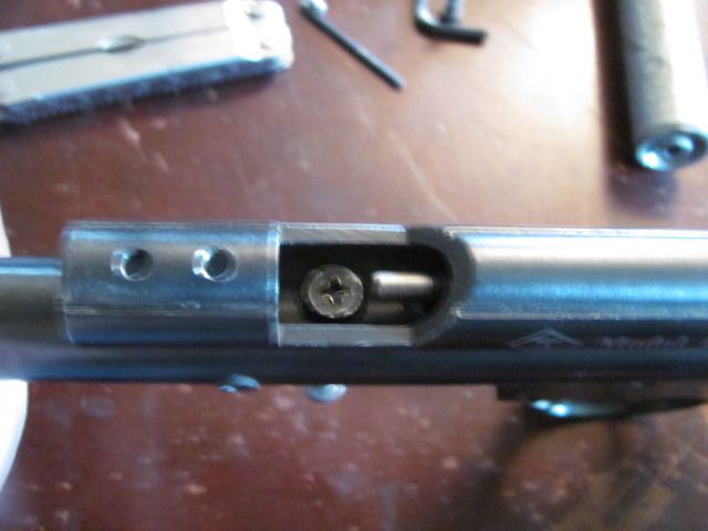

and the rear trigger group screw goes through the trigger housing/main tube end cap and receiver end cap holding the top end on

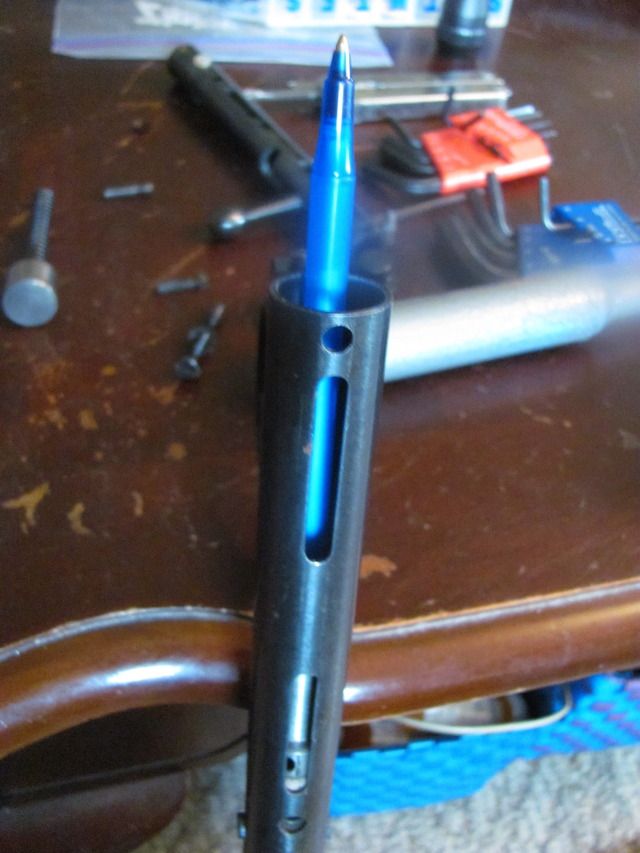

After removing everything in the way I used a Bic pen to press the hammer for degassing, just took a gental pressing

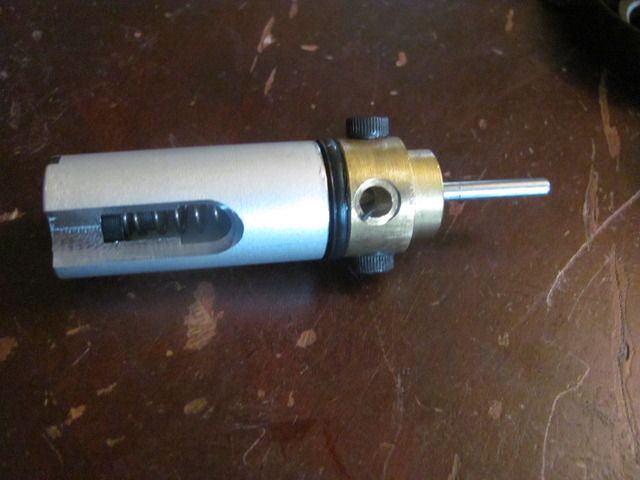

The valve is a two halve type and you must unscrew the front half slightly to relieve pressure on the oring so it will slide forward it requires a special tool such as a screw driver that fits or a section of 1'8" bar stock in this case, took about 1-1/2 turns to loosen
Note the valve is slotted ( only a small hole in front from factory ) this is THE QB and many other ( 909 big-bore ... ... ) airguns. And again note the extra retention for safety screws even though I run 1,000psi and the valve port milled to fit poly line transfer port tubing

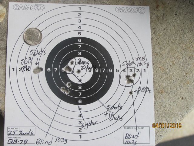

With JSB 7.9
H-940
L-927
AV-932
ES-13
Sd-3
right hwere it should be though I slightly smashed the pellet shooting the lowest number so maybe a bit tighter numbers?
10.3g JSB
Av 855.
To windy for group testing but it normally shoots well enough to win a competition if I just hand it to a good shooter.

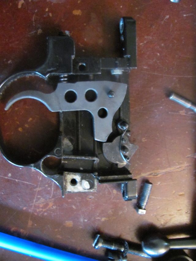

Trigger group for those that haven't seen one. Engagement can be taken WAY down safely.
