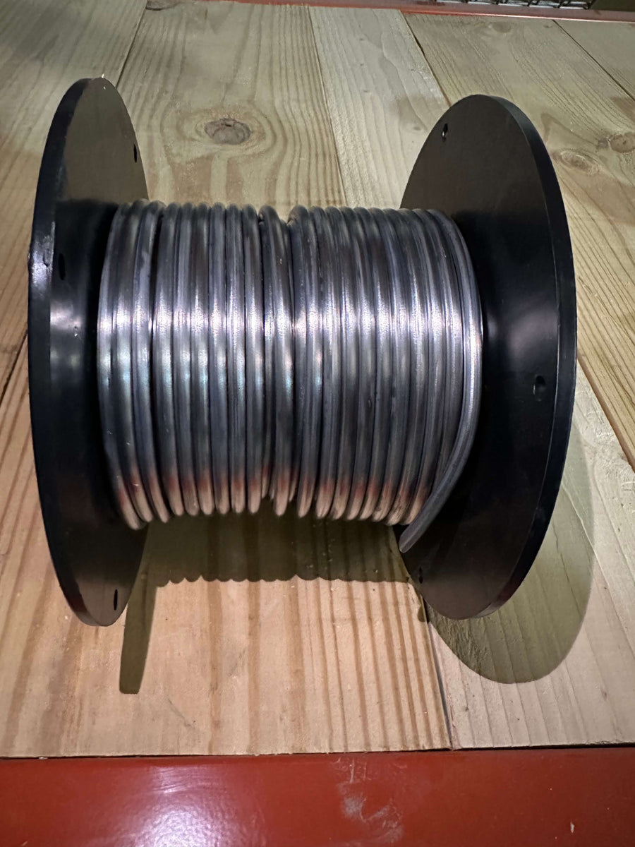

Lead Wire for swaging slugs / pellets
Want to make sure people know where to get lead wire from as I put the links to purchase on a different website. Everything stays the same except what site you go to purchase.

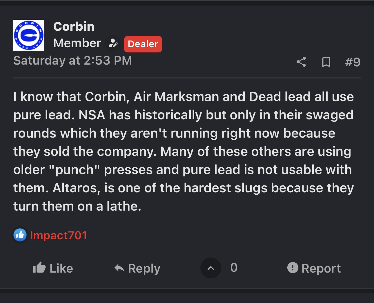

Whomever is running the Corbin account said that “they” sold the company.

If their, NSA, swaging lead is the lead they are using in the production lead.....it isn't pure lead. There has to be something else in it as it is much harder than the 100% pure lead from Corbin, and other manufacturers for bullet casting.
here’s a link to the thread
Looks like NSA is partnering with Air Venturi. That’s the best I’ve found regarding a sale of the company (NSA).
