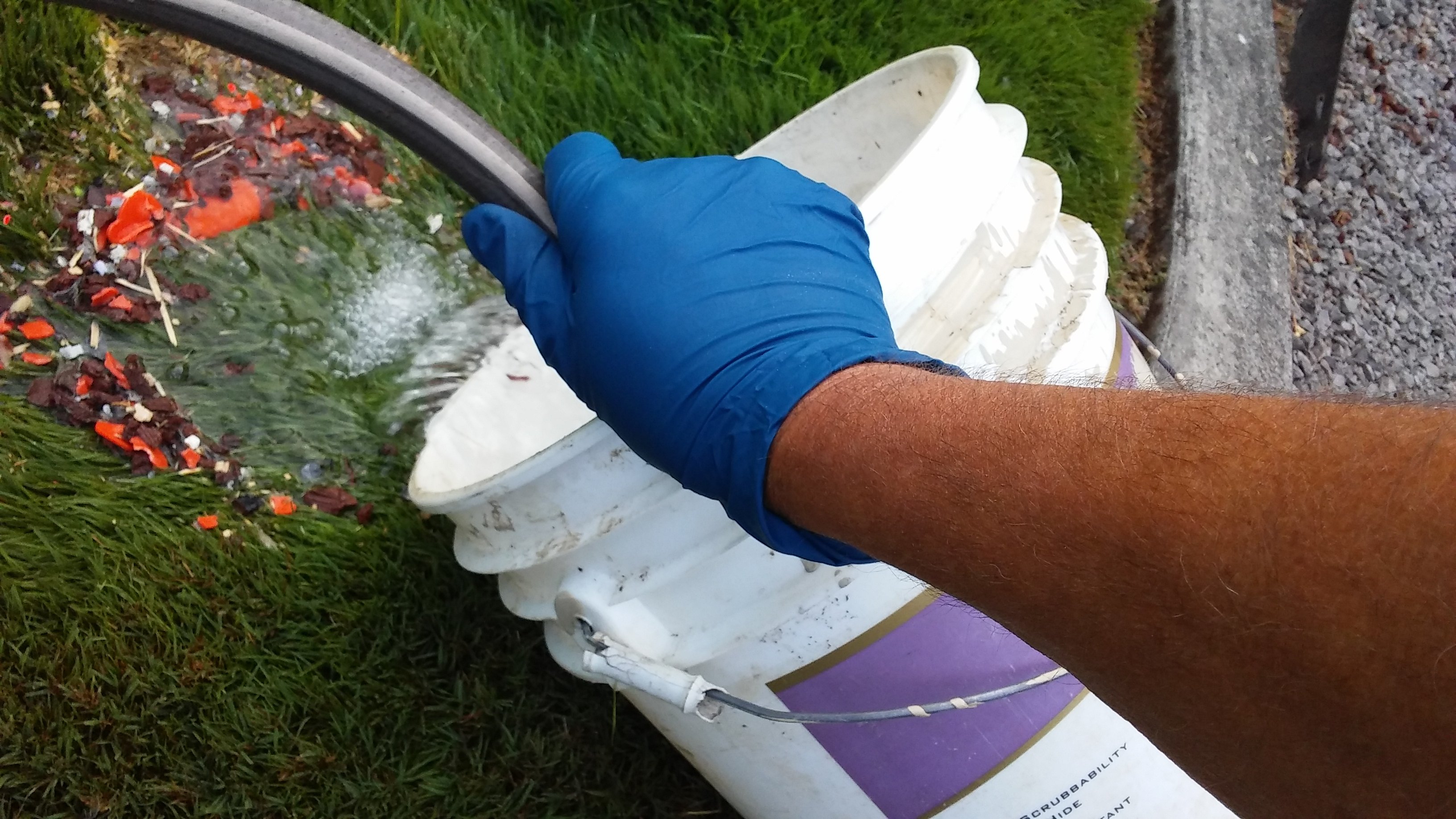

#1 Pour the rubber mulch into a screen - take out the big pieces & put into another bucket
#2 What's in the screen & on the floor put back into original bucket
#3 Picture2lean bucket almost touching the ground, stick hose into pellets turn on with good force--- this will wash out all debrie's and leave the lead in the bottom of the bucket.
#4 Picture 3 final out come
Unless they make different mulch's most of it sinks like 99.9%

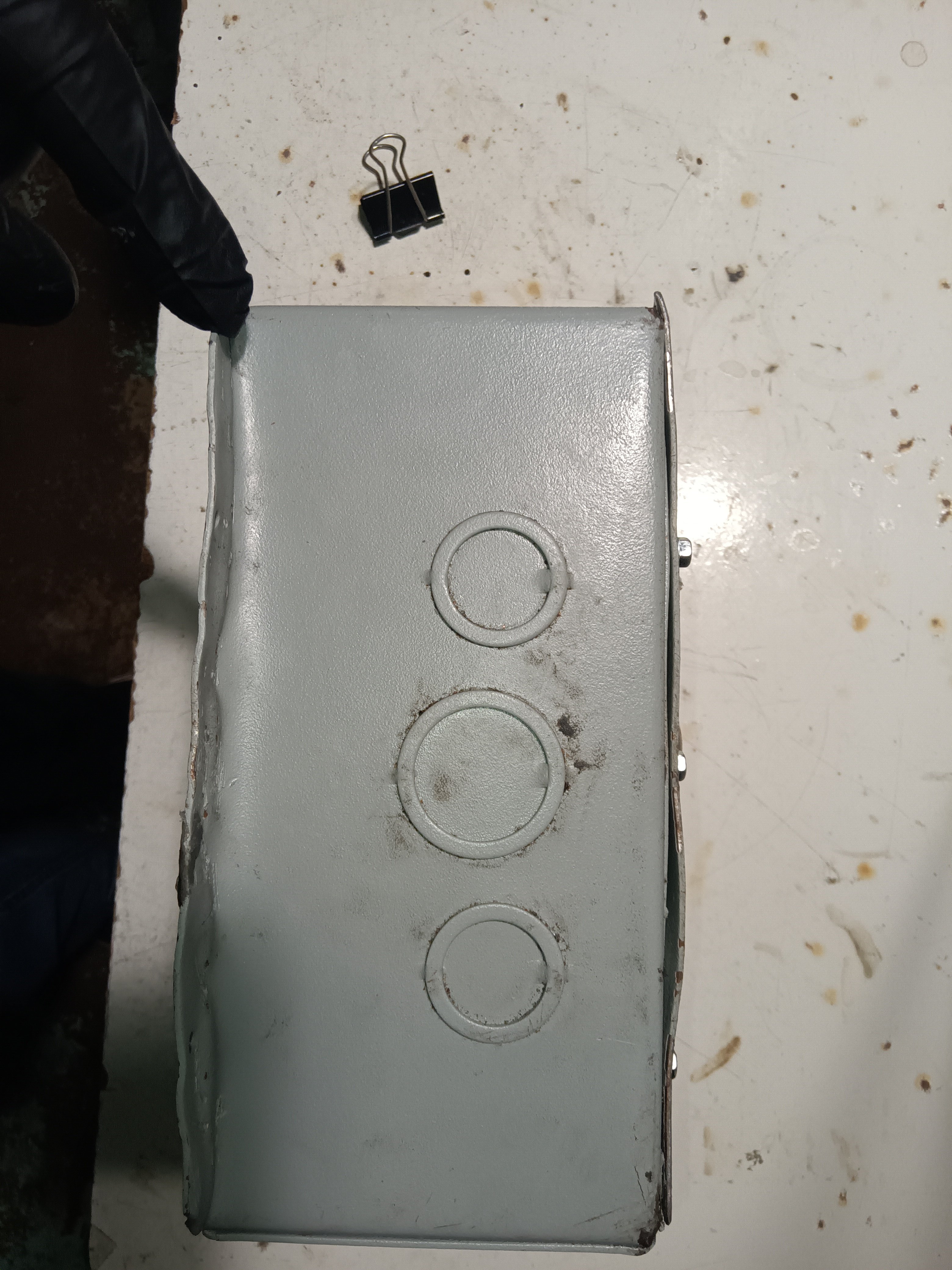

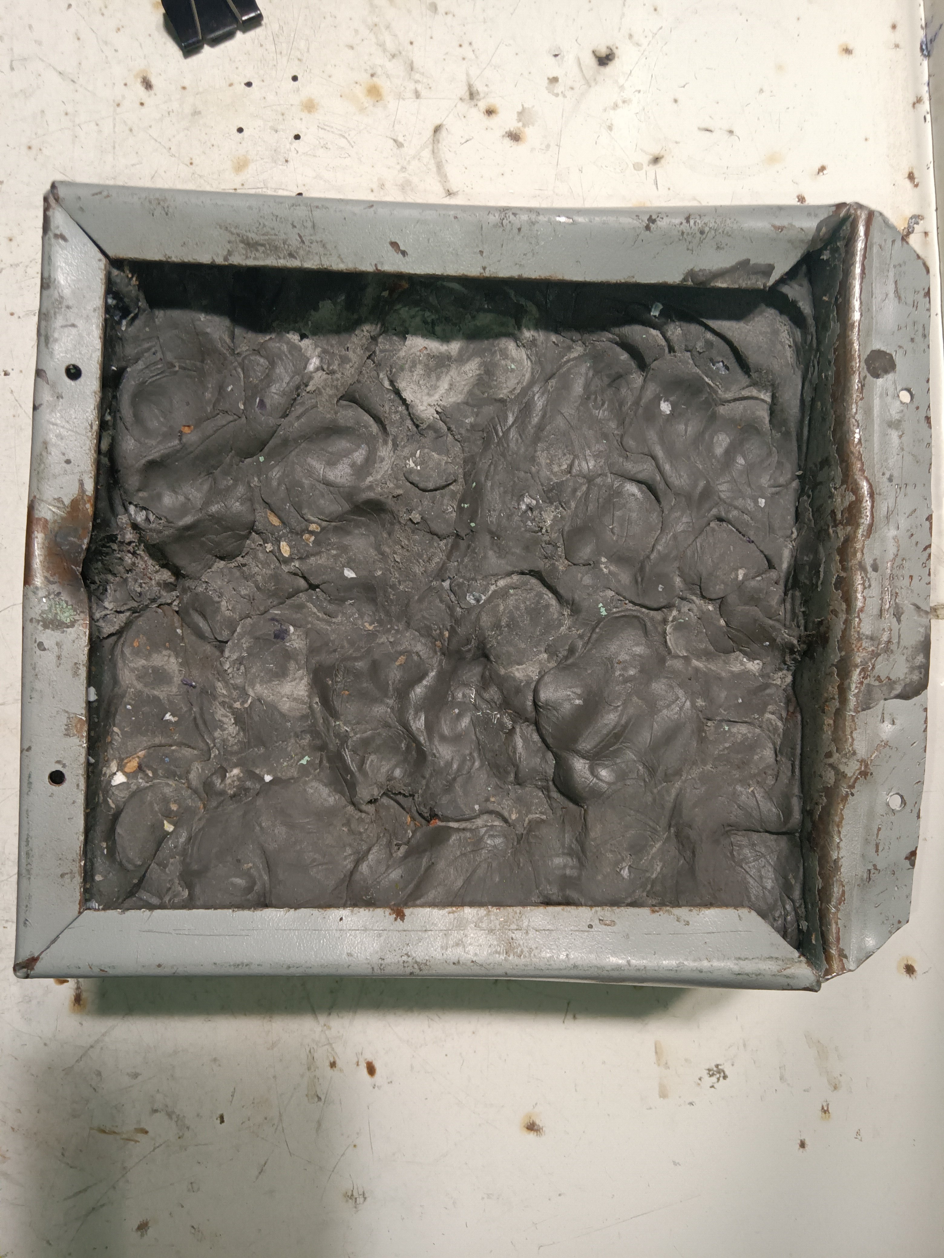

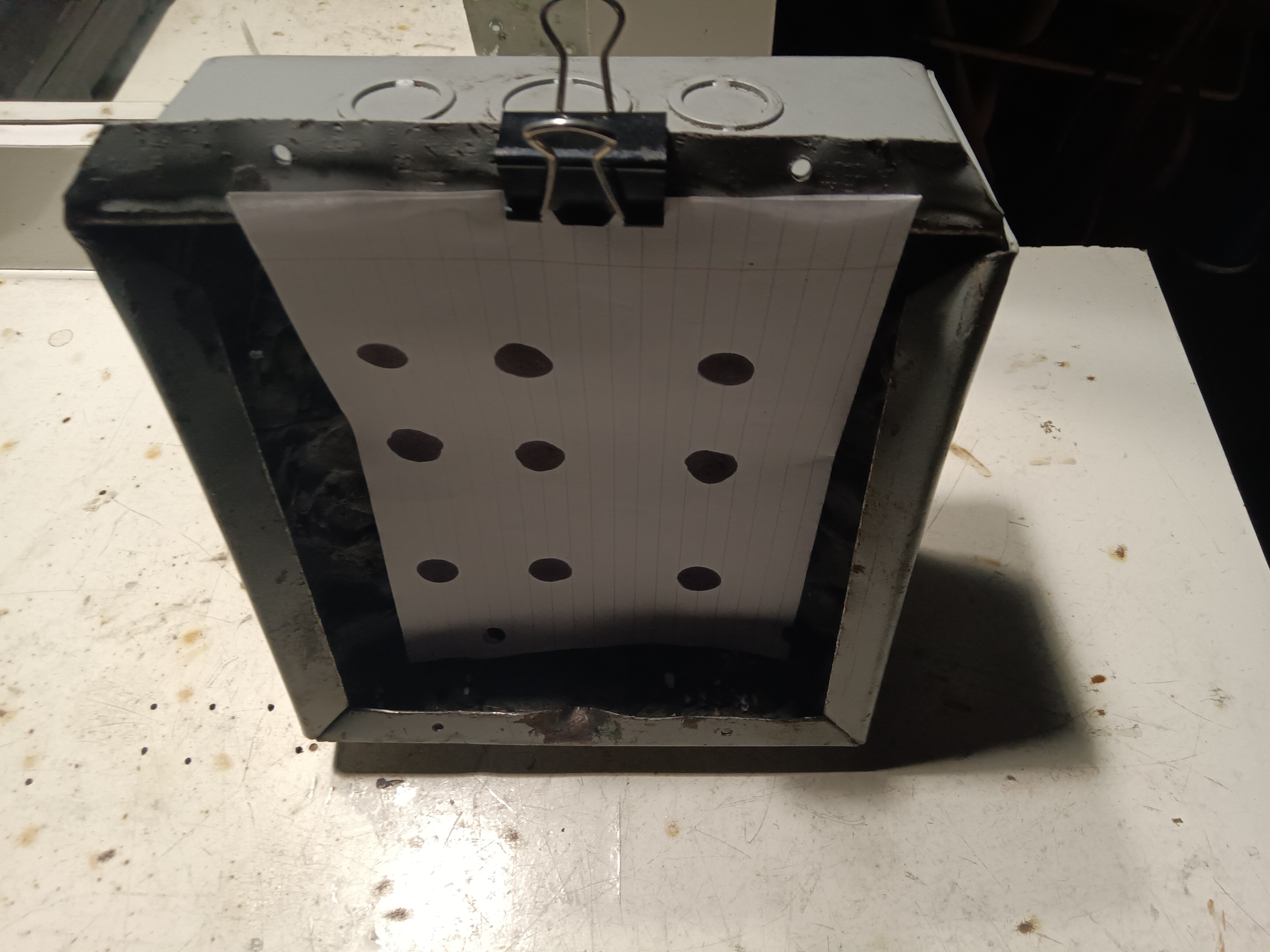

I recommend making a pellet trap out of a metal electrical breaker box from Home Depot, filled with Duct Seal from the same electrical department!
Mine takes 195 fpe from 12 yards away on the regular and I repack after each target change. Whenever it gets too heavy I dig out and recycle the lead, separate on the garage floor and repack pellet trap. Any ductseal left on the lead burns off easily in the melting pot!
