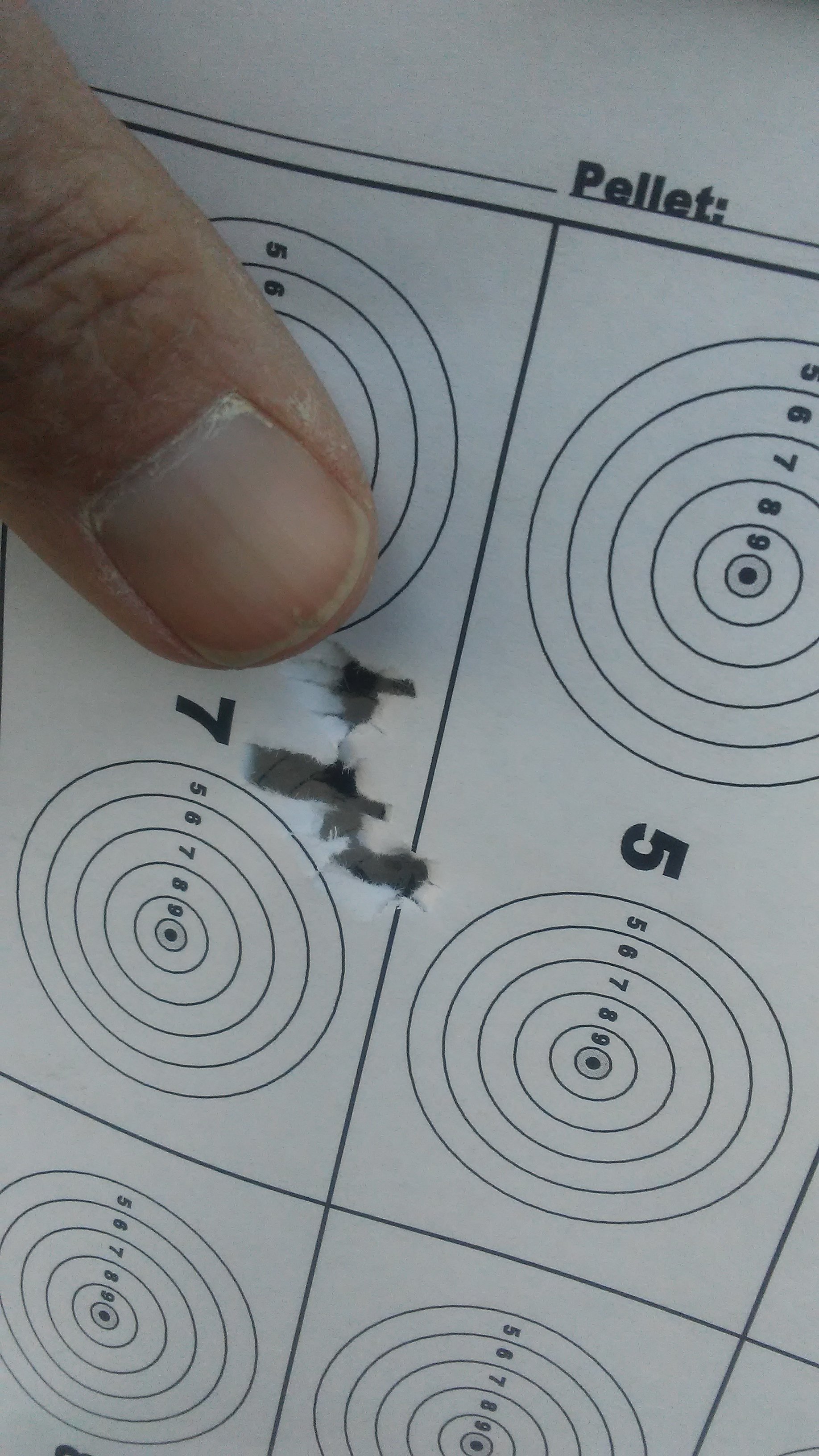

Here's the result of just a quick try with Predator GTOs in my FX Royale in .22.
It shoots 18.1 jsbs at 880 fps or so, didn't chronograph the GTOs. 6 shots at 30 yards on full power, pellets did not go supersonic.
the lower group was shot on medium power, the light wind seemed to really open up the group.

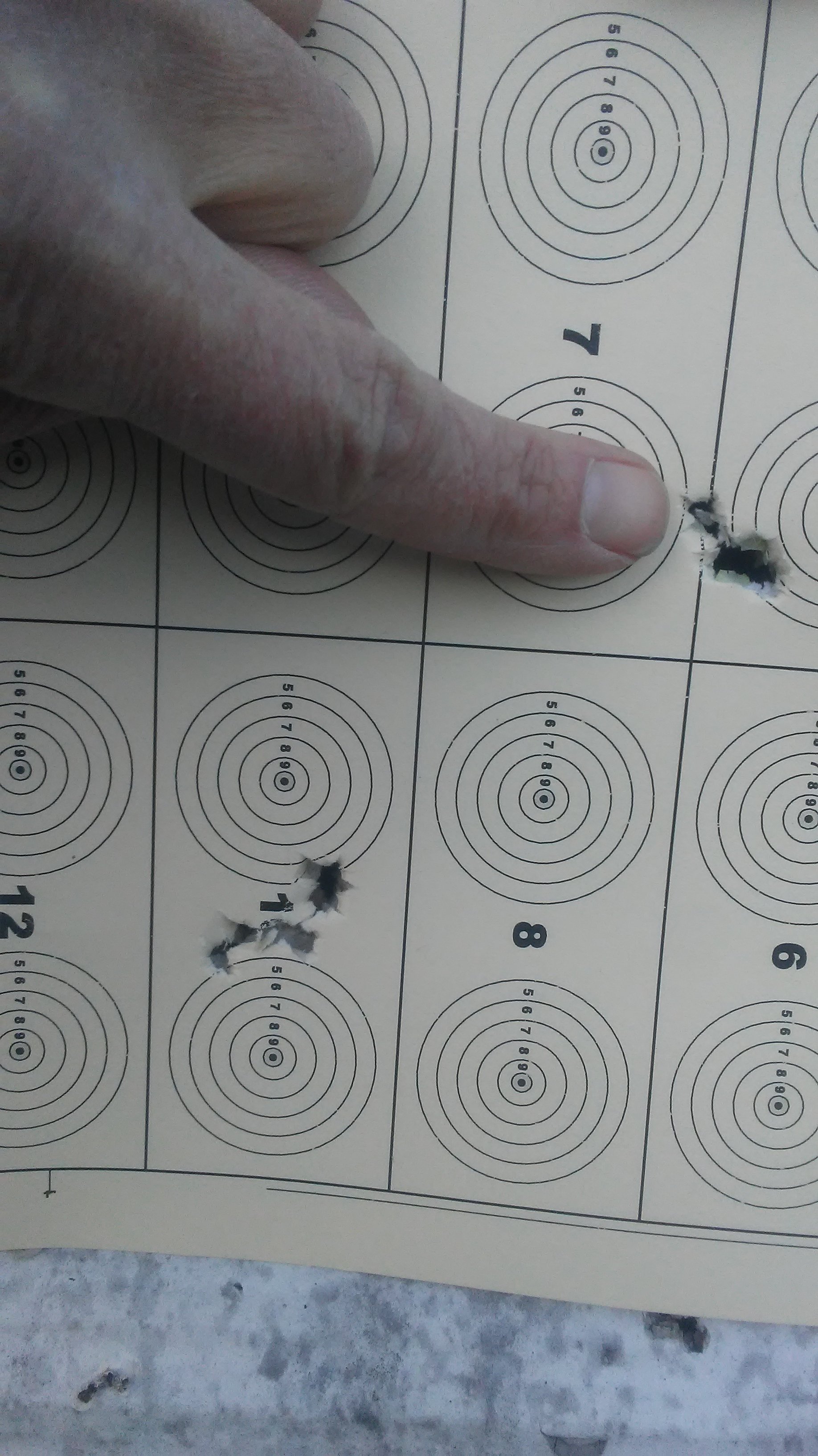

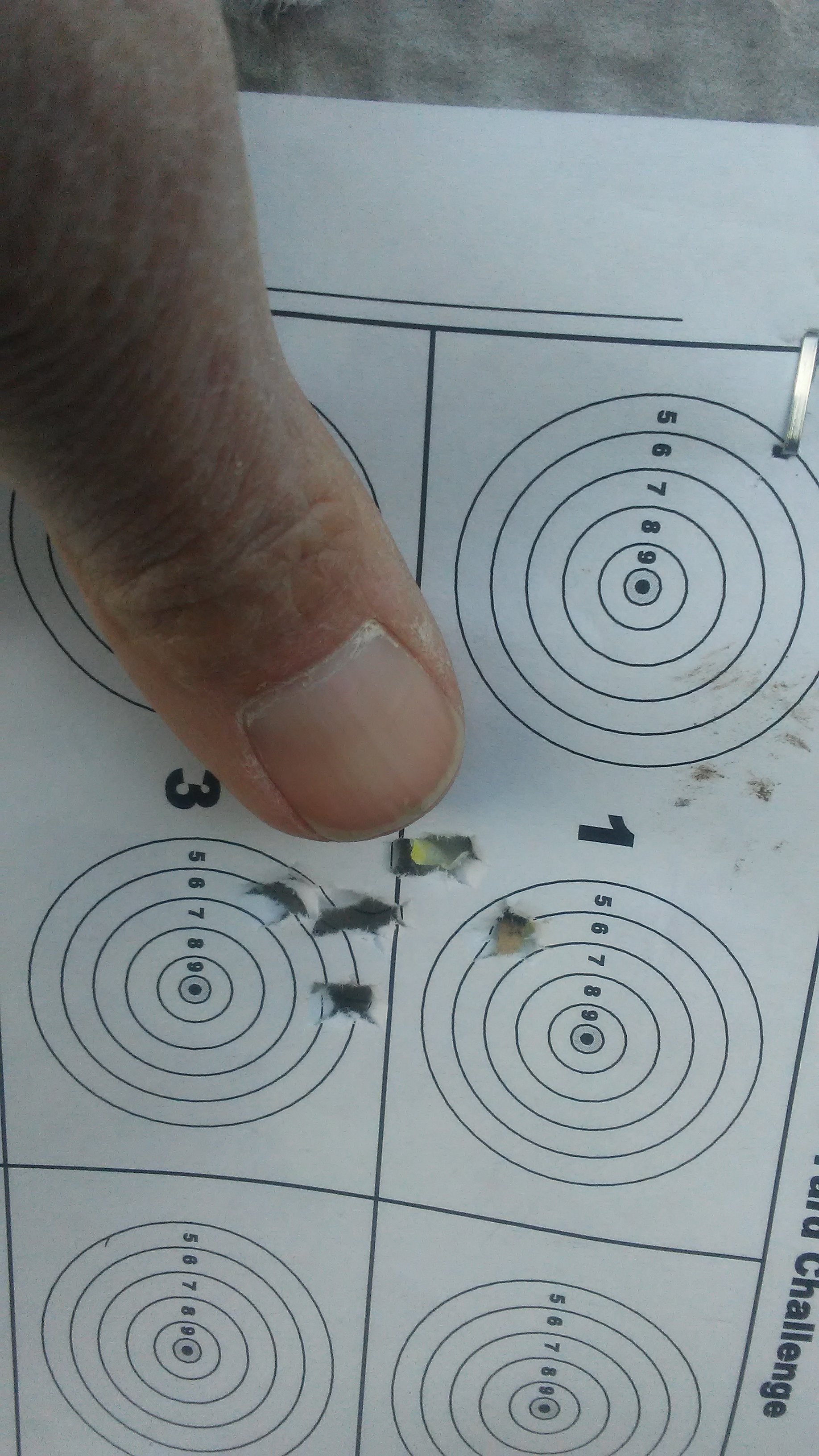

Here's a couple shot at 50 yards.
I'd be ok using the GTOs for hunting out to 50 yards for hunting IF it wasn't too windy.
It shoots 18.1 jsbs at 880 fps or so, didn't chronograph the GTOs. 6 shots at 30 yards on full power, pellets did not go supersonic.View attachment 328740the lower group was shot on medium power, the light wind seemed to really open up the group.
View attachment 328741View attachment 328742I'd be ok using the GTOs for hunting out to 50 yards for hunting IF it wasn't too windy.
It started getting chilly so just a quick test. They show pretty decent accuracy IMO.
Excellent report! Thank you for taking the time!
