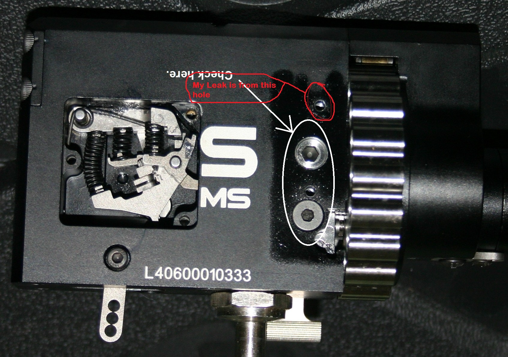

My leak is from the upper hole, which is for flip door cover screw. I marked the hole with color. Please help me.
I have attached a picture showing you the screw hole of leak ( flip door screw hole) .
Probably leaking somewhere inside, and exiting out that hole.
There's no way that hole is holding pressure. Just holds the the loading door on.
I've never found a diagram or exploded view of this gun, so you'll need to take it apart to see where it leaks.
Good luck with that one.
