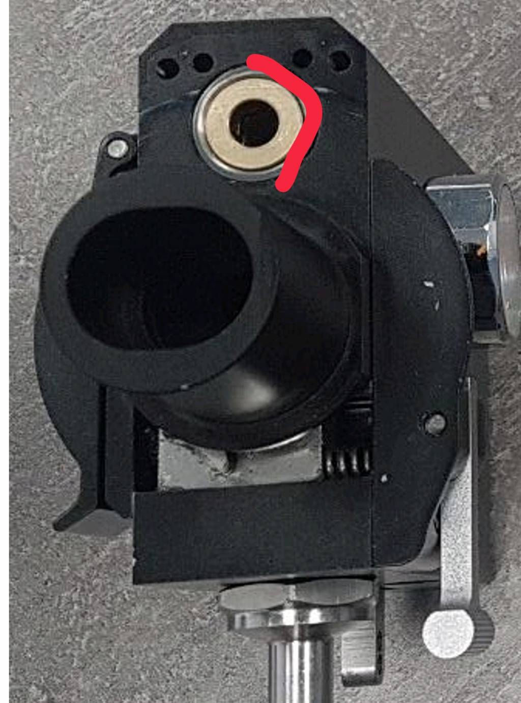

I found out they are all over the place. Even at 40 yards the are not grouping at all. Left, right, low,high. I have some JSB's (Mk1 heavy 33,95gr) left and they still perform well so it isn't the gun itself. The combination of pellet and gun is the issue.
I tried everything I can think of: speeds from 700-1.100 fps, inserting the pellets deeper in the magazine, polishing the inlet and crown, shooting without silencer, lower reg pressure, cleaning the barrel.
Nothing works. The pellets also make a whistling noise. Probably this is not normal with this pellet? So something is damaging the pellet.

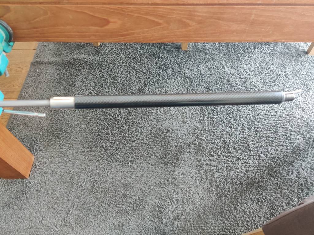

Tomorrow I will try the modified FX superior liner in the LCS to see what happens then. With slugs this is no improvement. Maybe with this pellet it is...

My polishing etc. did nothing for accuracy. Only around 680-700fps they seem to work a bit better.
I will try the FX barrel maybe later this weekend. It could be that the smooth twist is better for these light pellets. I also tried these pellets today in an Evanix Giant .25. They don't perform great either in that gun.
