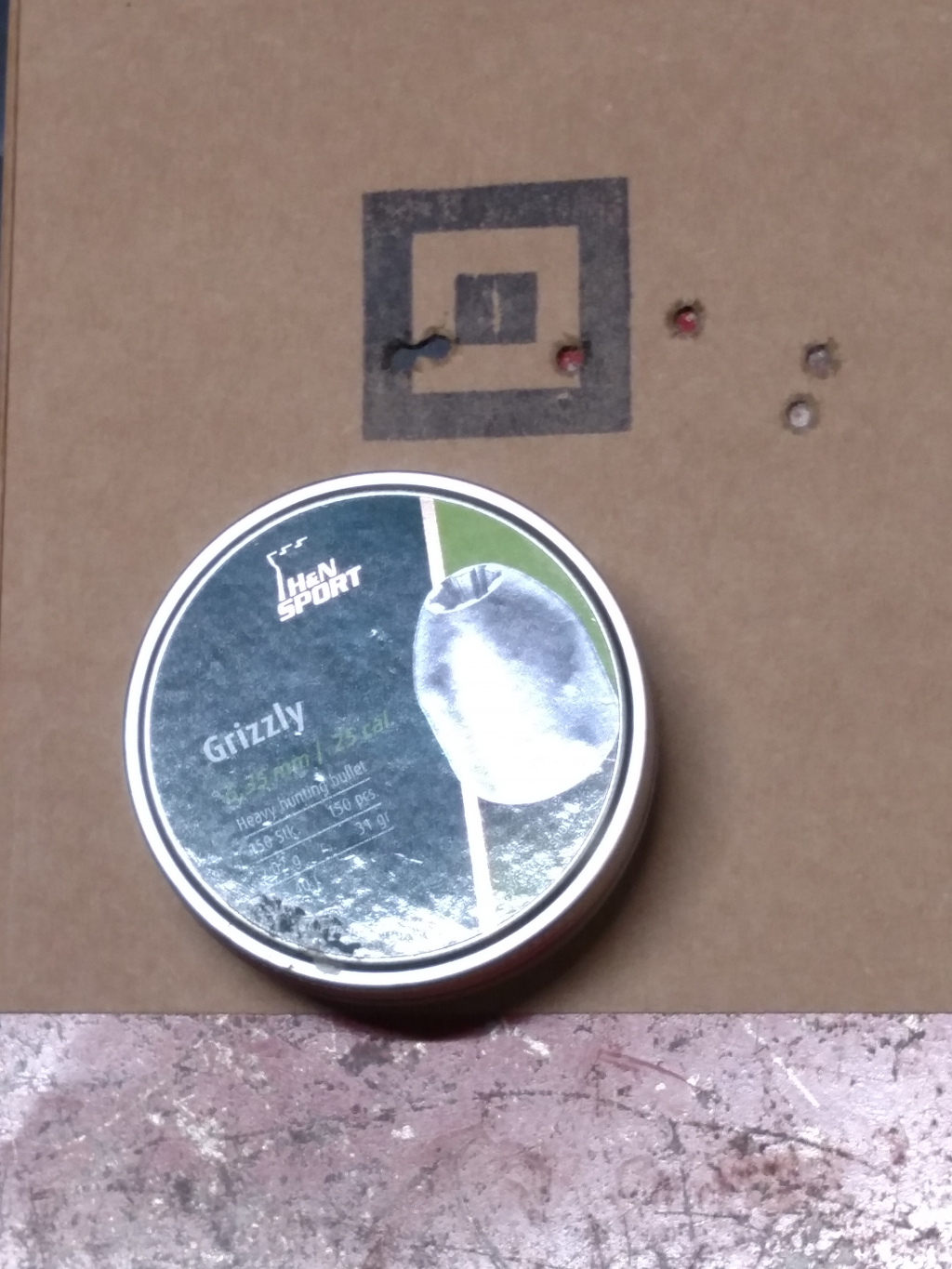

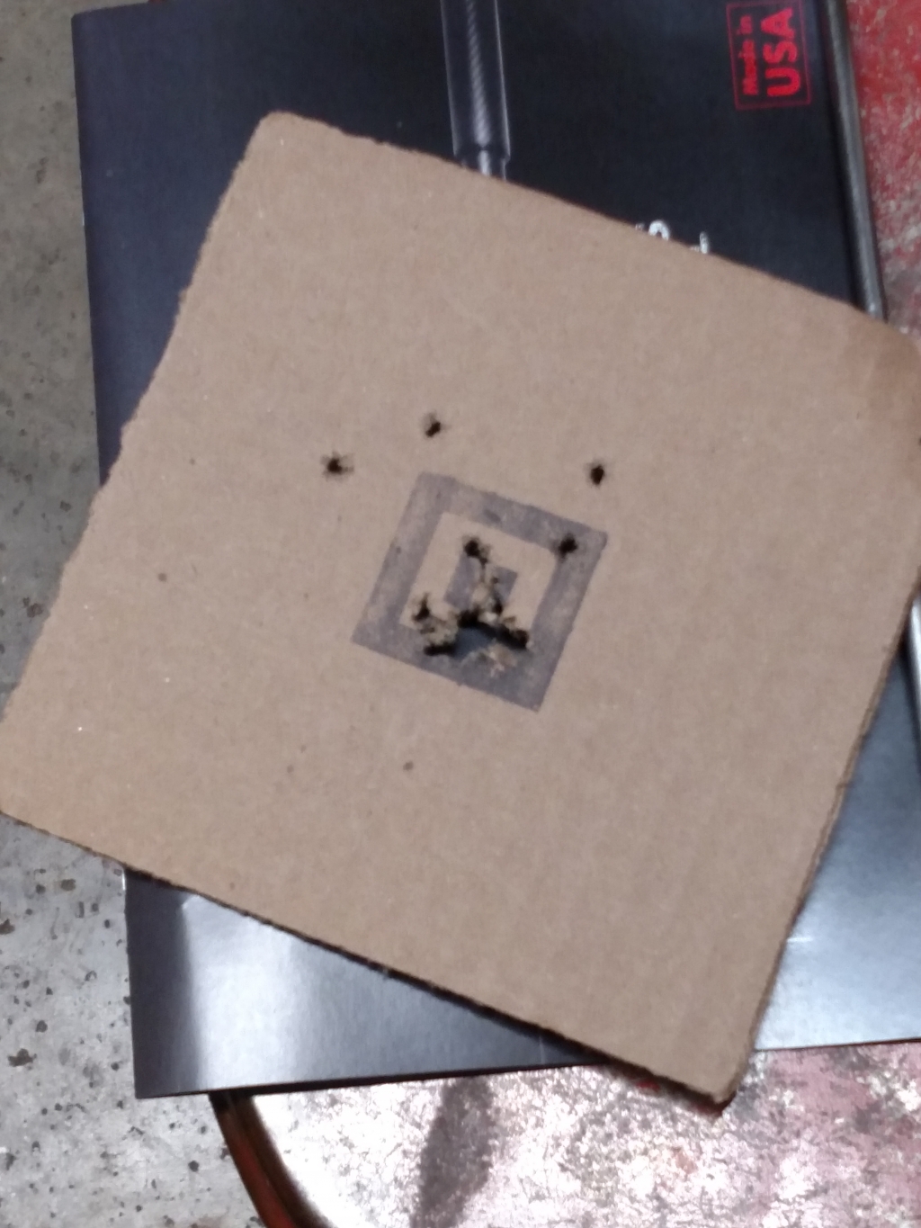

It did not like H&N slugs at the "as shipped" settings.
Here is the target shot with completely reject .25 MP cast bullets. Some fell into the mag and some had to be forced in with my thumb.I was impressed with this.

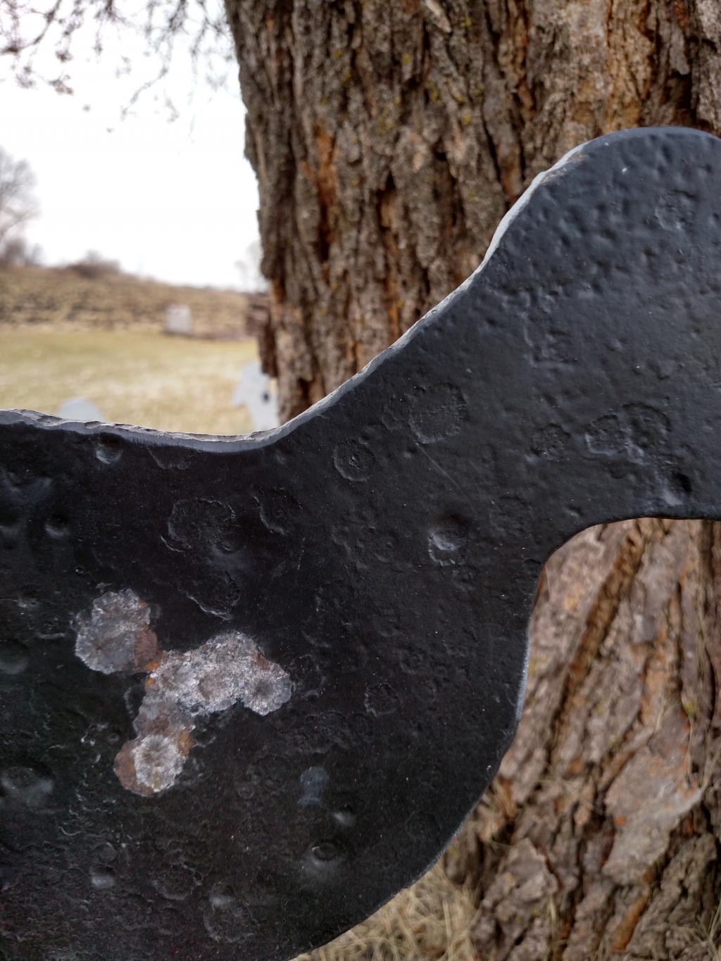

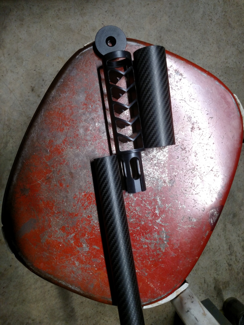

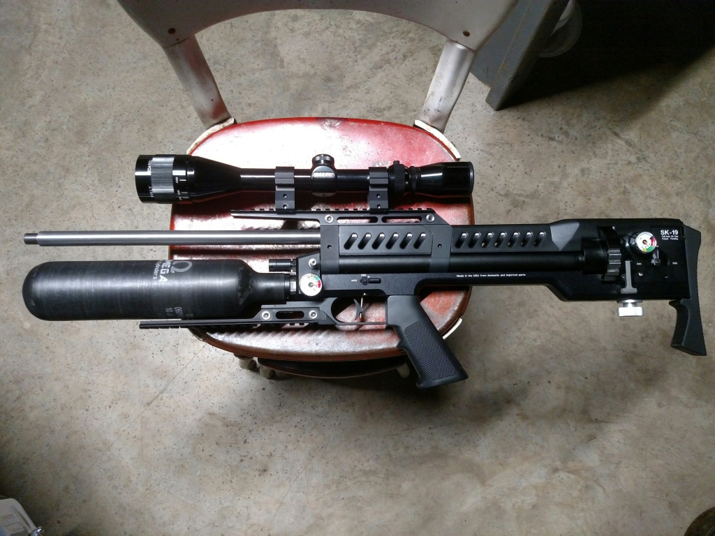

Nice heavy barrel. Oh man is it loud when it is shot naked like this.
Air stripper moderator.
Hope to take it outside tomorrow...but it's supposed to rain :(
 The above was shot with a wobbly cardboard tube as a rest at 50' indoors. I'm sure it will do much better with a solid rest and my Aztec scope when the 30mm rings get here. The things I didn't like is the long bi pod rail seems to flex quit a bit and the trigger is kinda wonky. Came with a pack of about 25 different 0-rings, but the instructions say nothing about replacing any of them and warns that disassembly will void the warranty.

It's hard to describe.... but doesn't seem any louder than all my other PCP's with moderators. It sounds 'crisper' with a shorter duration if that makes any sense. The moderator/air stripper feeds the shroud and the shroud and moderator cover are carbon fiber tubes instead of aluminium....and that may be why it sounds crisper.

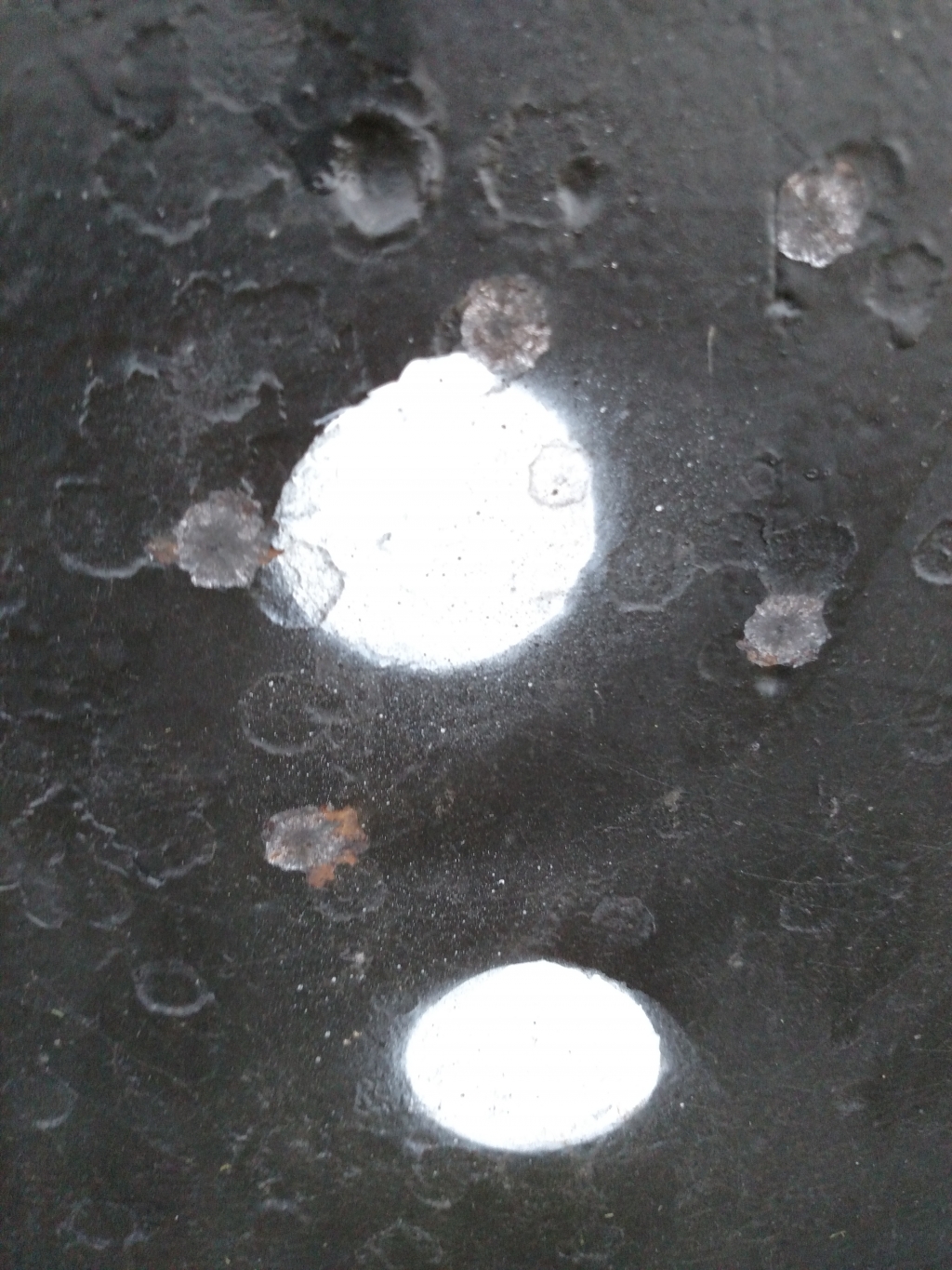

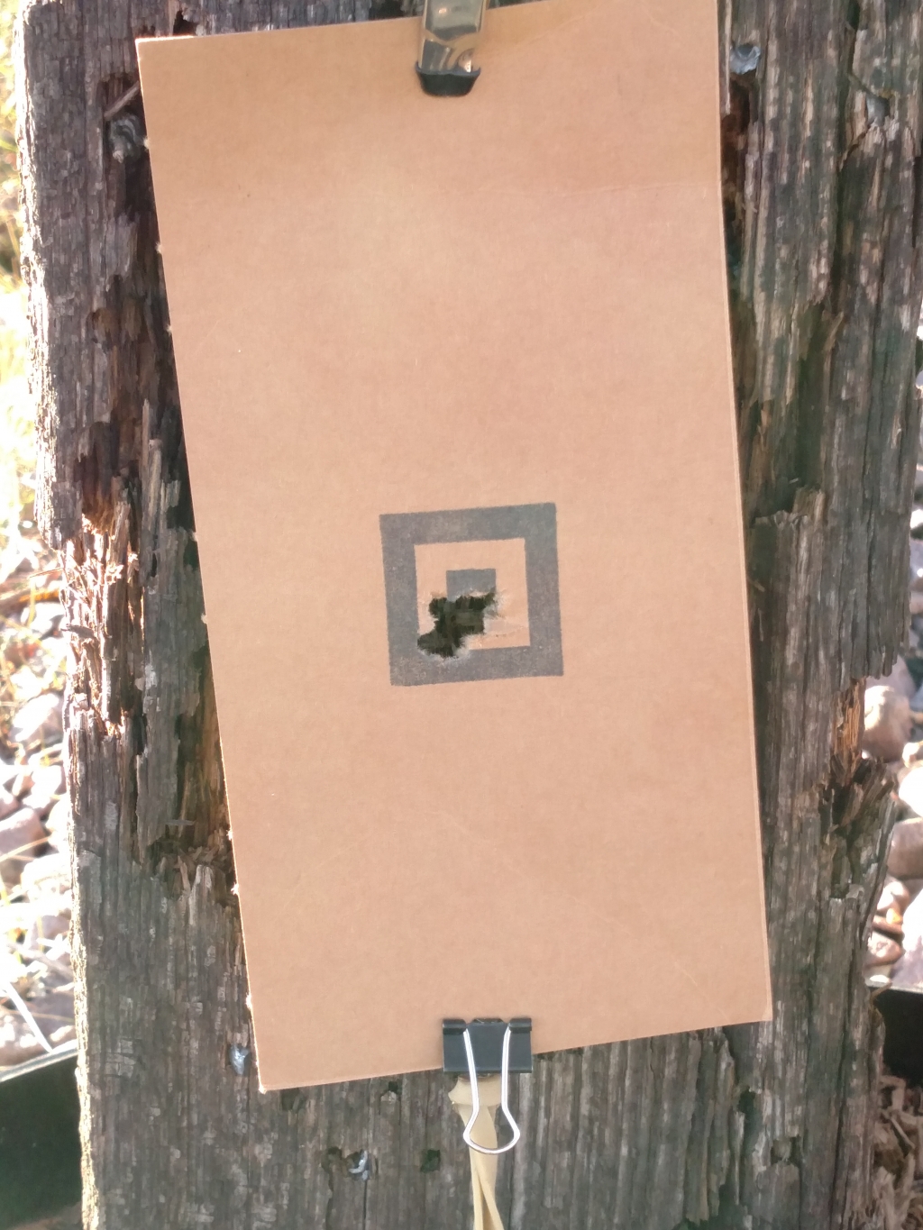

123 yards aiming at the gray sky above the target. JSB king heavy MKII. Approximately 900 fps.

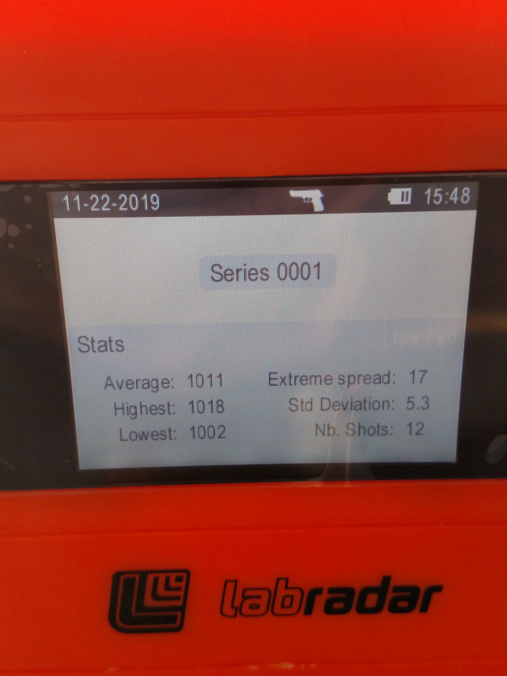

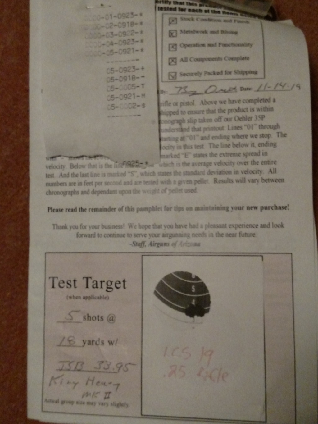

I had to cut firewood today(that buys a lot of pellets) but snuck in 12 shots over the labradar. It was around 32 degrees outside.It showed almost 100fps more than the test note that came with the rifle. Over 200 shots ,so maybe it has settled in a bit? JSB King Heavy MkII, same pellets as the test note. Regulator gauge showed no creep and I ran about 10 seconds between shots.
Test note that came with the rifle.
I am besides myself with the accuracy at 40 yards. Factory settings as I received the rifle :)
far_shot - Thanks for the quick shot string. That's a real out of the box new gun string, for sure.
Wait until you've got time to make a few adjustments and it gets broke in..... Oh yeah.
Shooting a 34gr. at 1000+ FPS........out of the box. That's awesome.
