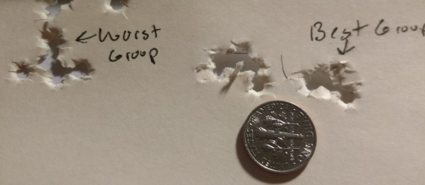

I've reprogrammed my .22 RW High Power (HP) several times in the last two weeks. JSB Jumbo Monsters (redesigned) were going downrange at 933 FPS with factory settings, while the Jumbo Beasts were averaging 816.3 FPS. As of this morning Monsters and Beasts are running averages of 970 FPS and 856 FPS respectively.

The range was experiencing a quartering headwind from the right varying from 15 to 20 MPH this morning. Thus, the best ten shot group I could get with Monsters was .278 inches (7.06 mm) C.T.C. at 25 yards.

A picture of three Jumbo Monster groups shot in heavy winds today is shown at the end of this post (since there is no credible proof without a target, or so I’m told).
@other_mark_b
I've done loads of testing & found the optimum velocity vs shot count vs accuracy for the redesigns to be 940fps. 250b-180b for 45 shots.
I found that increasing the velocity beyond that resulted in: lower shot count, higher ES, severe barrel fouling, & decreased accuracy.
Just my $.02

Great news and thank you!!
I need to first lock in shot count at the current settings as well as group sizes so I can make a sound comparison. My poor methodology so far has been to focus on velocity and group size only. Duh. Shot count is important to a balanced velocity tune.
On a more positive note I know almost exactly the programming value needed to drop my RW velocity to 950 FPS so 940 should require only a little experimentation. Fortunately, I've been incrementing the pulse length value by 100 each time I make a change and that has kept the process manageable and comfortable for me. .
I'll share the data I come up with.
