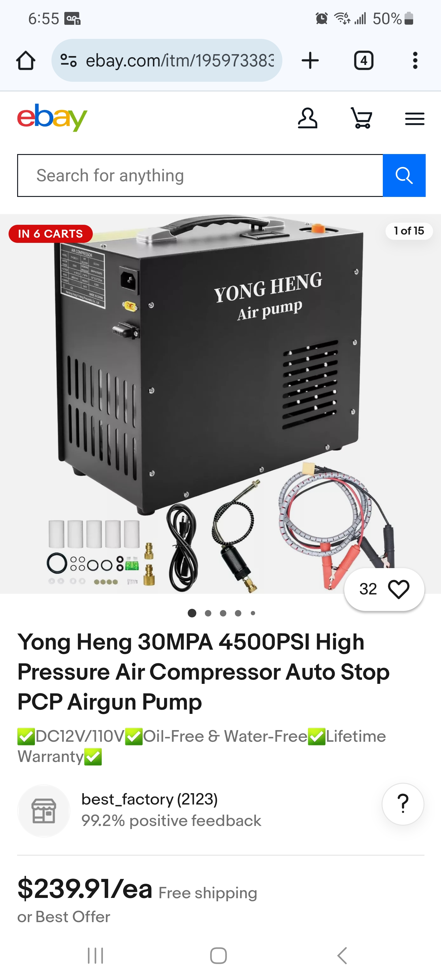

Lastest verison of the yong heng compressor. Anyone try it?

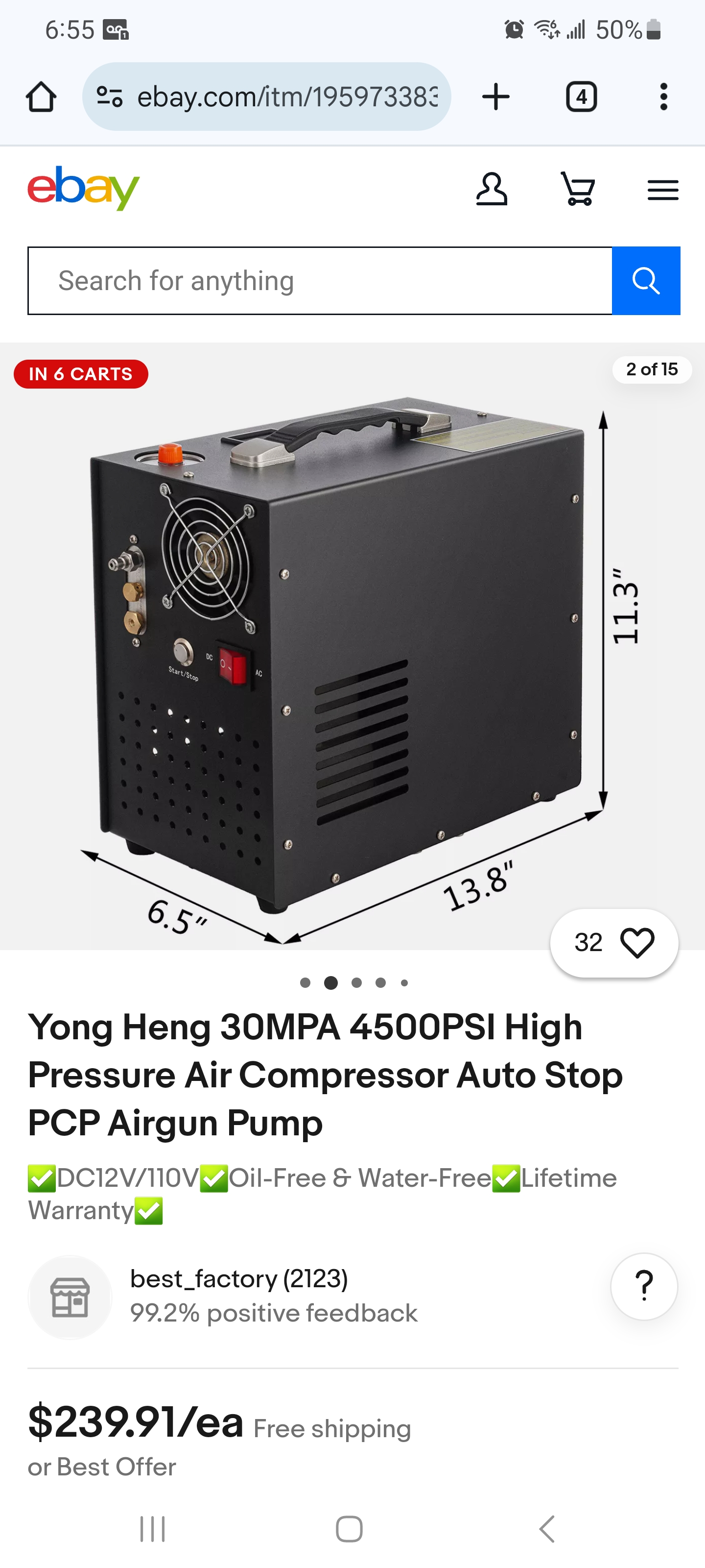

Ok so I run into this yong heng while looking for a compressor. It is not the water bucket yong heng everyone is used to. This one looks like a clone of the gx cs4 without the water cooling. Looks like a desktop computer. I can not find any reviews on this new compressor. I am guessing it's new? Anyone use one and know if it's good? It's 1/2 the price of the gx cs4.
This has been around, just a re-badged oil-less, water-less, multi-power, high-speed-fan cooled compressor with a 12-18 month lifespan and little rebuilding success. Might be made by YongyIheng Pneumatic Company, makers of authentic Yong Hengs, more likely a scammer added white lettering on side to bamboozle consumers. The "water-bucket" Yong Heng owes its longevity to water, fan and crankcase oil cooling, this platform only uses a high-speed fan. Heat kills compressors so be warned. WM

Since it only rated to 4500 psi and is not water cooled, it's more than likely a clone or knock-off of a CS-3 or CS-3i. Comparing it to a CS-3i, that's not a bad price, but I would be concerned about durability and length of service. GX Pumps has gotten a very good reputation for the durability of their compressors and their customer service!

Yeah looks similar. Probably same internals since most of these Chinese made compressor are made from same factory and rebrand under different names. But for $240 and free shipping it's hard to beat. Wonder if it's actually made by the same yong heng company that makes the blue case compressor that use water bucket. That one many ppl have good success with it over the years.

Success for the GX-CS Series lies in low gearing with subsequent less heat generation. While the GX-CS platform will take longer to fill than the featured compressor, there's a serious price to pay in longevity. Even if made by the same manufacturer of the "water-bucket" Yong Heng, this platform is completely different and has a limited lifetime. WM
