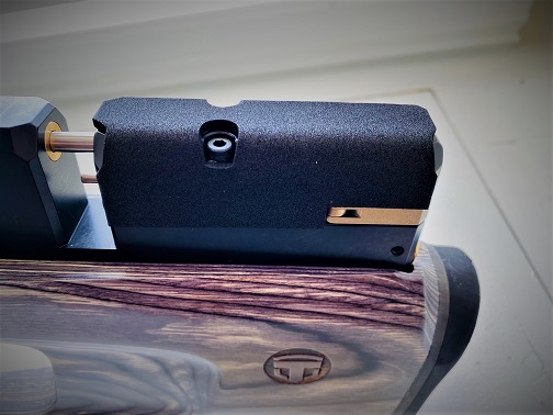

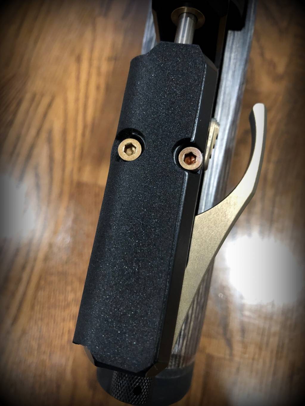

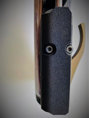

1) When the pad is removed from the backing, some adhesive "flashing" remains because the laser does not cut through the glue. I recommend lightly tracing around the pad with a razor to minimize the flashing. The adhesive backing is ultra-thin and is clear. The tiny amount left can be rolled back for an invisible edge.
2) Align the pad starting with the cocking lever side of the action, using the button head screw as an index. Lightly place the pad into desired position, ensuring accurate placement while maintaining straight edges. BE CAREFUL not apply a lot of pressure during this phase as the adhesive is very strong.
3) When applying the pad, try to avoid over-stretching the material. It's very elastic but you want to avoid creating a lot of internal stress/tension. This ensures the longest-lasting bond (and it's a good one!)
Photos depict 3.18mm pad
