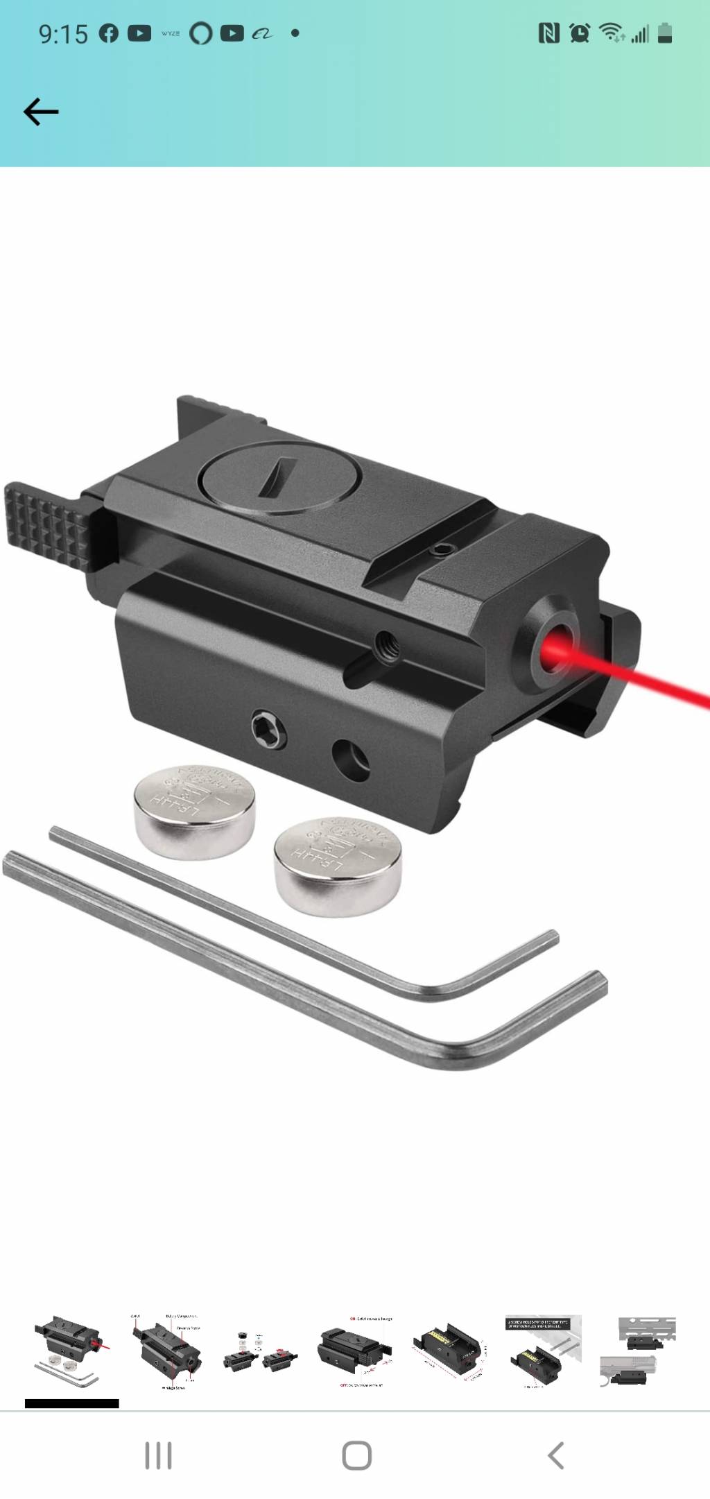

I mount at least one of these cheap things to all my guns because I change scopes sometimes 3 and 4 times a single sitting 😅.
I aim the dot at my zero or reference to it at my shooting distance just before I go to the next scope. I then aim my next scope zero at the same dot at the same distance.
Using the lazer red dot on a new gun and scope makes it easier to find your zero as you have a reference point for your zero it also let's you know if you moved the turrets in the right direction or not.
1f605.svg
Allen
This is great idea. I’ve been swapping scopes around a lot on my air guns. Thanks for the tip
