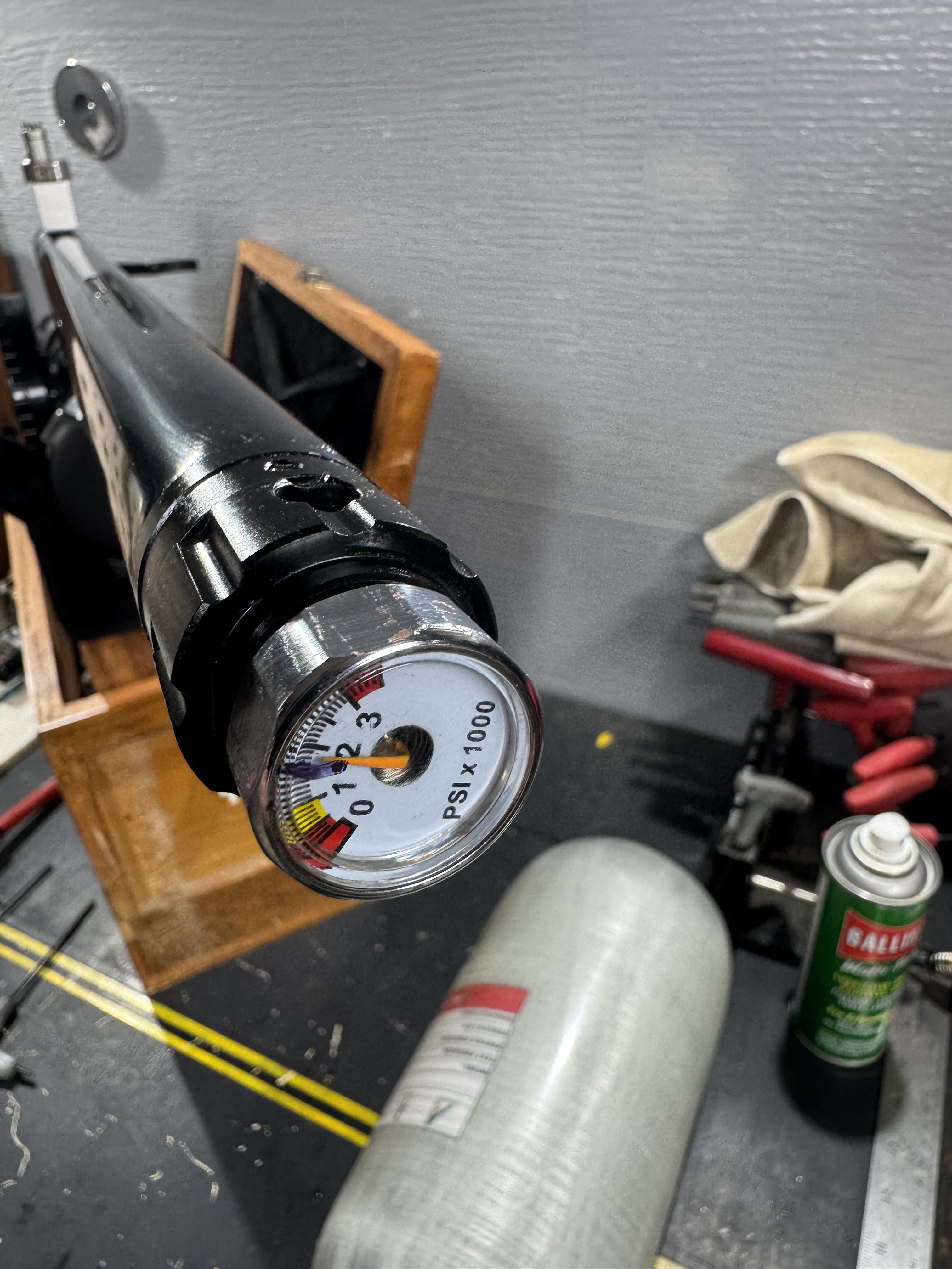

I have noticed over the last few months that my Air Arms HFT 500 leaks sorta.
The air tube is a 300cc tube from air Venturi and I have a Lane regulator inside the tube. So the gauge on the bottom of the gun only reads regulator pressure. On the front of the tube the Air Arms Fill adapter has been replaced with a Lane fill probe and gauge.
If I fill the gun to 3000 psi it will leak down to 2800 and hold that pressure for weeks. Until last week. It would suddenly lose Al lot of pressure mysteriously.

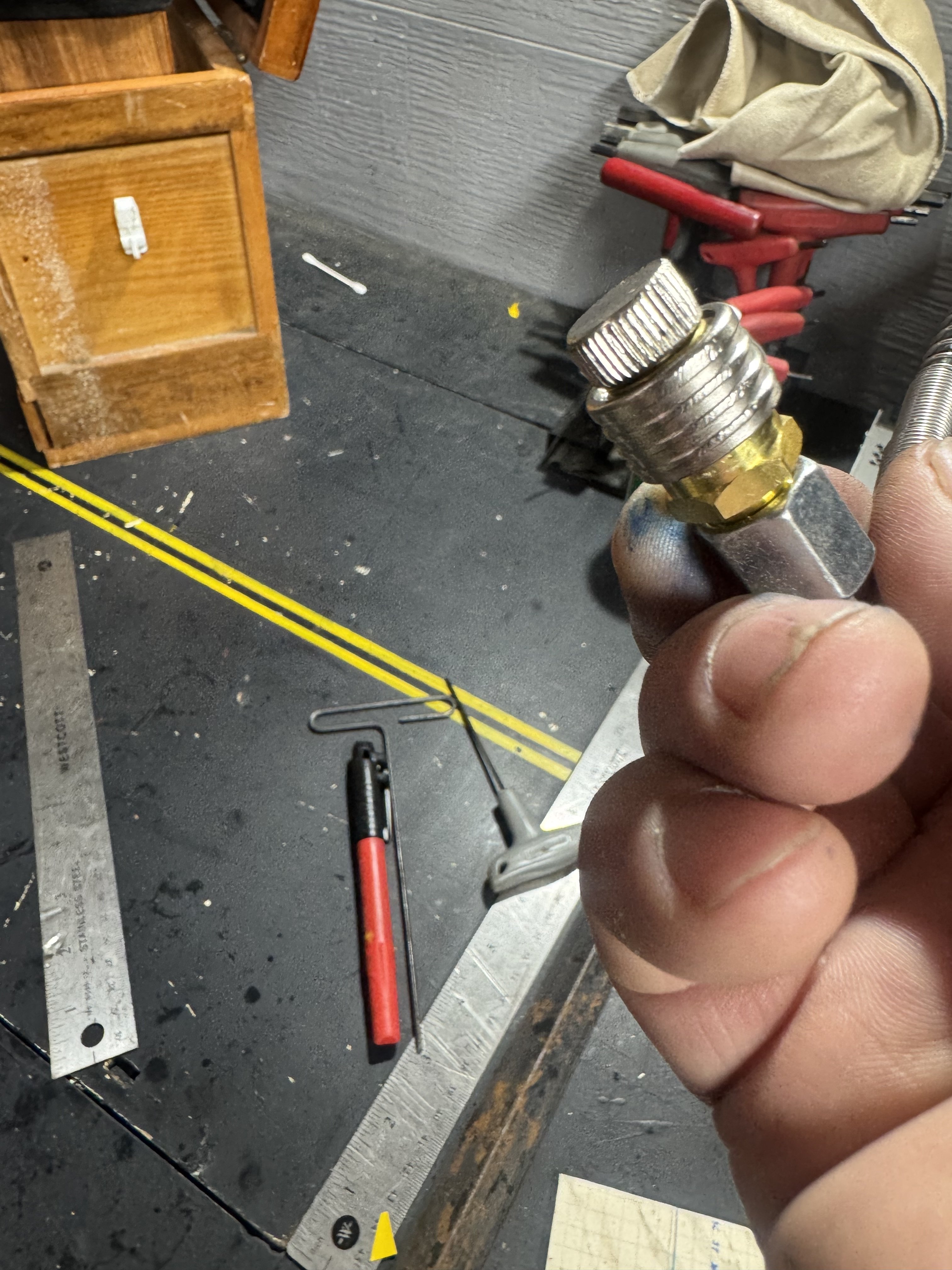

The leak is from the inside the fill probe.

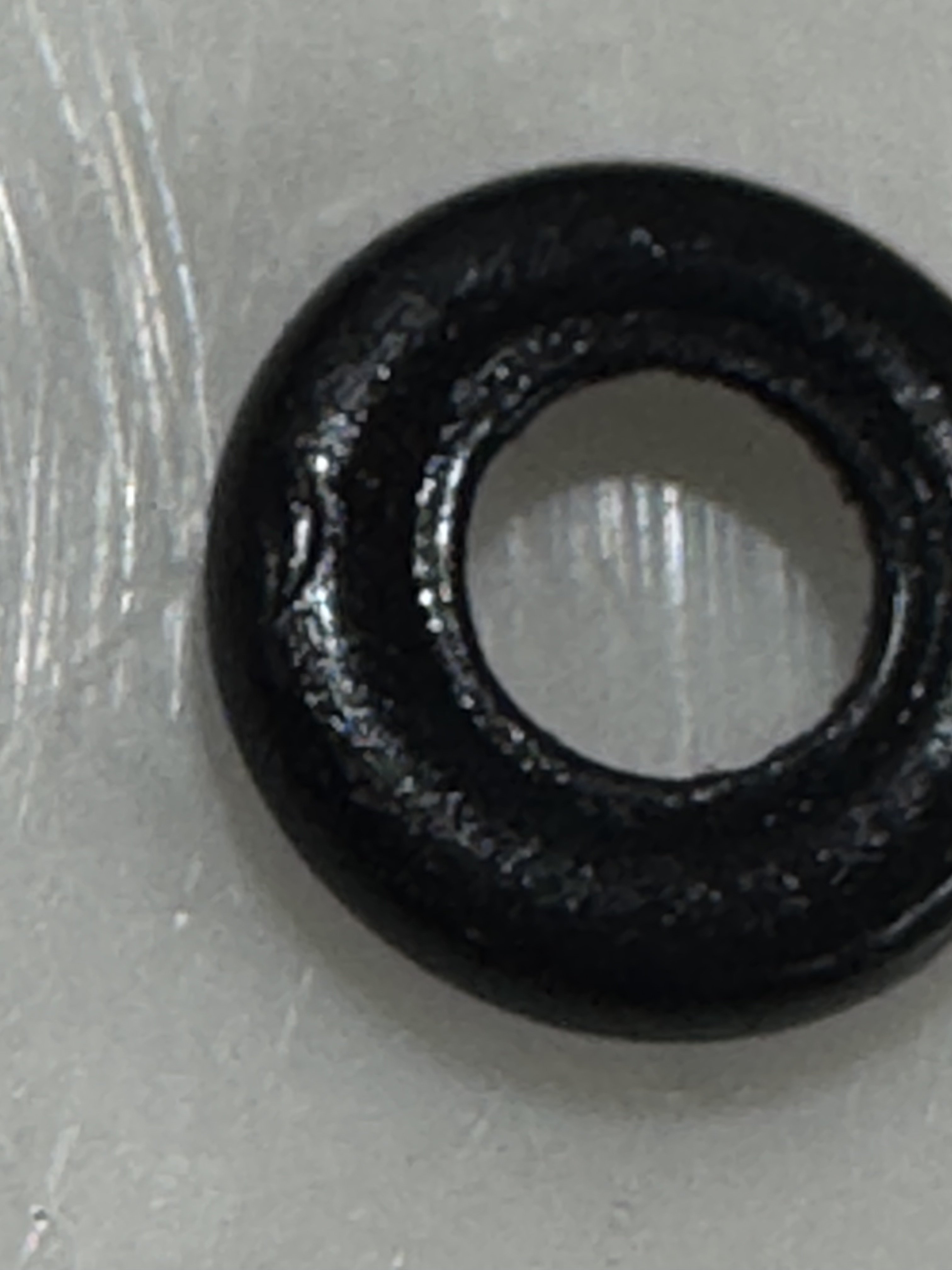

I pulled the fill probe and found some crap. But the O ring has a tiny divot from the hole in the metal that allows air to pass. Somehow the O ring turned and it leaks. And after looking at it it leaked bad. I can’t use the original fill because I can’t see the pressure.
I fortunately found a 9x2mm O ring with a 4mm center. It is fractions of a millimeter larger than the original. But it worked. I tried a couple others and they did not.

The O ring is distorted. But in metric it is OD 9mm Width 2mm inside 5mm.
In fractional size its OD is 5/16 width is 1/16 and inside is 3/16.
Fractions its OD.350 width .075 and ID is .175.
I found a couple that are very close and a box of fifty for five dollars. Shipping is 15 bucks so I might as well order a couple different sizes. I’m not sure about the hardness number.

After looking at the different options I decided to replace the whole fill probe gauge adapter.
Kind of an over kill approach . But I gotta fix it. And the next comp is in a month.
I hooked up the hose to my compressor and after an hour it put a 1000 psi into the compressor gauge. Definitely leaking from the fill probe. So I put a plug in the hose and I’ll just store it like that till I get new parts.

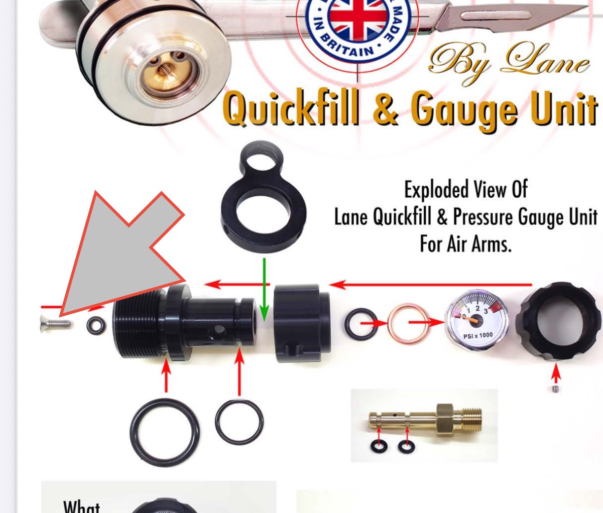

I spent some time looking at how this seal system seems to work. There are two holes in fill probe body. One small port on the edge that goes from the tank to the gauge. The other is a central hole that is tapped and goes from the fill port to the tank. A tapered screw is threaded into the center and compresses an O ring between the taper of the screw and the body of the gauge block. Air travels up a slot cut into the screw and can push the o ring out . But when there is pressure in the tank the o ring gets squeezed and seals.

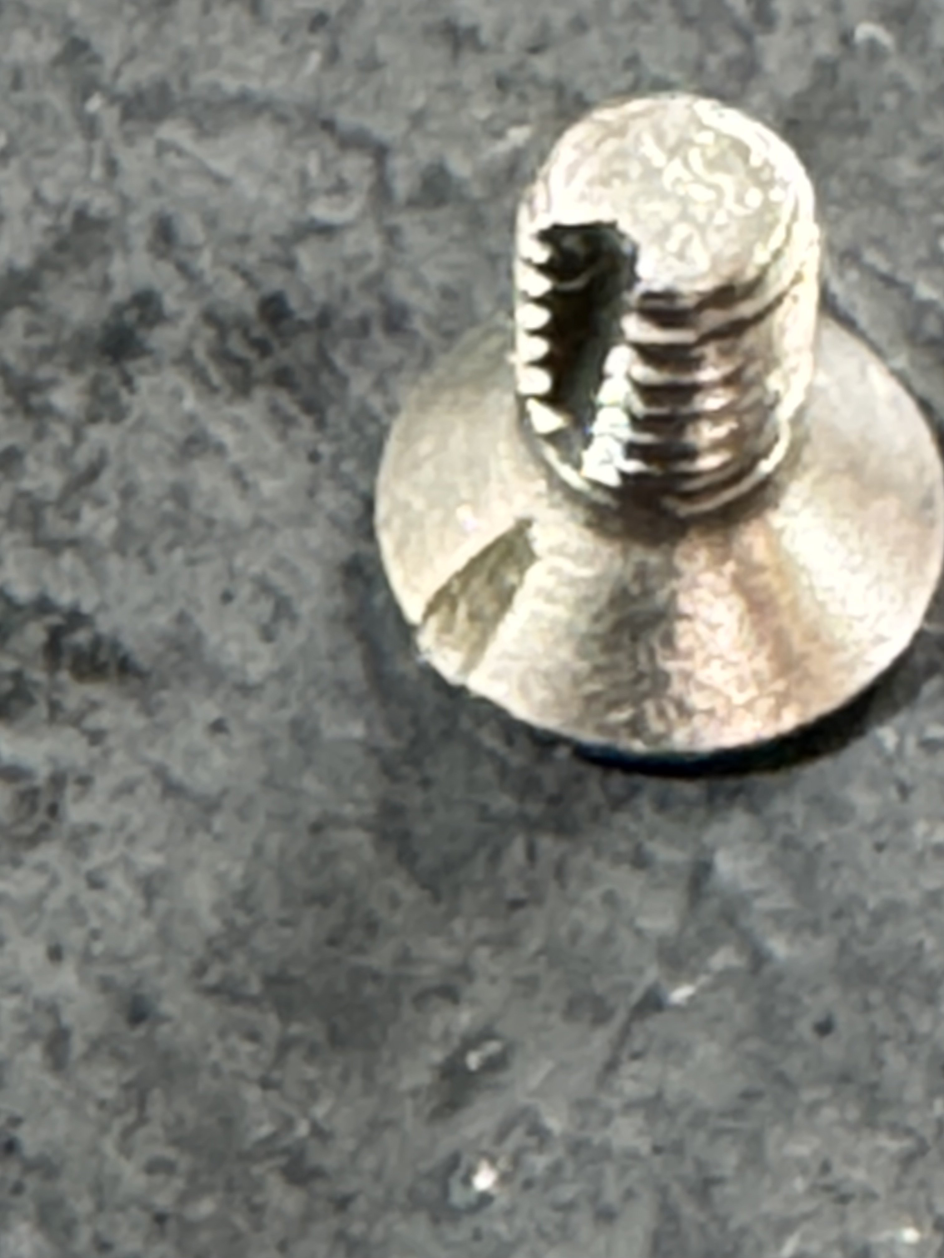

Unless there is a cut into the screw !
I found this scratch from when they cut the slot for the air.
I rebuilt it all with a new screw. I cut the slot with a diamond burr.
24 hours and the rifle is holding 2800 psi. Exactly like it was yesterday. I can’t believe it!!!
