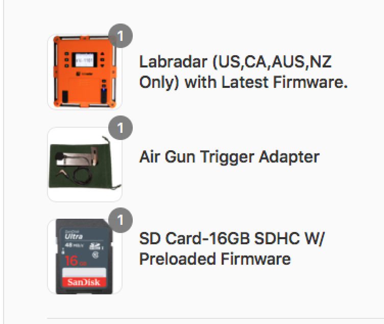

After weeks of debating I bit the bullet and bought a Labradar Chrony, along with the microphone trigger and SD Card.

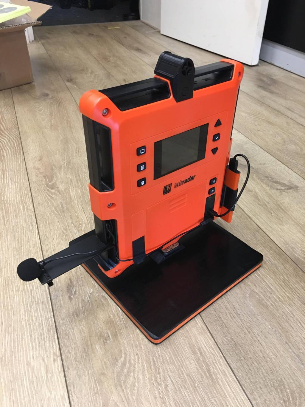

Good for you! Now here's what you wanna do with the airgun trigger adapter:
Get a black spraypaint can and do like the Rolling Stones! (I used the rubbery paint, but any black is ok)
This will transform the airgun trigger from an afterthought to a well thought out and seemingly belonging accessory!
The other things you want to do (as shown in the picture above) is get a powerbank (I put some orange vinyl on it, again to color match), get (3D print) the aiming thingy on top, (gogle Labradar on Thingiverse) and...this one will hurt when you do it, but you;ll thank me afterwards:
Cut (use a punchtool and/or Xacto) holes for the mic and the powerbank in the rubber flaps that are supopsed to be covering the ports when not in use. Because after a while of use the flaps wil not stay straight anymore and they will not lock anymore either to cover the holes.
When the through holes for the powerbank and mic are done just use some hotglue or double sided tape to fix the flaps permanently in postion and stick the connectors through.
Also no need to buy the crazy expensive baseplate Labradar offers, The one in the picture is a cheap bamboo cutting board(!) sawcut to size and with some cheap photo tripod adapters (Ali/Amazon) to fix the Labradar to Bob's your uncle!
