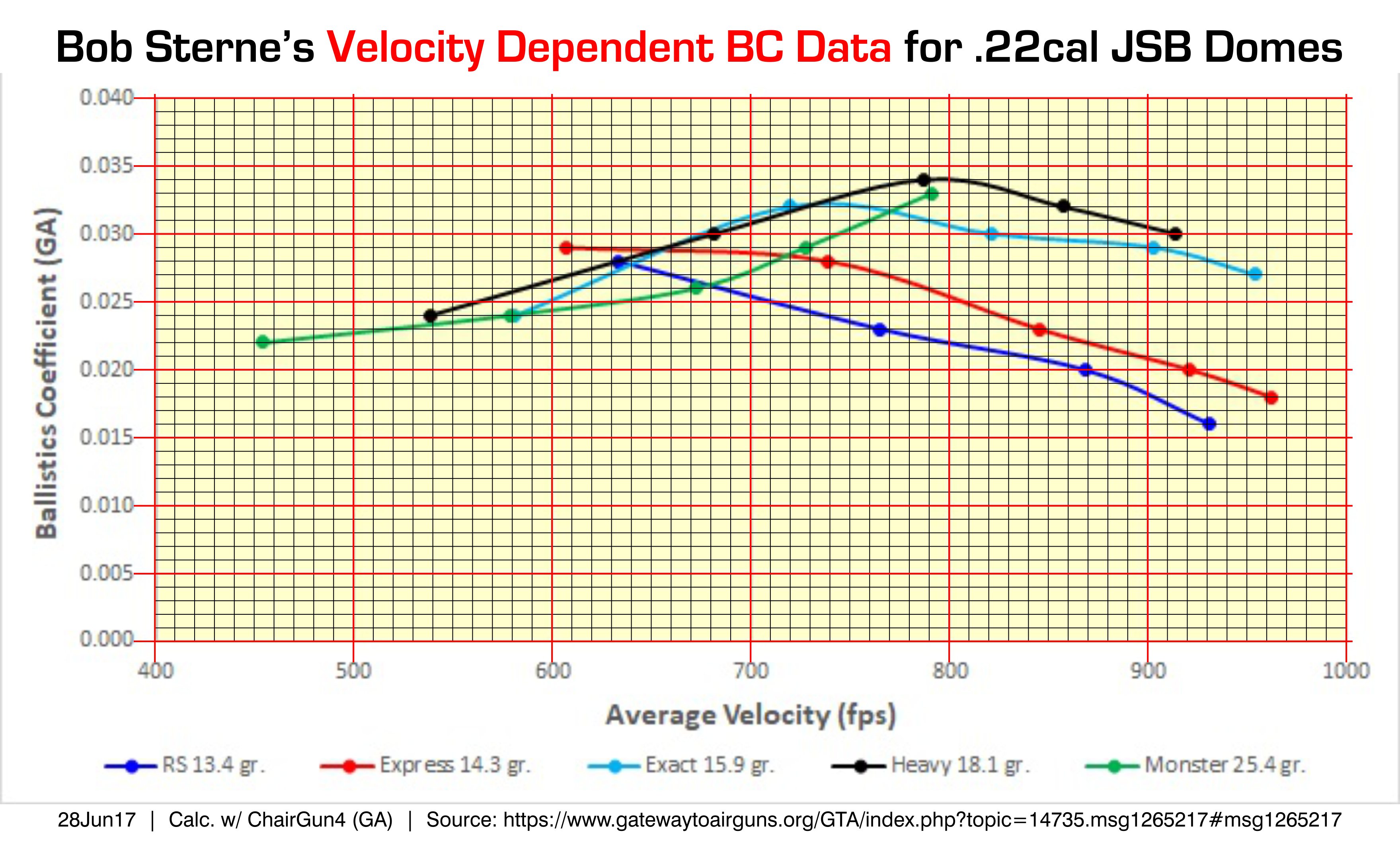

Except that BC varies widely from book values.

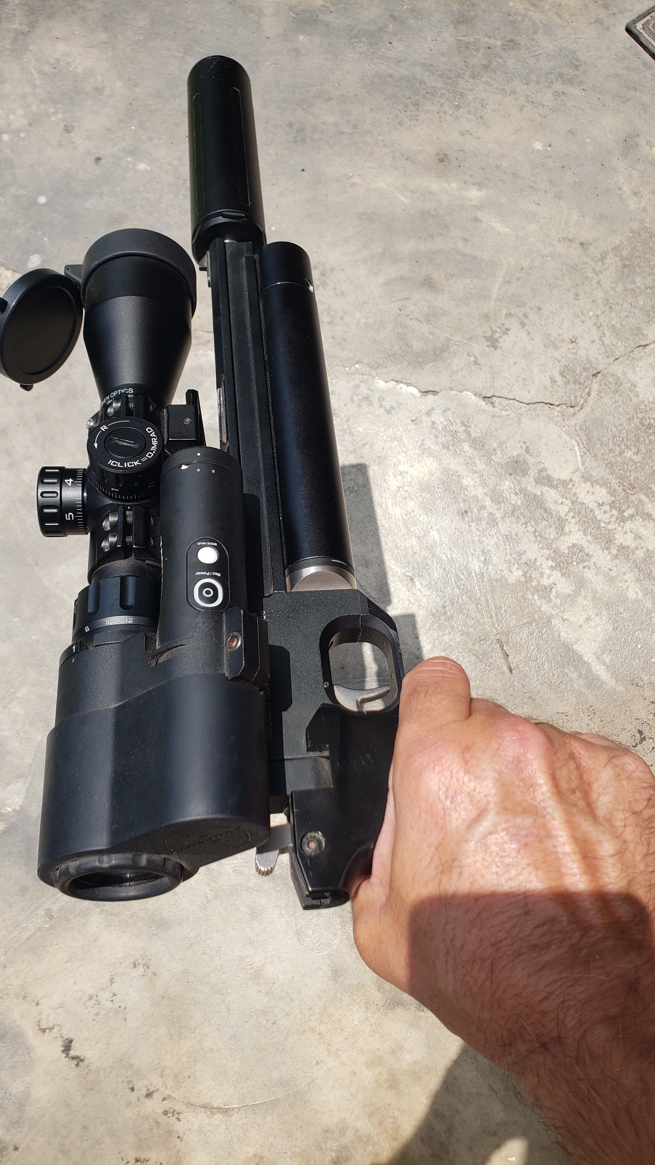

LabRadar is bulky, needs to be aimed perfectly, and requires an inertial trigger for centerfire and microphone trigger for airgun to work reliably. It eats batteries and really needs the external battery pack. You do need to select a range (archery/handgun/rifle) but that’s pretty easy. It gives downrange velocity that is quite valuable to airgunners. Bluetooth is lovely but not dead reliable.

The Bulletseeker requires the least knowledge but I have found it needs to be aimed properly and seems to like certain positions relative to the muzzle. Still learning it but the sensitivity might be related to atmospheric conditions and how much disturbance appears at the muzzle. Also the Bulletseeker seems to read velocity several feet ahead, and looking at the raw data I think it could improve its velocity calculation method. Bluetooth is pretty reliable but not perfect. Bulletseeker is configured to mount directly to the gun but I run mine mounted to a flexible mini tripod. As I understand it, Labradar back calculates a V0 using the velocity trace.

The Bulletseeker requires the least knowledge but I have found it needs to be aimed properly and seems to like certain positions relative to the muzzle. Still learning it but the sensitivity might be related to atmospheric conditions and how much disturbance appears at the muzzle. Also the Bulletseeker seems to read velocity several feet ahead, and looking at the raw data I think it could improve its velocity calculation method. Bulletseeker is configured to mount directly to the gun but I run mine mounted to a flexible mini tripod. As I understand it, Labradar backcalculates a V0 using the velocity trace.

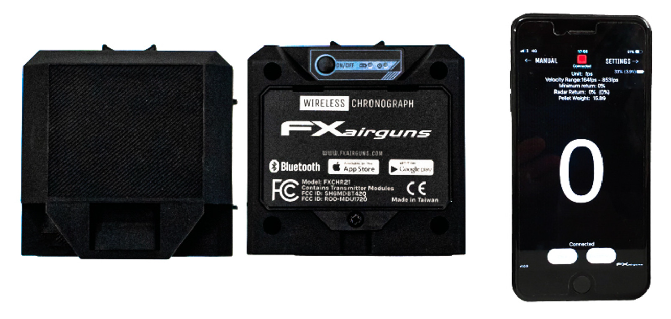

I love my FX Chrony. It is far from "fiddly". It literally works every time I pull the trigger. The 3 Amazon AAA batteries last 6 hours + of constant use, it weighs 4.72 oz with the batteries, you can keep it on your gun all the time, I can use it on my bow and my blow gun as well. What's not to like? it's perfect.
