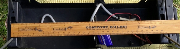

The measure of default 12 inches between Chrony sensors was checked as best I could - see pic: ( if you have never checked yours, it is a good idea to do so).

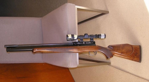

The rifle was my 16 yr old .22 Excalibre/FX 2000, which has no regulator but has shot over 70 sub inch 100 yd 5 shot groups, .
It was choked back with its transfer port adjustment screw to shoot under 12 fpe, with 15.9 gr JSBs , allowing just enough noise to trigger the LR microphone.
1525748141_8418424535af111adcb0869.94298684_Excalibre upright_zpsh9j9pw1s.jpg

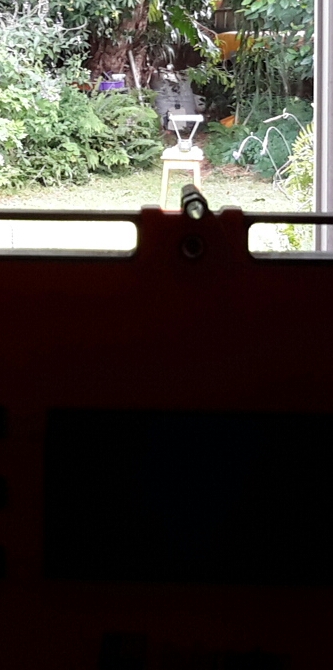

Harry's comment of "iit never misses a shot on any range reasonably clear of gates fences etc" contains an important point. It likes to have a relatively clear path from gun to target. If you are shooting down a outside corridor that has trees within several feet of the trajectory and ground cover (bushes, ivy, small objects like 2 foot stumps every 10 yards with targets on them) results are mixed. Don't expect it to track indoors in a example configuration of 'shooting from dining room though kitchen into target in family room'. Stick to traditional crony's for that stuff.
"Strever"Harry
what is the sighting device you are using on top of the lab radar ?
thanks
Strever,
I do things on the cheap too sometimes !
I think it was Scott Fitzgerald who once commented that using an exclamation mark is like laughing at your own joke - but forgive me please as - I think there is something funny about using a ball point pen tube as a sight for an expensive LB. It fits neatly in the LB's frame "V" sighting notch.
