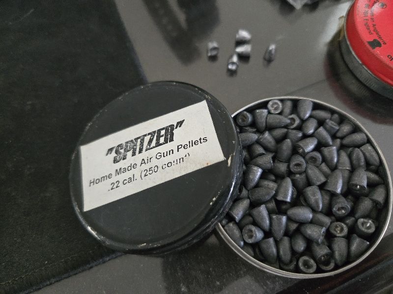

A fellow airgunner was kind enough to gift me a L-E-M mould in .22. I finally figured out where a tin of slugs came from after laying around for 20 years.
I cast a few myself, and they are in the 20 - 22gr. range.
As for the dimensions, they range from .217 - .223 as cast.
Decided to size a few samples from the tin in .2173, and distribute to a few of my customers.
This is by far the most difficult mould to work with, as there is no sprue cut-off.
Need to be tested in a PCP 22 - 35 FPE range.
