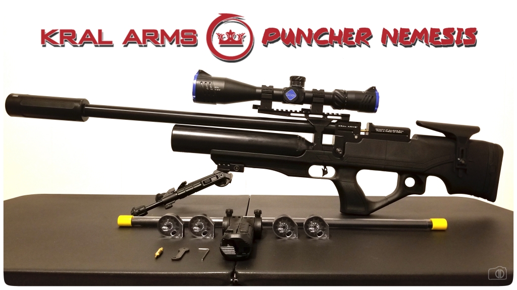

I grabbed a Kral Arms Puncher Nemesis [Before they re-named them to the Night] with the .22 and the .25 caliber bbl setups..
The very first thing that I found out about these rifles is - They come from the factory tuned shooting HOT! Or at least mine did.
I always shoot Crosman Premier .22 cal 14.3 grain Hollow Points through my rifles to get a starting point - and to lead the bbl in..
Nope. The Nemesis/Night wasn't having that. haha I had to lower the power-adjust-wheel all the way down for less FPS.
Then I tried JSB 18 grains and then H&N 21 grains and it shot much Much better!
With light ammo, mine shot high and to the right. With heavier ammo, the groups returned towards center and tightened up..
Granted I only shot a few mags of each pellet type/weight in .22 and only shot indoors at 10 meters, it shot Great!
I agree about the rail to stock / cheek riser ratio.. Scopes sit high on these..
I had to go with some Med. rings that I had kicking around, and they were still too tall. So the cheek piece had to be max'd out.
**Important**
You mentioned that you max'd out your reticle, so I'm assuming you ran out of elevation clicks also.. Same deal here.
Using a Discovery VT-T 6-24x50 scope. Thanks to Hajimoto, this issue has been fixed. [Same w/ several of my rifles]
It is due to them not adding any angle to the rails, so shooting close or far can be an issue..
FX No-Limit adjustable rings were used in my case, and now everything works flawlessly!
X-hairs are dead on, and plenty of adjustment either way now..
Any adjustable mount will work. Shimming the rear will work, or like you said - dropping the front.
Just be very careful not to put too much pressure on your scope's tube - You wouldn't want to end up denting/kinking it.
Best of luck, and definitely keep us posted on your thoughts and progress with this one!
