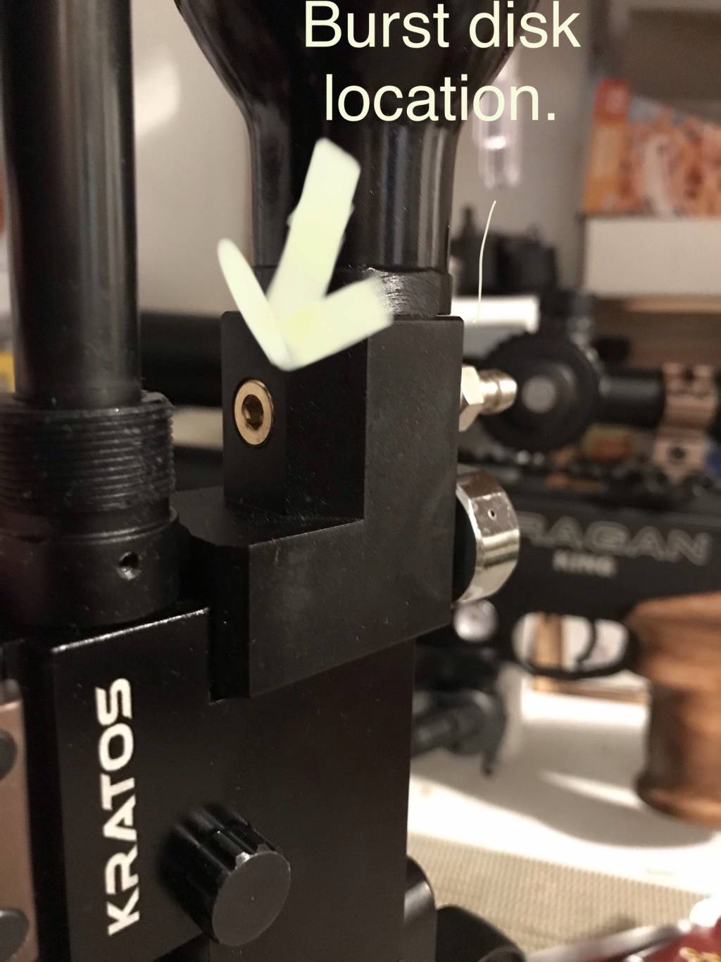

As far as “internals” go, the only part of the rifle that is subject to any added stress from a higher tank fill is the valve assembly (and obviously the tank itself). The burst disk location is shown in the pic above. I’m not sure what the burst disk pressure is designed to rupture at on it, but I have over filled a Cayden a considerable amount (like 4000psi) by mistake and the disk didn’t burst. What DID occur was the tiny o ring on the poppet was unknowingly damaged and after degassing to the 3000 psi mark the Cayden started having a “brraaap” type sound when it was fired as air leaked past the valve stem and the air pressure pushed the hammer part of the way back and the hammer spring would then push it back into the valve stem, causing the whole thing to repeat over and over about 50 times in a second. A very exaggerated hammer bounce situation. Re-sealed with new o-rings and it’s back to normal.
