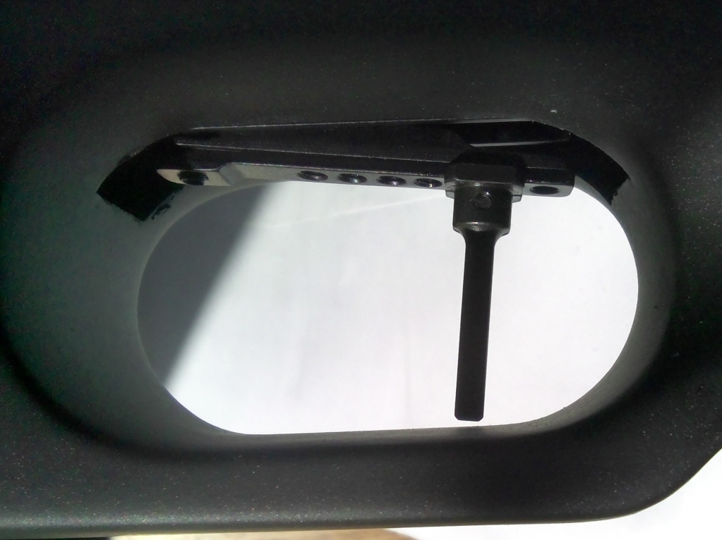

You can change the trigger weight of the boss style trigger, in the top blade there are 4 screw holes and only two are used (to create the second stage trigger feeling). By moving screw around over the 4 holes you can change the weight and feeling because you change the leverage with those.

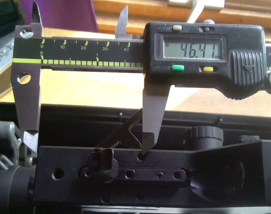

Do you mind measuring where the holes are on your Crown? Assuming it is a Euro model?
Mine:

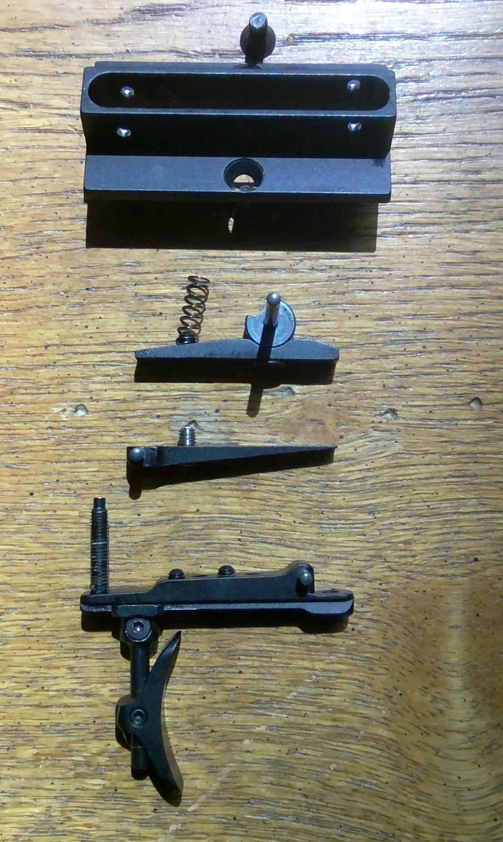

I finally received the correct Boss trigger. One gripe is that it doesn't come with its own spring, so I had to use the original Crown spring. Which may not be detrimental to the final trigger pull. More testing planned...
The original screw used in the bar/wedge is too short to cause the sear to release. I had to replace it with one that is 6mm long. The silver one in the picture.
The safety screw is also too short. I even replaced it with one that is 16mm long (pictured) and this was still unreliable. If you wanted a functioning safety, 17-18mm would probably be needed.
The pull is now lighter and a true two stage trigger. The sear is fully engaged when cocked. Pulling through the 1st stage moves the wedge and starts the disengagement of the sear. The 2nd stage fully releases the sear. There is a fine line between there being a 2nd stage stop or not. This is annoyingly adjusted with the silver screw, which requires removing the trigger bar each time.
So yes, the Boss trigger will fully function in a "US Crown" with minor modifications. Now completely ball bearing free!!!
