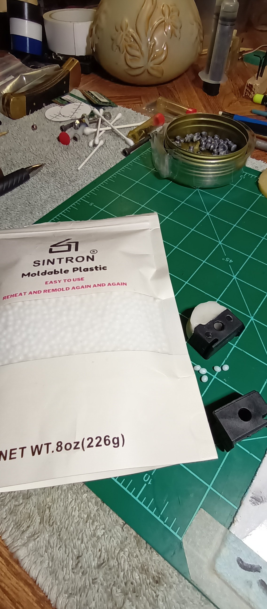

If you've tried using your Kral single shot tray you know it's a pain in the butt. Here's how to fix it.
Thermoplastic beads from Amazon, 8 bucks for 8 oz. Heat them up in water wait till they turn clear and mold them on top of your single shot tray. My XS I can do them right in the gun, my breaker I cannot because there's more holes for the thermoplastic to get into and then you can't get it out. The breaker I did it out of the gun clamped a couple of flat pieces on the tray and put a quarter inch drill shank through so the whole wouldn't fill in. Piece of cake, try it you'll love it.
