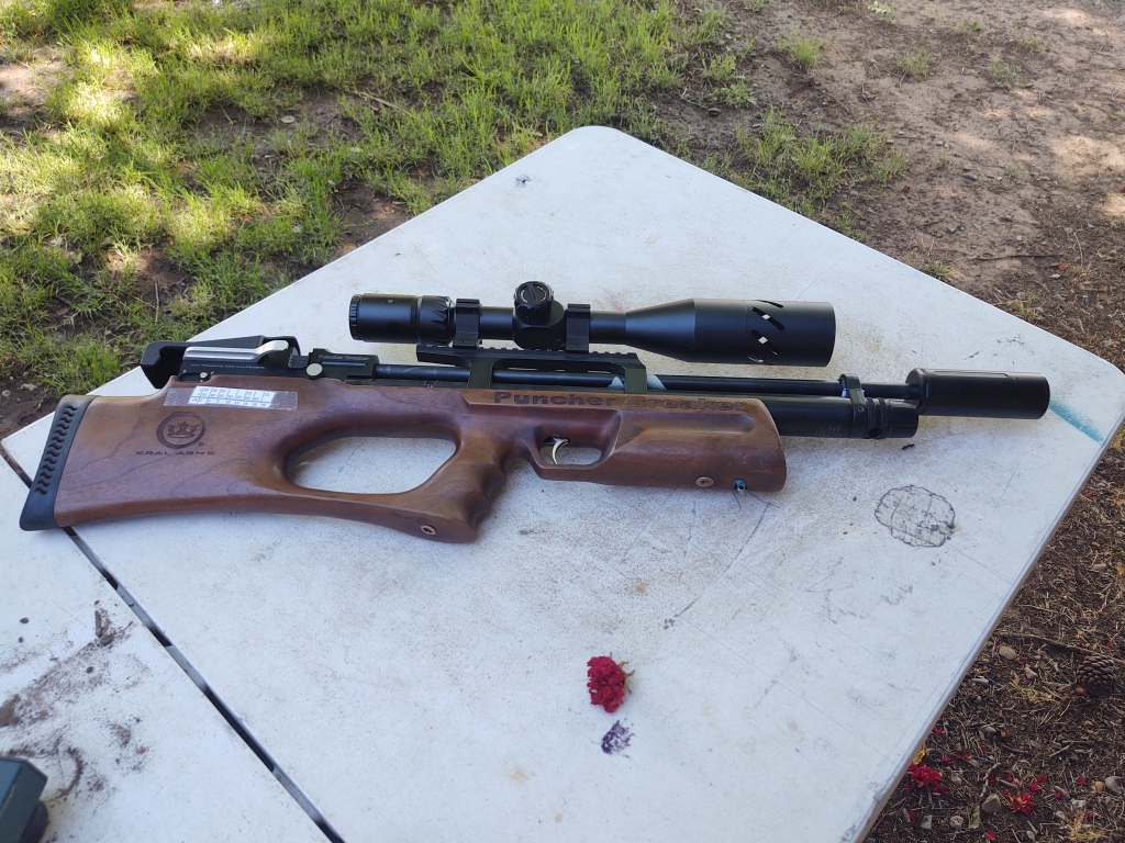

Here is a pic.

I wonder if someone could help me find a new power adjuster pin for the Puncher. I messed mine up when opening up the ports to 4.5mm. Can't seem to find a new one at a reasonable price
My recommendation from that trauma: remove the power adjuster from the action when drilling open the ports. Much better to use a dremel on that adjuster pin, just like on the barrel port!

Good luck toying with your PB ! Please let me know if you come across someone able to help me with that little adjuster. It is giving me grief ...
