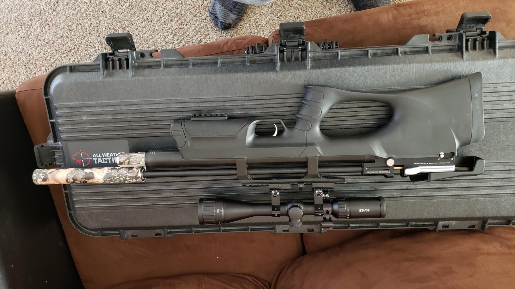

First gen in 22 caliber. I did all my own work. Only issue I had was the cocking lever, so I bought this one from troy. I did the valve work, and drilled the transfer ports to get it to 900 fps wit the 18 gr jsb. Over 3k pellets through it and still going strong. Troy hammer does some amazing work if you dont mid paying.
