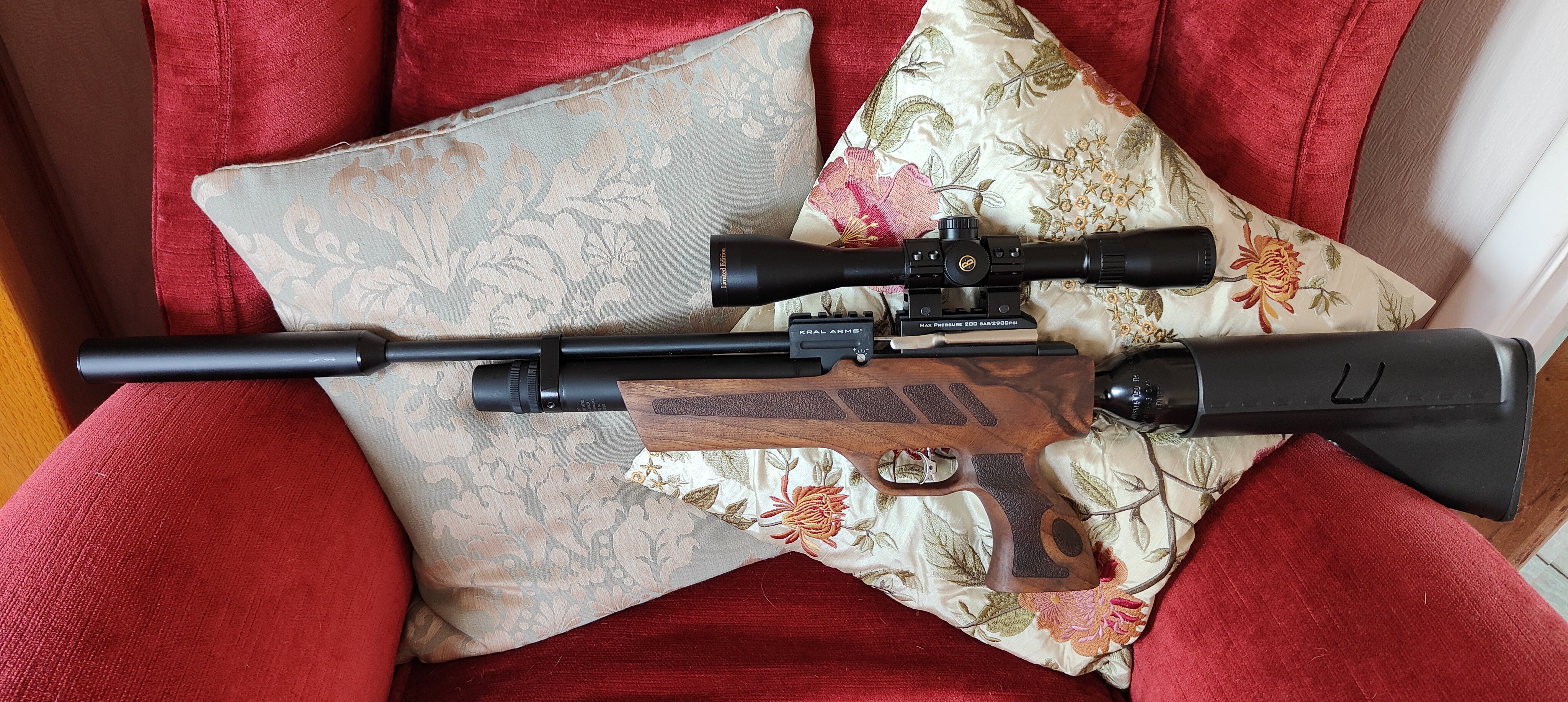

I know that many people find the length of pull on the NP02 very long. I am very short and i have just reduced
mine from 16.5 inches to a little over 15inches. Its made a heck of a difference. Has anybody else done this. How do you find it now? Mine is brand new still trying to find the right pellet in .177. Power in UK 12 ftlbs.

I know that many people find the length of pull on the NP02 very long. I am very short and i have just reducedView attachment 347687 mine from 16.5 inches to a little over 15inches. Its made a heck of a difference. Has anybody else done this. How do you find it now? Mine is brand new still trying to find the right pellet in .177. Power in UK 12 ftlbs.

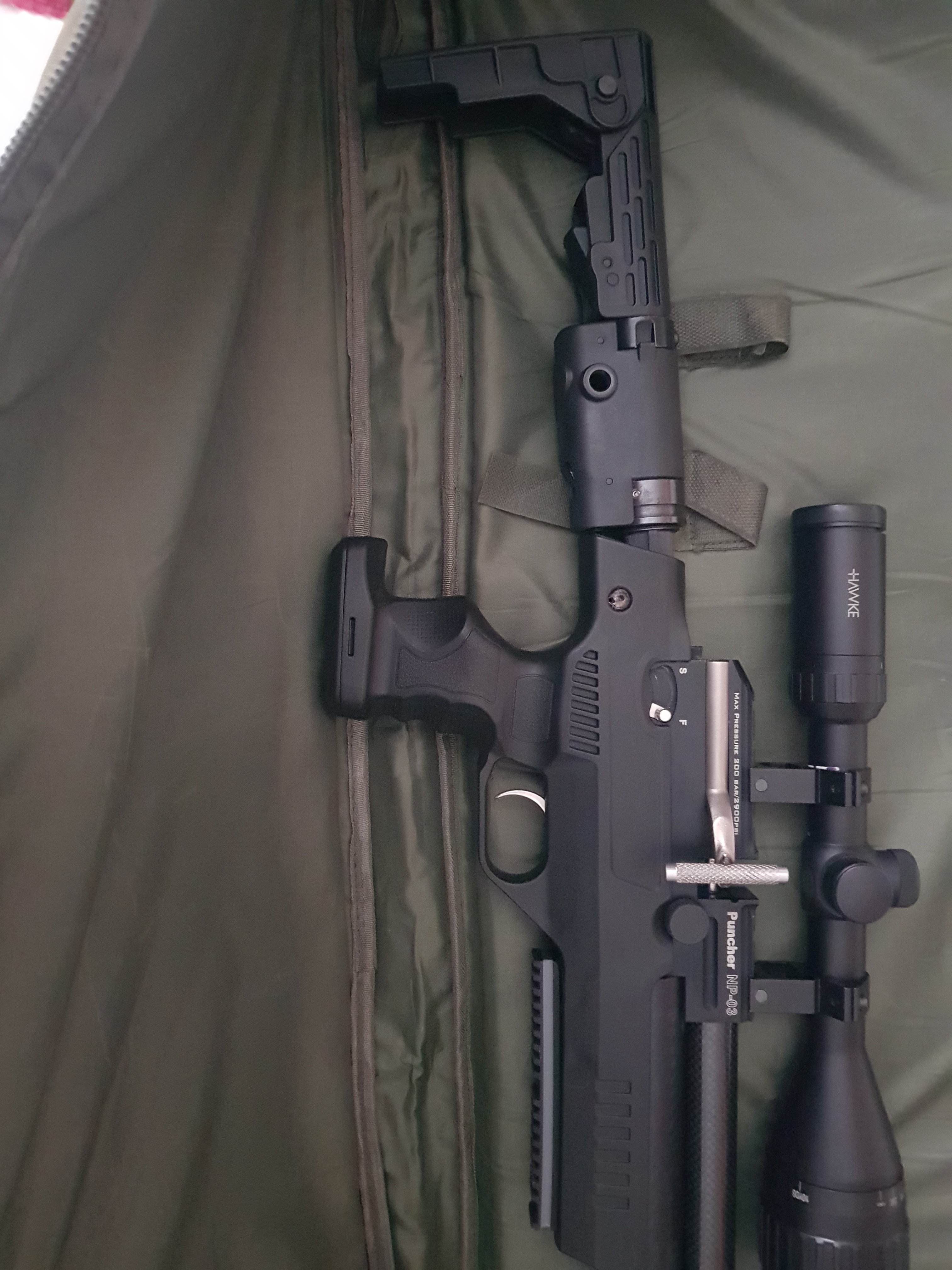

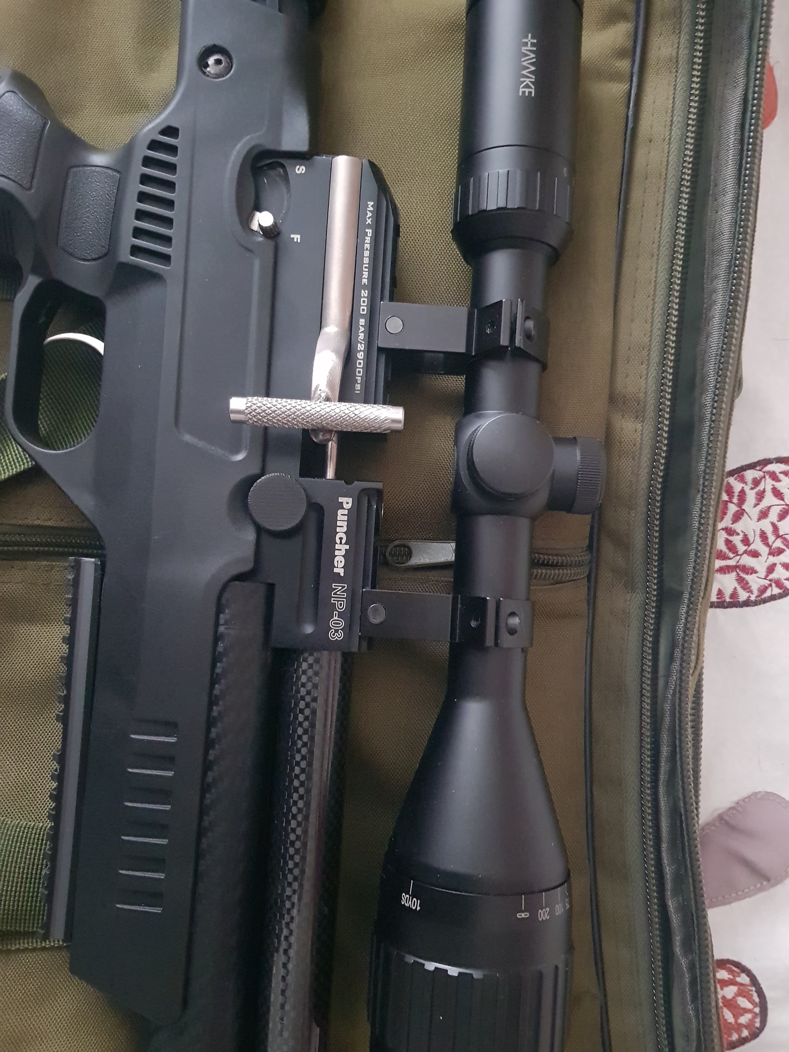

Hi I don't of np02 but here is the same on the 03.
Only difference is on the 02 cut the lever back to clear the magazine.
When you look at it you will see its obvious "why they made it like that is beyond me
My pal loves his np02 his very accurate with most pellets.

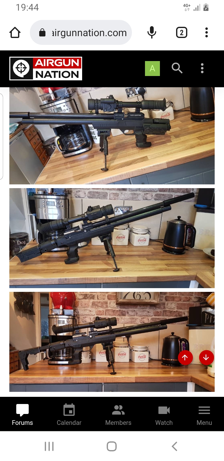

Well if it's a lottery I won first time out with my barrel and I've got a never ending amount of slugs for it.
Even though people say you cant shoot slugs sub 12ftlbs I can put em on top of each other with my kral and this air arns s200 .
Someone said you cant put a bottle on a s200 but here you go spinach
Next time I'm at the range I will take.some footage and pics of this bad barrel in action for you.

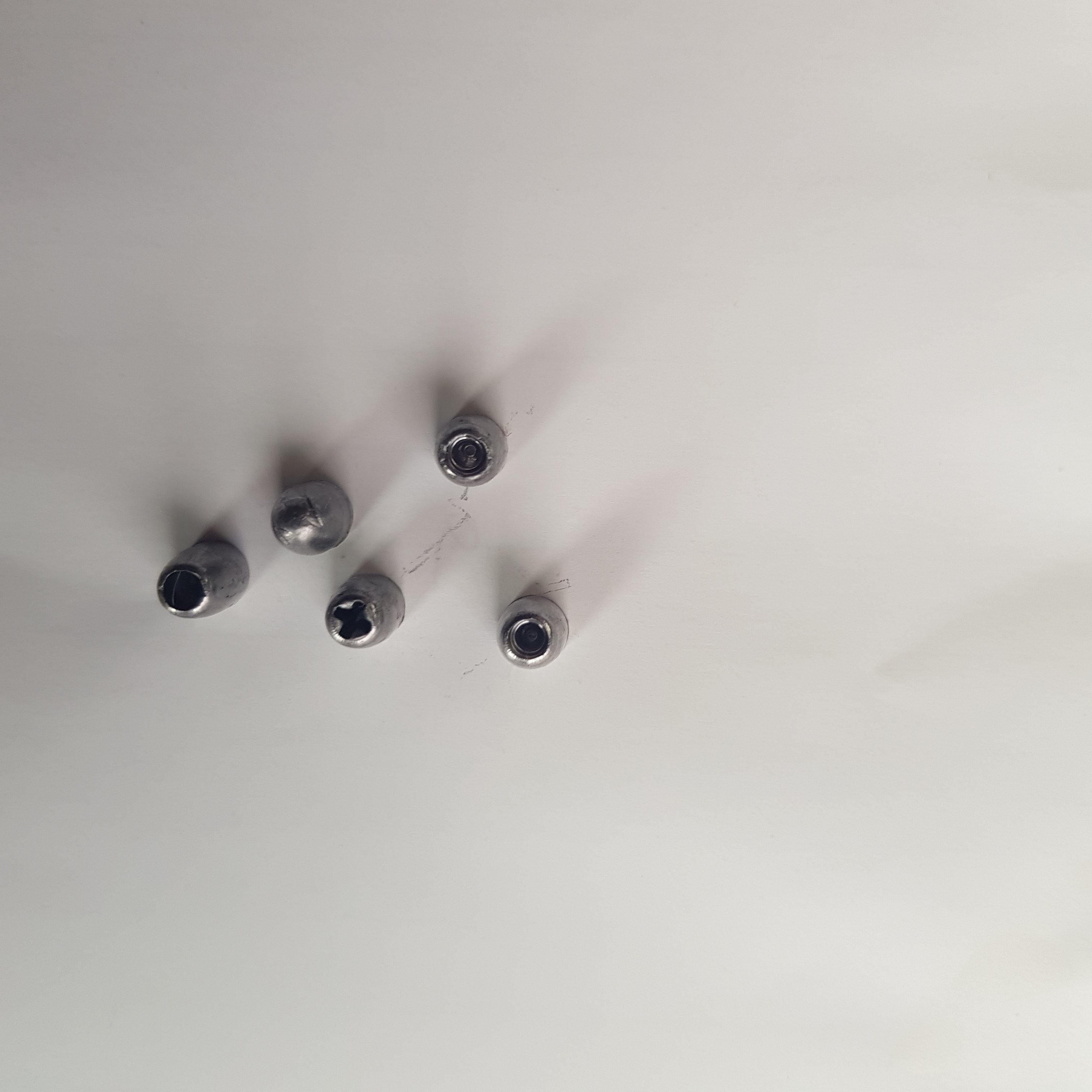

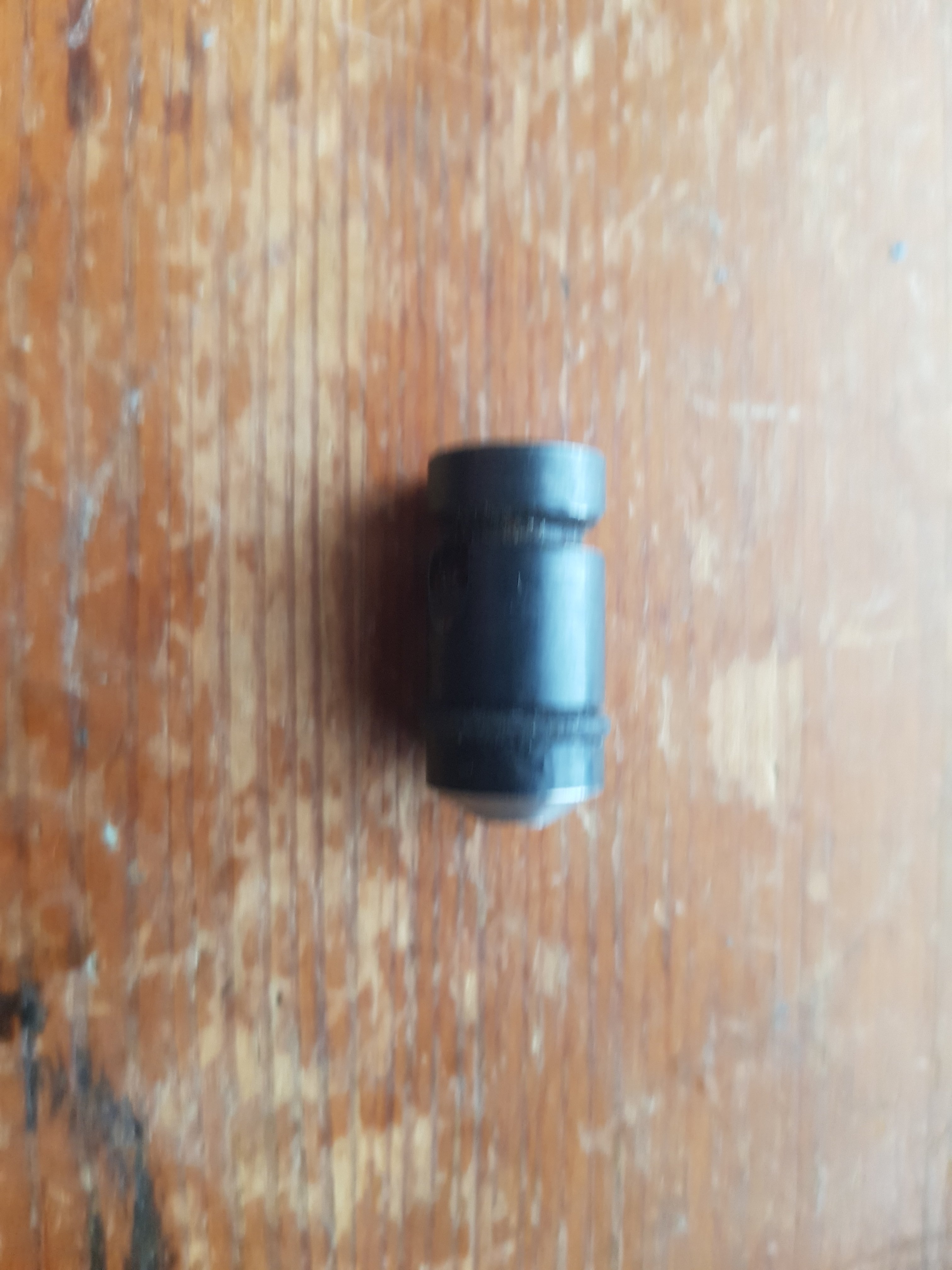

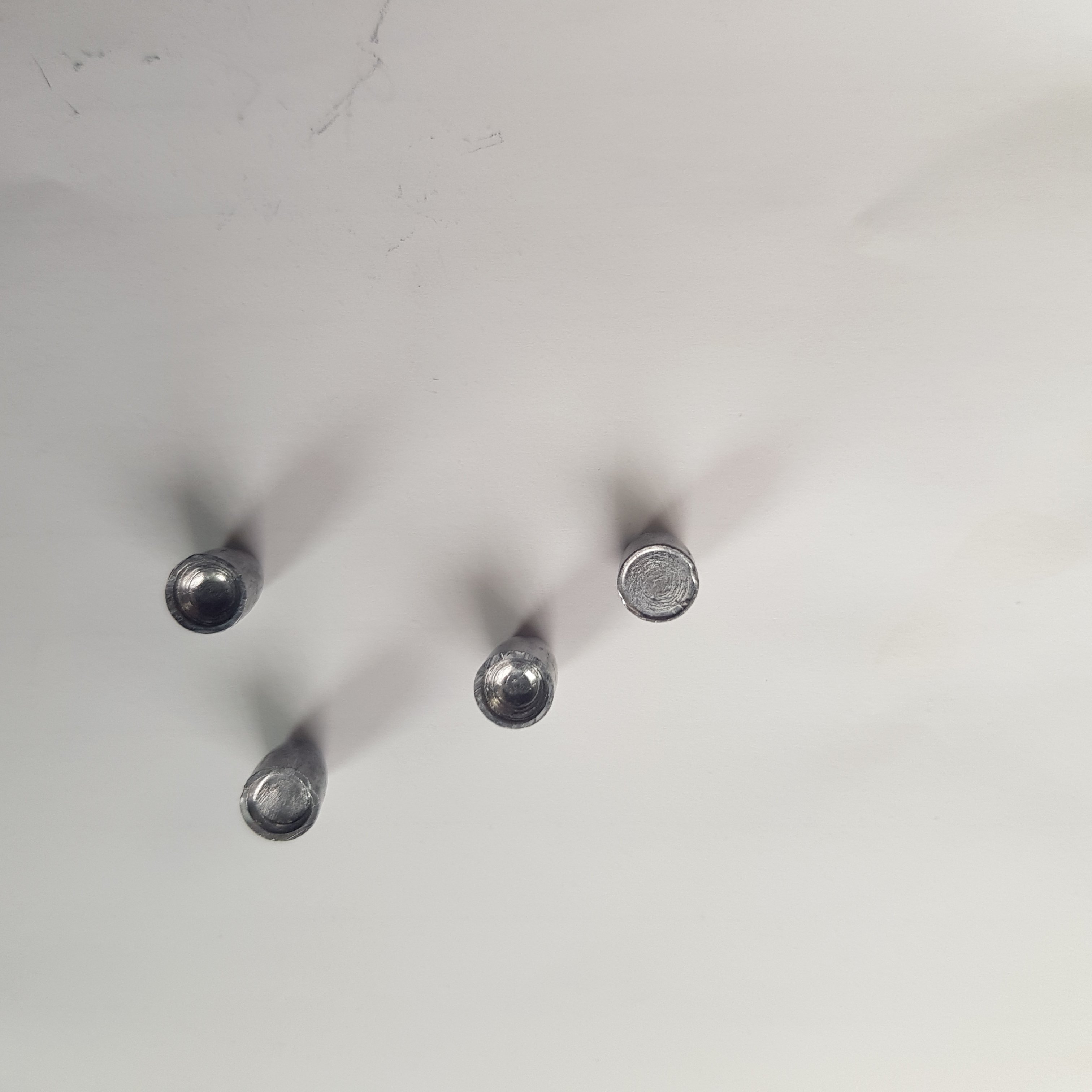

I make my own slugs as I found fx slugs didn't cut the mustard.
It took me a while to find what worked in my rifles at sub 12ft lbs. Even though people said dont bother they won't group or flatten at that speed.
But I perciveerd and got there .
I rarely use pellets now as it costs me about £1 .50 to make myself 500 slugs that are superbly accurate and grain for grain identical.
I liked the look of the kral np03 but the barrel didn't like slugs hence the swap too the lw which fixed the problem.
Every man to his own is my motto as long as you enjoy shooting that's the main thing spinach.
It's good people have their input and views as life would be dull if we didn't
Some pics of my diy slugs:D
