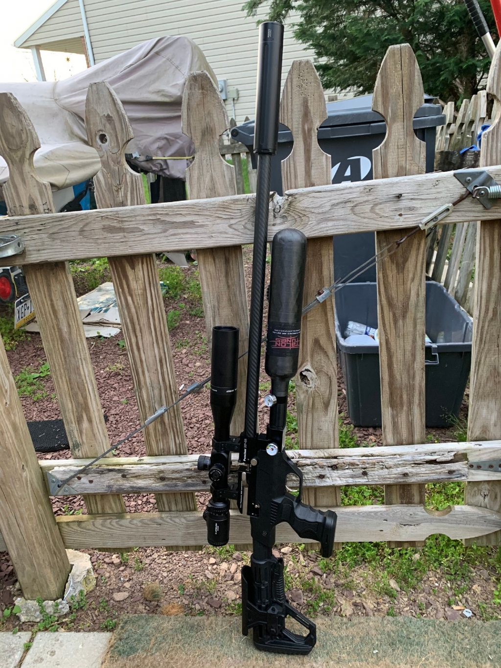

The drop-block came from a Ekinoks Semi-Auto , I bought the rifle just for the block when PA had a large price drop to move their inventory of them . The 580cc carbon fiber tank came from Talon Tunes . Huma external regulator . Barrel ordered from PA , Knight model 24" barrel caliber change kit . Carbon fiber shroud 13/16" x 0.941" from Clearwater Composites , metric tap 21mm x 1mm right hand thread .

Fantastic work! How are your power numbers

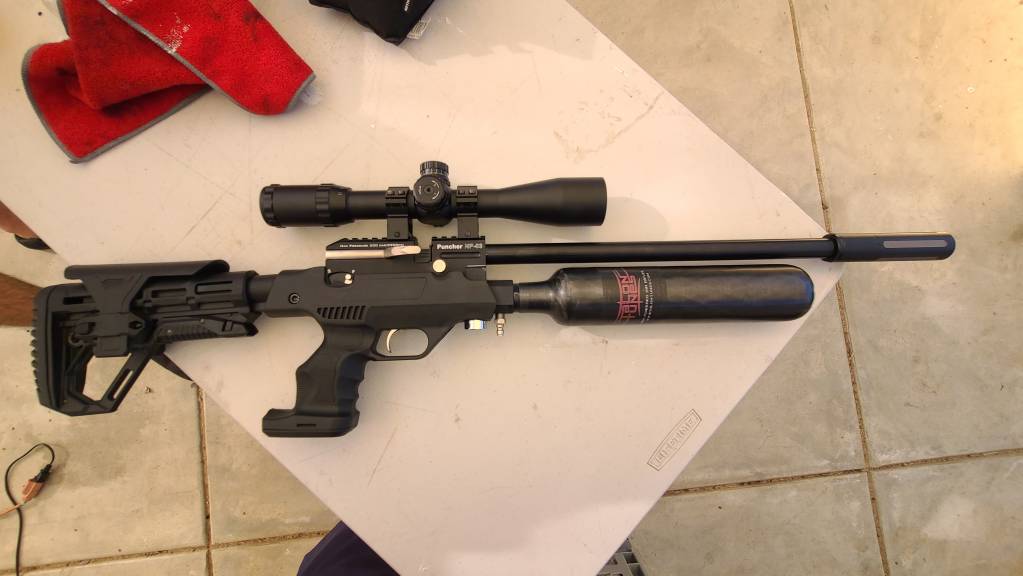

My Kral NP-580 . 24" barrel . .22 cal .
Reviving an older post, do you have any tutorials on how you did this? Barrel swap seems fairly simple, but what about converting to bottle gun? Looks like you did some stock trimming, but other than that, how much did you have to modify without just bolting on new parts, if if you don’t mind saying how much it. OST you overall?
