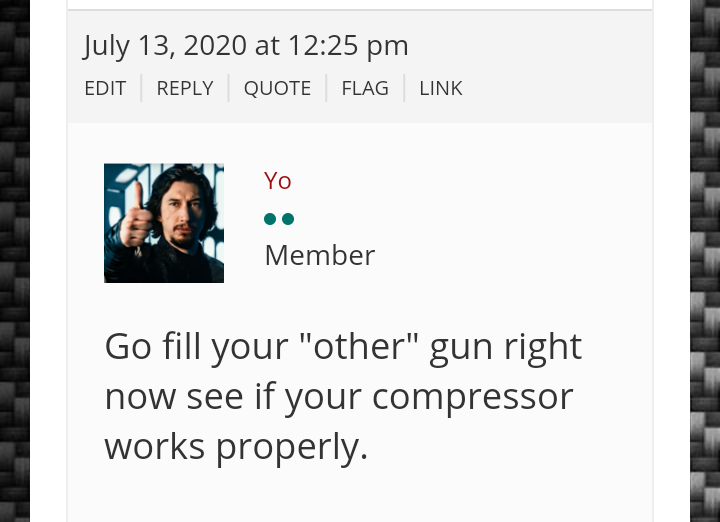

Back at YO compressor fine, other gun fills and works just like it should, HAPPY. Next, shot the gun down, maybe a little too far, reservoir is apparently empty . Now no air will go into the rifle either cocked or uncocked, while the compressor is running, air is escaping from the end of the barrel. Side note very accurate at 25yds with 18grs. Note to sevekrals/arou, gun is new, no other probe available.
