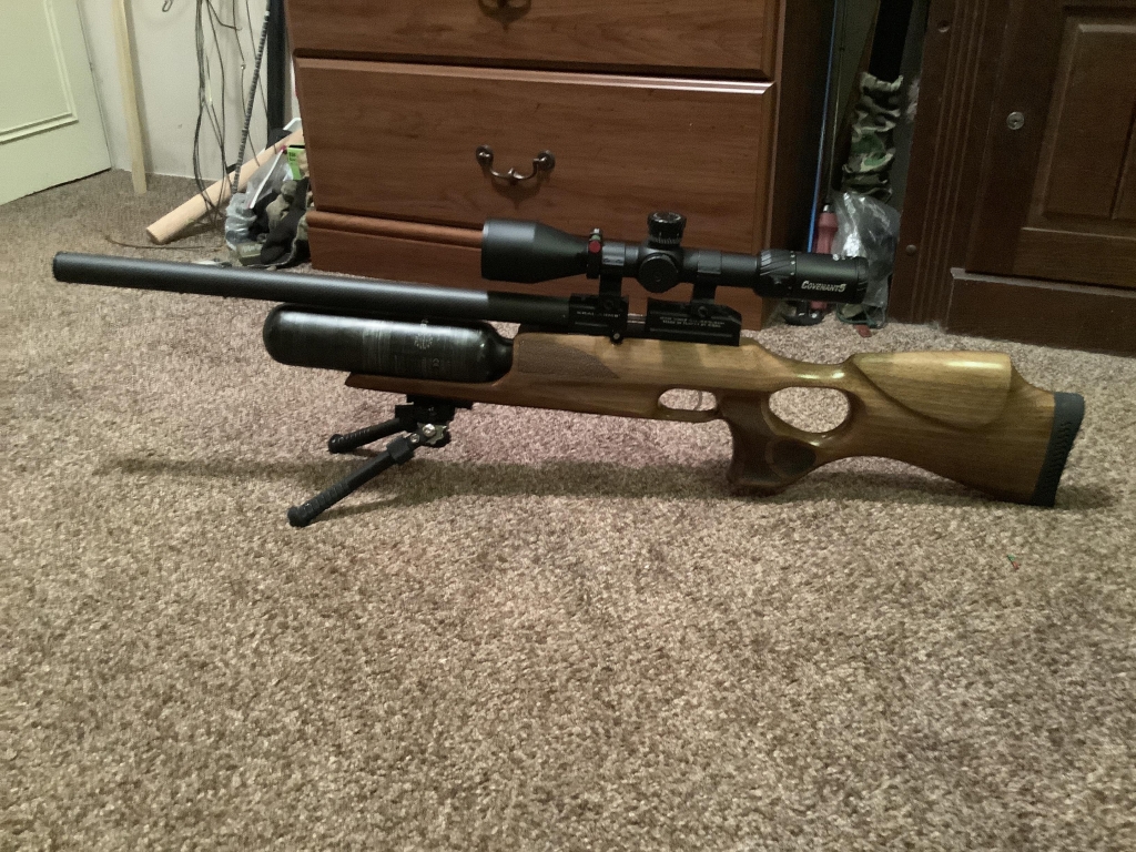

Has anyone modded a Kral jumbo to use the barrel shroud as a suppressor. I’m a machinest by trade so I was thinking of making a new end for the shroud that’s a tad longer. Then machining baffles into it and venting it back into the shroud. I use the gun at work for pest control and it’s a tad loud for my taste. I like the barrel length it’s at right now so I don't really want to add a ton of length to it with a screw on suppressor. Any ideas?
Funny you post this question, I just got done with mine yesterday. I went a little different route. I built a shorter barrel for it and with my silenced shroud, its only 38 inches long. Now I wait for my reg. I don’t like all the hammering and pinging of an unregulated gun.
