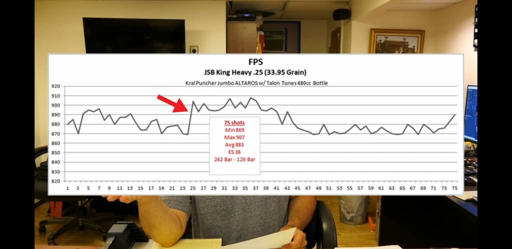

The reason I've asked is because I've seen Steve videos at Air Velocity Sport on the Kral. He was able to get in that range. With some of Troy Hammer help.
So, I was wondering if others are getting similar results.

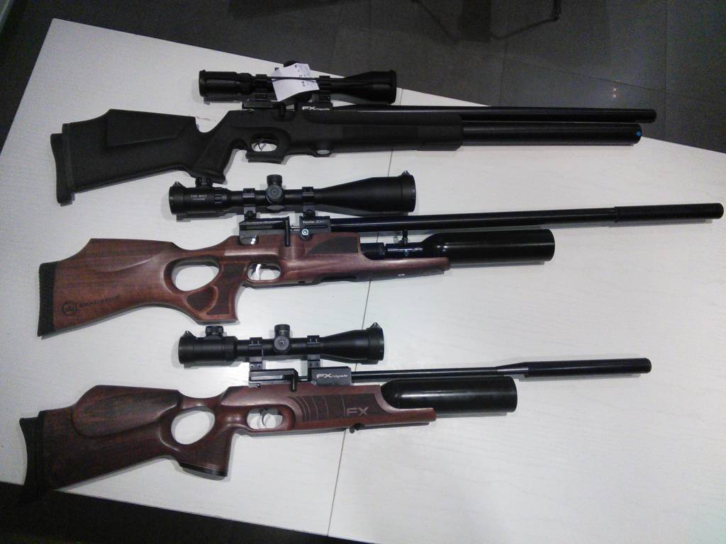

- the plenum size became quite generous with my paintball reg + adaptor set up. The adaptor acts as a type of power plenum. This set-up inevitably moved the bottle forward. I use the resulting space to store my shooting log 😎. This being a long gun (especially with the recommended silencer), it remains well-balanced. See it being sandwiched between 2 FX Royale's below.

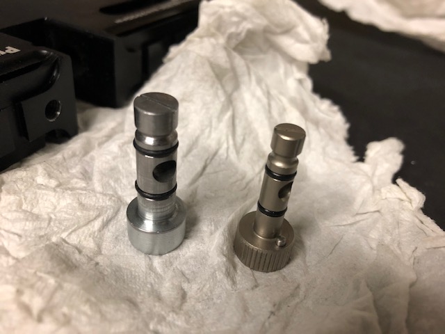

- the enlarged ports (5mm -- oval in the barrel!). This porting is easy enough but you need to overcome the power adjuster limitation (limited diameter). Replacing the stock power adjuster by a self-made one out of an 8mm allen bolt was not the end of the world, even for a non-metal worker like undersigned.
