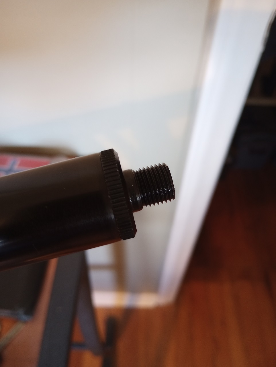

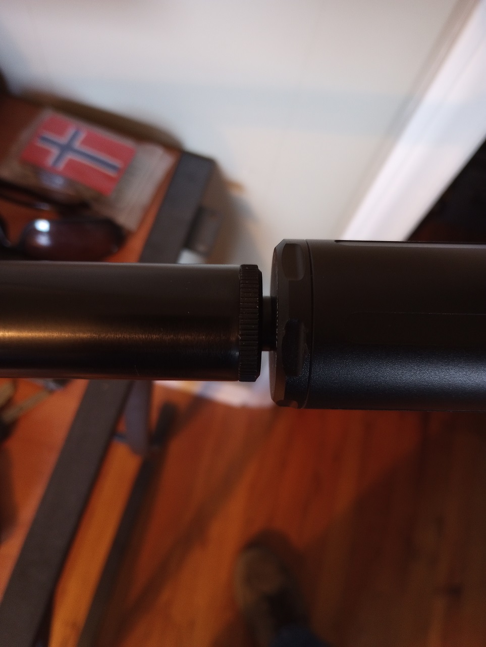

Today was the first good weather day we've had since getting the Bighorn, so I set up a N50 target and shot 4 1/2 magazines for accuracy. I was getting "OK" accuracy, maybe 1.5 to 2 MOA, which was a little disappointing. I was beginning to think it might be the ammo, but then I decided to shoot 5 more rounds with the suppressor off. Boy, what a difference. All 5 shots were hole in hole, easily 1/4 MOA. So I figure there's something going on with the suppressor. I suspect that the mount isn't as solid as it should be. The threaded end cap threads end about 1/8" short, and that's probably just enough to cause some wobble and loss of accuracy.

I have been puzzled by the Karl “ring round the bottom”12-20 end cap, as far as function, I guess it was to be easier to remove the led? My fix came with the immediate -removal of the choke, then putting on a dfl threaded adapter which is hidden under my vented shroud.
