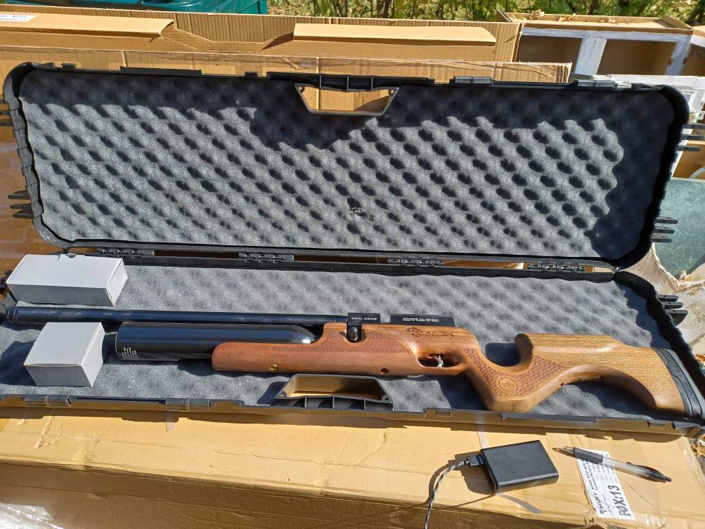

Kral Bighorn
I received the Kral Bighorn in 25 caliber 30 caliber and 357. Big potential. The 25 although a small shot count due to heavy hammer and heavy spring starts out at over 79 foot pounds with 39 grain slugs. The 30 caliber is just over 90 ft lb and the 357 is around 105 foot pounds. With a slight Hammer modification and a new twin spring De bounce system the 30 caliber was able to achieve four magazines 9 shots each for 36 shots at 80 foot pounds. And I should have the results on the 25 caliber and 357 by the middle of the week.
They have a 500cc 250 bar bottle and porting size is 6 mm from valve to Barrel.
Plus a tensioned 580 mm Barrel and some beautiful Turkish Walnut stocks.

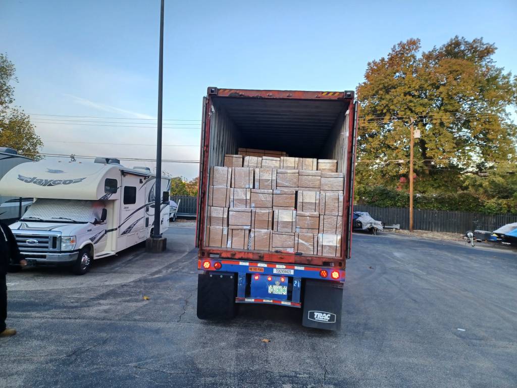

I could not find his new site either this morning. Looking at that truck load of Krals, I would think it might be a while before that site is up.
