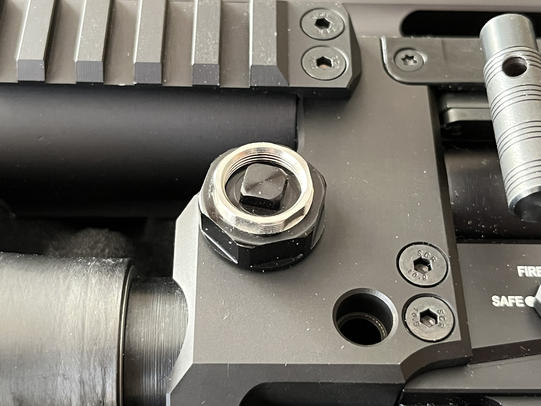

I've had an AirMax Krait air rifle with the a MK4 regulator from Huma (the one with four holes for the adjustment key) for several months now. Unfortunately, from the very beginning, the regulator had severe creep issues. I was disappointed with the rifle and even considered returning it, even though I really liked it. I knew that earlier versions of the regulators and monoblocks had problems with creep, but my version was supposedly free from this defect.
Unfortunately, I was badly disappointed because mine also suffered from creep. I suspected there was an issue with the regulator. So I ordered a spare regulator from the Huma store. After replacing the regulator with the newly purchased one, the creep problem still remained. I disassembled both regulators and examined them - they looked perfect, yet they didn't work properly.
I then ordered a repair kit for this regulator from Huma, as well as two additional disks separately. I received a repair kit in one ziplock bag, but half of the O-rings didn't match my version of the regulator, along with two original beige disks. In the second bag, instead of two more disks for the Krait, I found O-rings for the FX Gen 1-2-3 and two disks for FX. I was a bit annoyed by this.
I began replacing the O-rings and disks in my regulator, but there was no improvement - the regulator still crept terribly. Out of curiosity, I finally installed a disk from the FX, and it was a bullseye. The regulator came back to life. There's absolutely no creep now, and it's very precise.
The original disk in the regulator is beige and has a diameter of approximately 4.10 mm - 4.13 mm and a thickness of 1.37 mm - 1.42 mm (1 measured two disks). The FX disk has a diameter of 4.08 mm and a thickness of 1.05 mm, and it is white. It seems to me life. There's absolutely no creep now, and it's very precise.
The original disk in the regulator is beige and has a diameter of approximately 4.10 mm - 4.13 mm and a thickness of 1.37 mm - 1.42 mm (I measured two disks). The FX disk has a diameter of 4.08 mm and a thickness of 1.05 mm, and it is white. It seems to me that the original disks are too thick and don't allow air to pass properly through the holes in the side wall of the regulator cylinder. Huma should take a close look at this, because it appears this is whe
re the problem lies.
