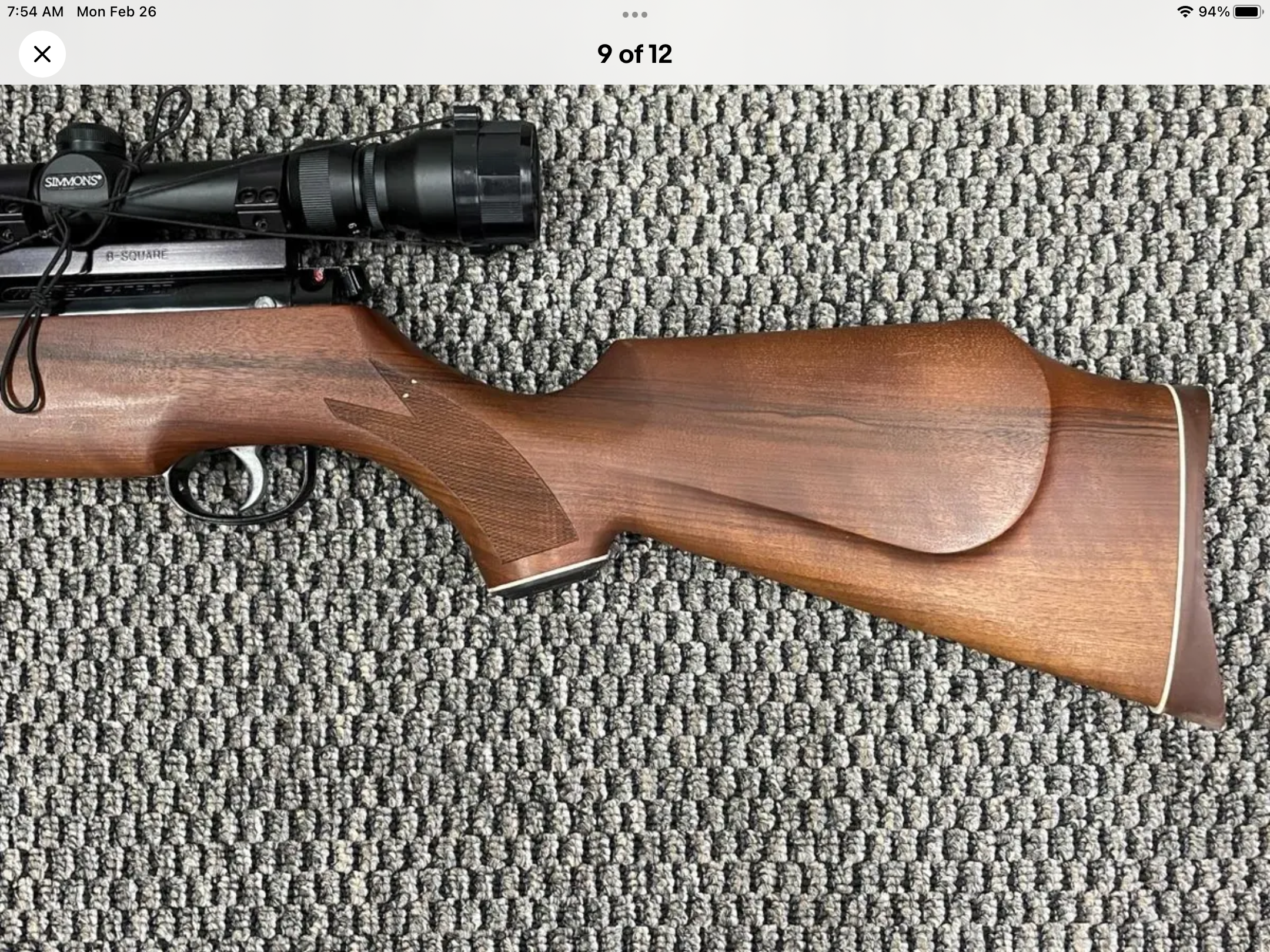

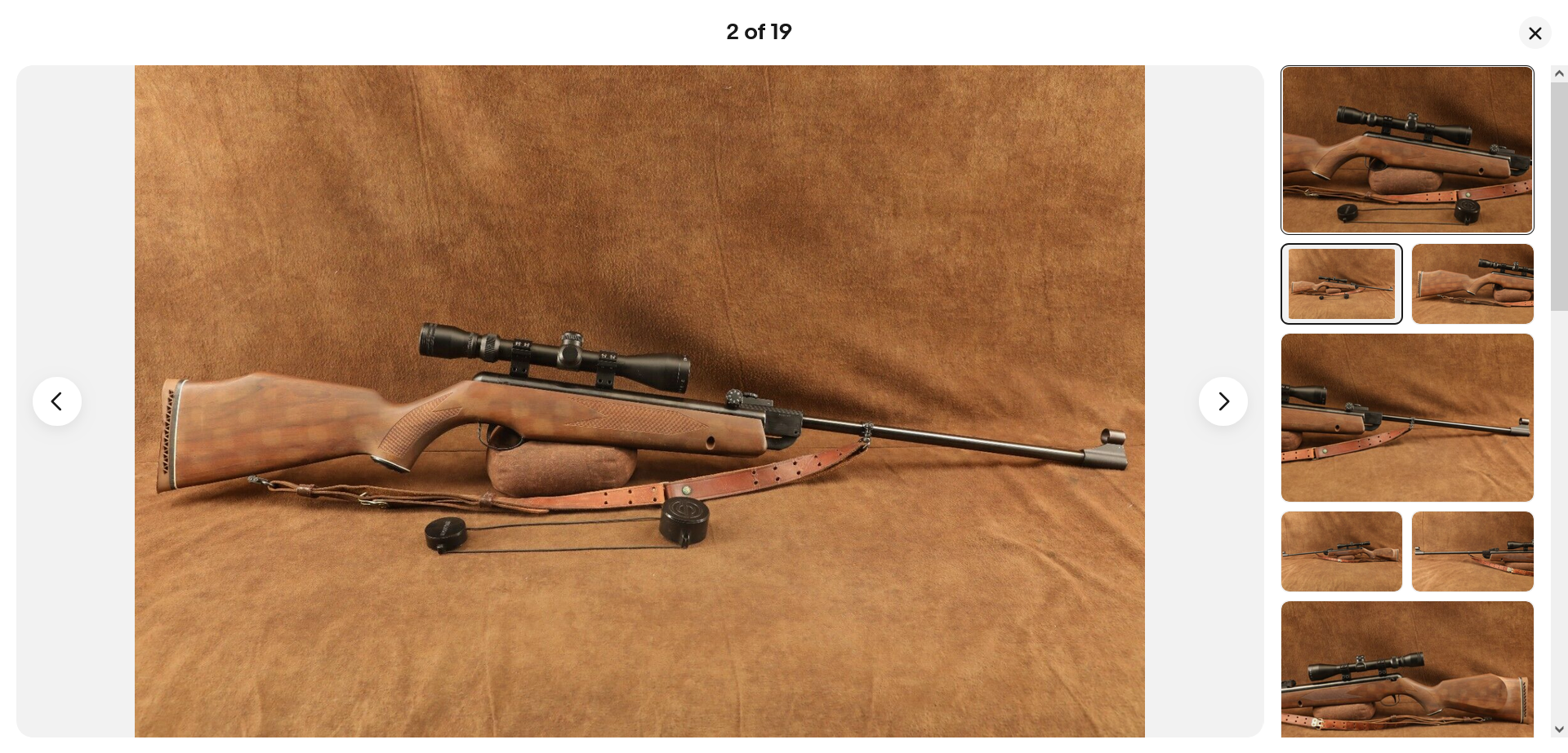

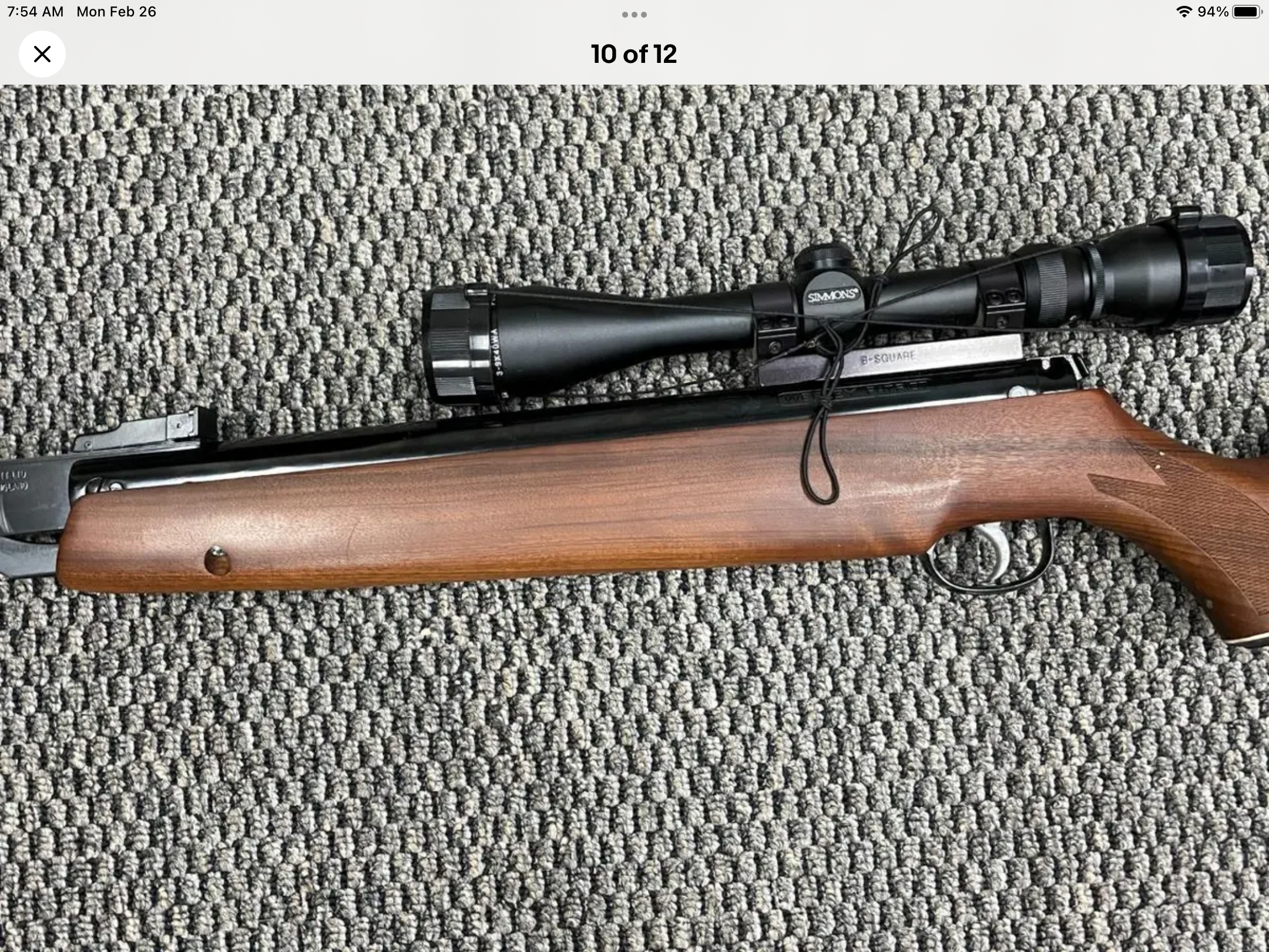

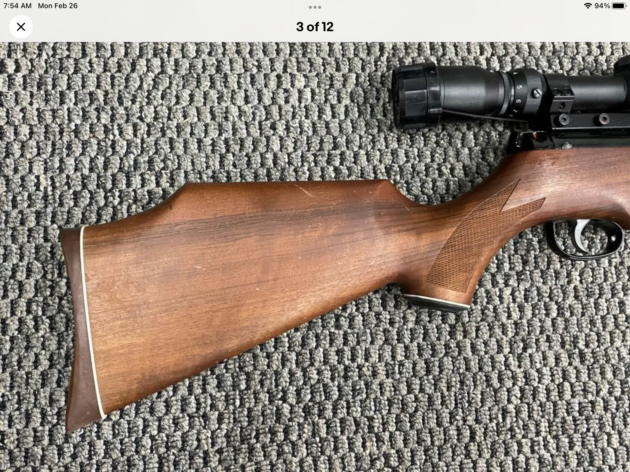

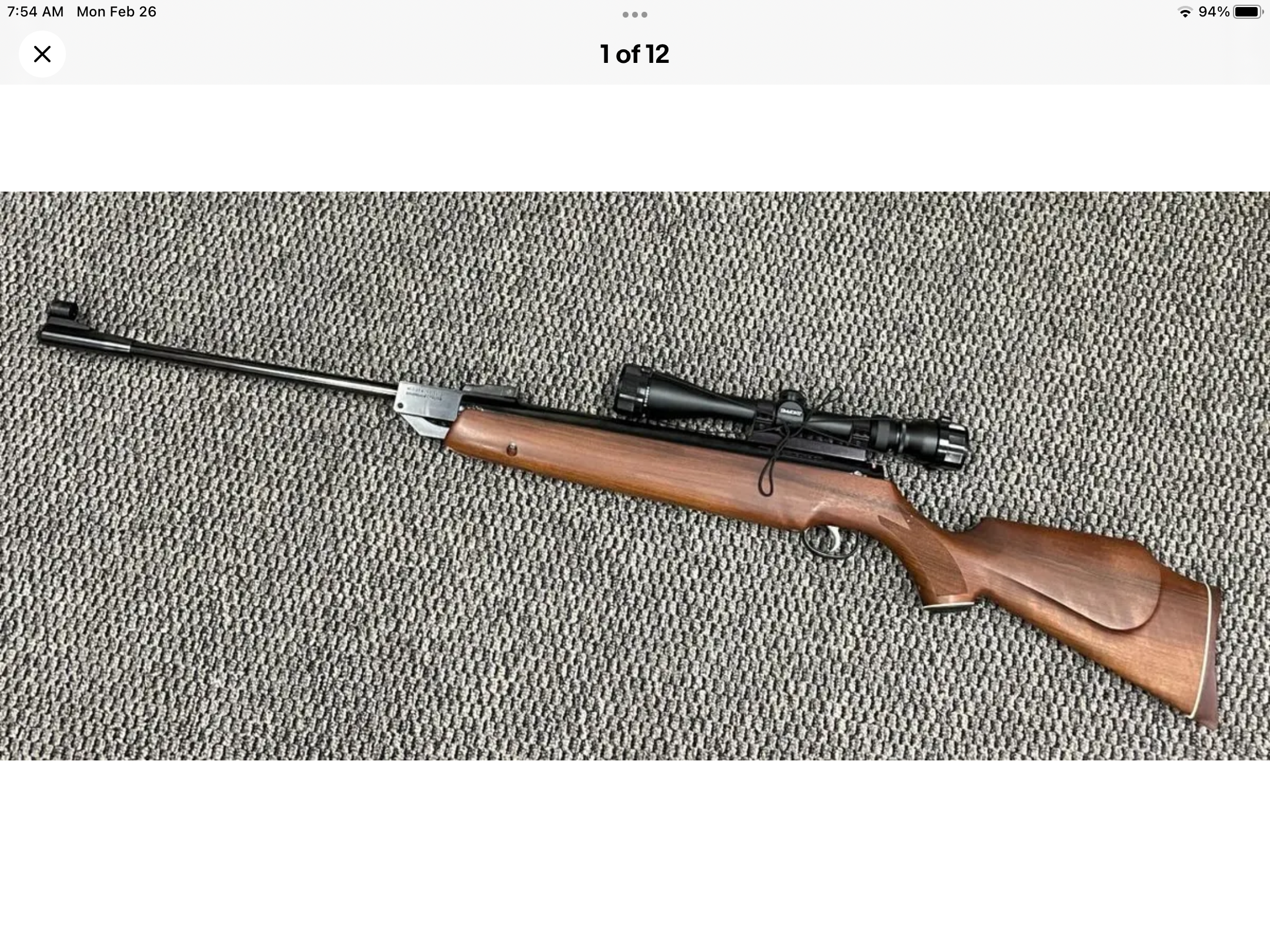

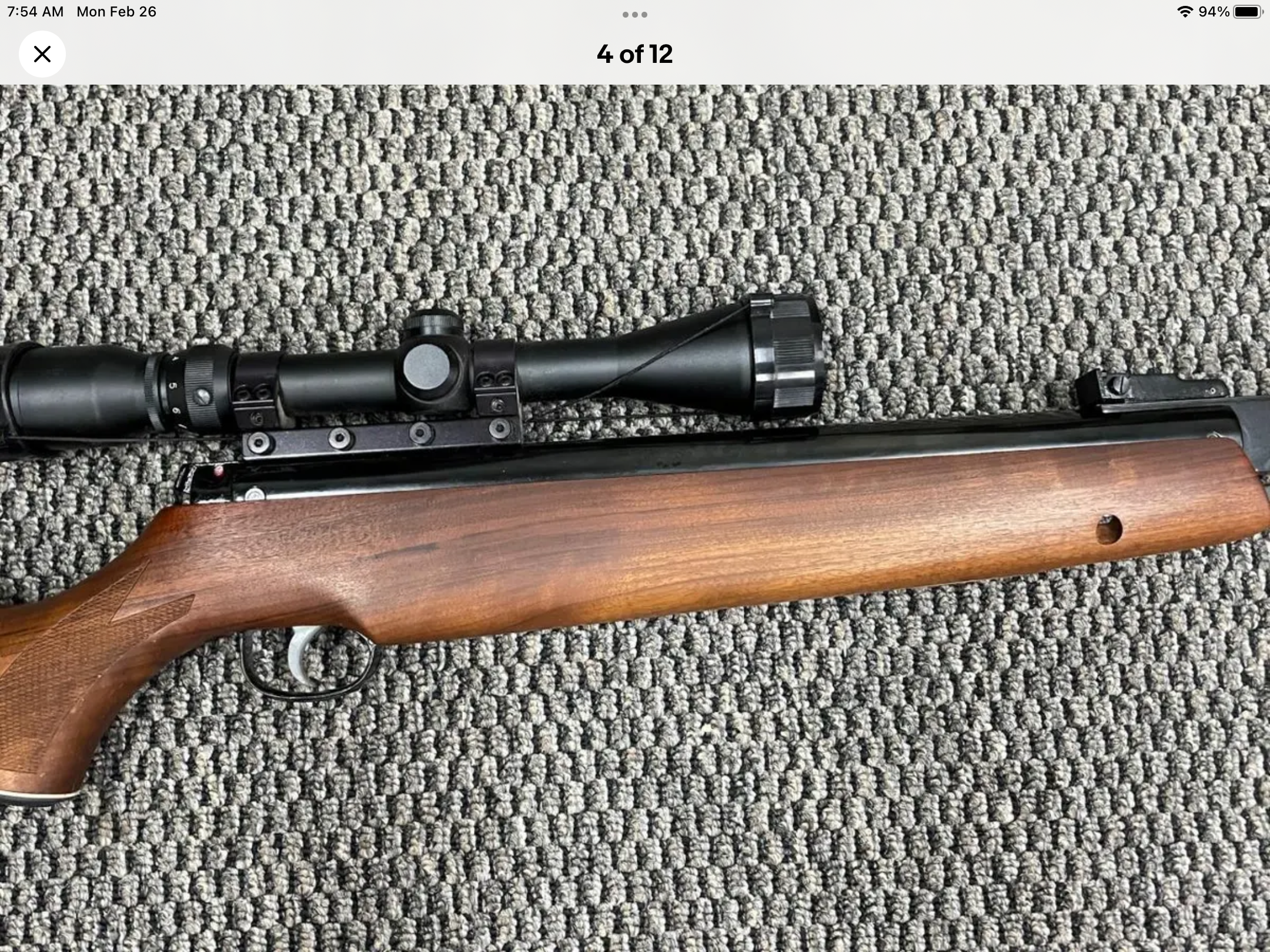

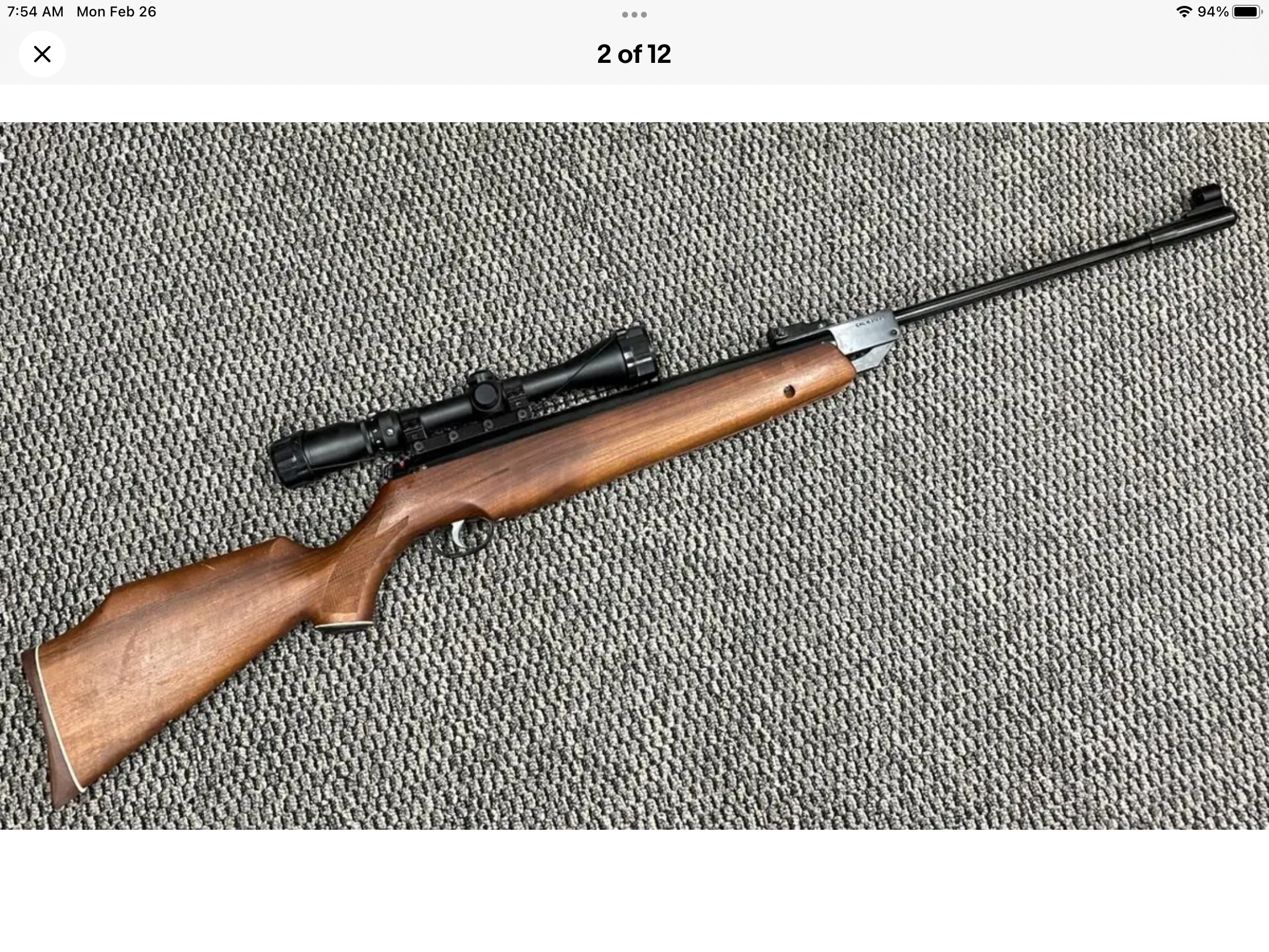

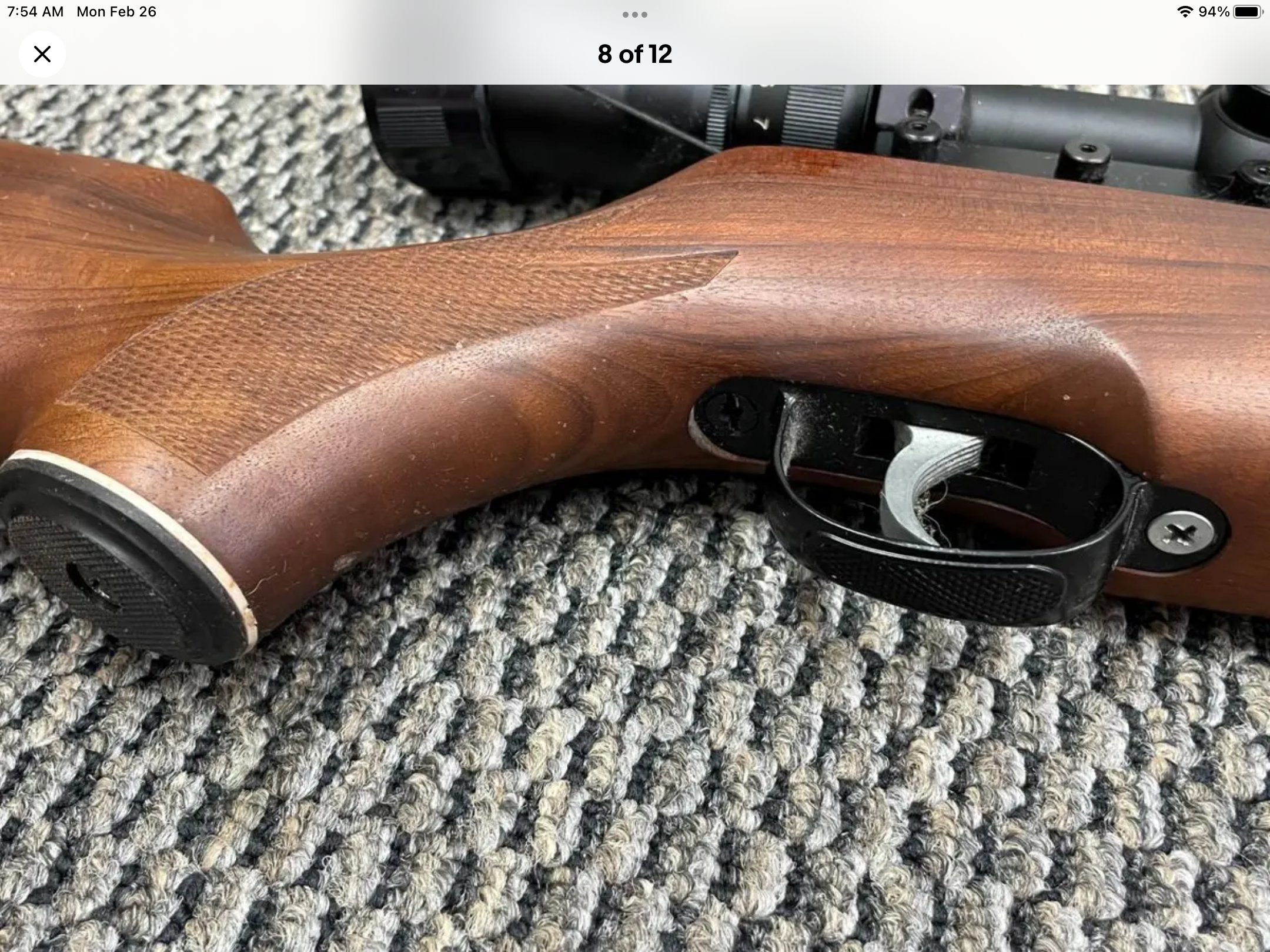

Is this the Webley walnut you refer to? Looks like what came on BSA Mercury S and Airsporter S from the 80's. Not a very good grade.

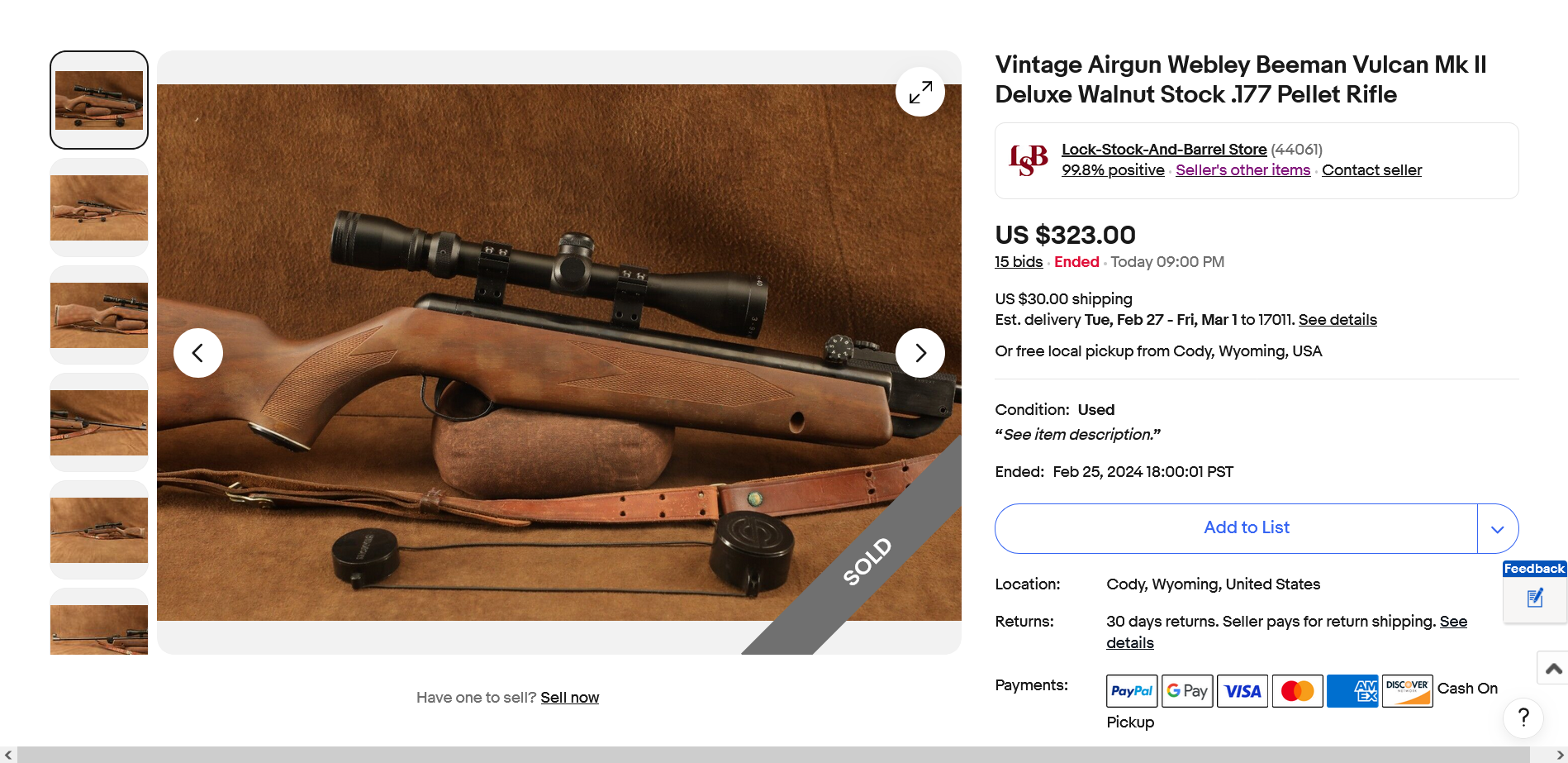

I didn't mention it earlier out of respect for bidders. I don't invite guests to YOUR party. The auction just ended. LSB did mention it has blotches but you can still see it's not at all spectacular. I've seen nicer walnut Vulcan Deluxe stocks before
Screenshot 2024-02-25 at 22-59-12 Vintage Airgun Webley Beeman Vulcan Mk II Deluxe Walnut Stoc...png
Screenshot 2024-02-25 at 22-58-48 Vintage Airgun Webley Beeman Vulcan Mk II Deluxe Walnut Stoc...png

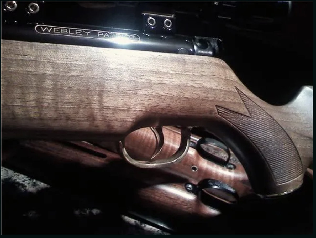

These are factory Patriots with Webleys so called walnut ..The top one is one I sold that was so blond I named it the Golden Eagle. , this latter just sold one bay for pennys I passed as I do not need anymore nor like factory stocks. I was surprised it sold so cheap.
