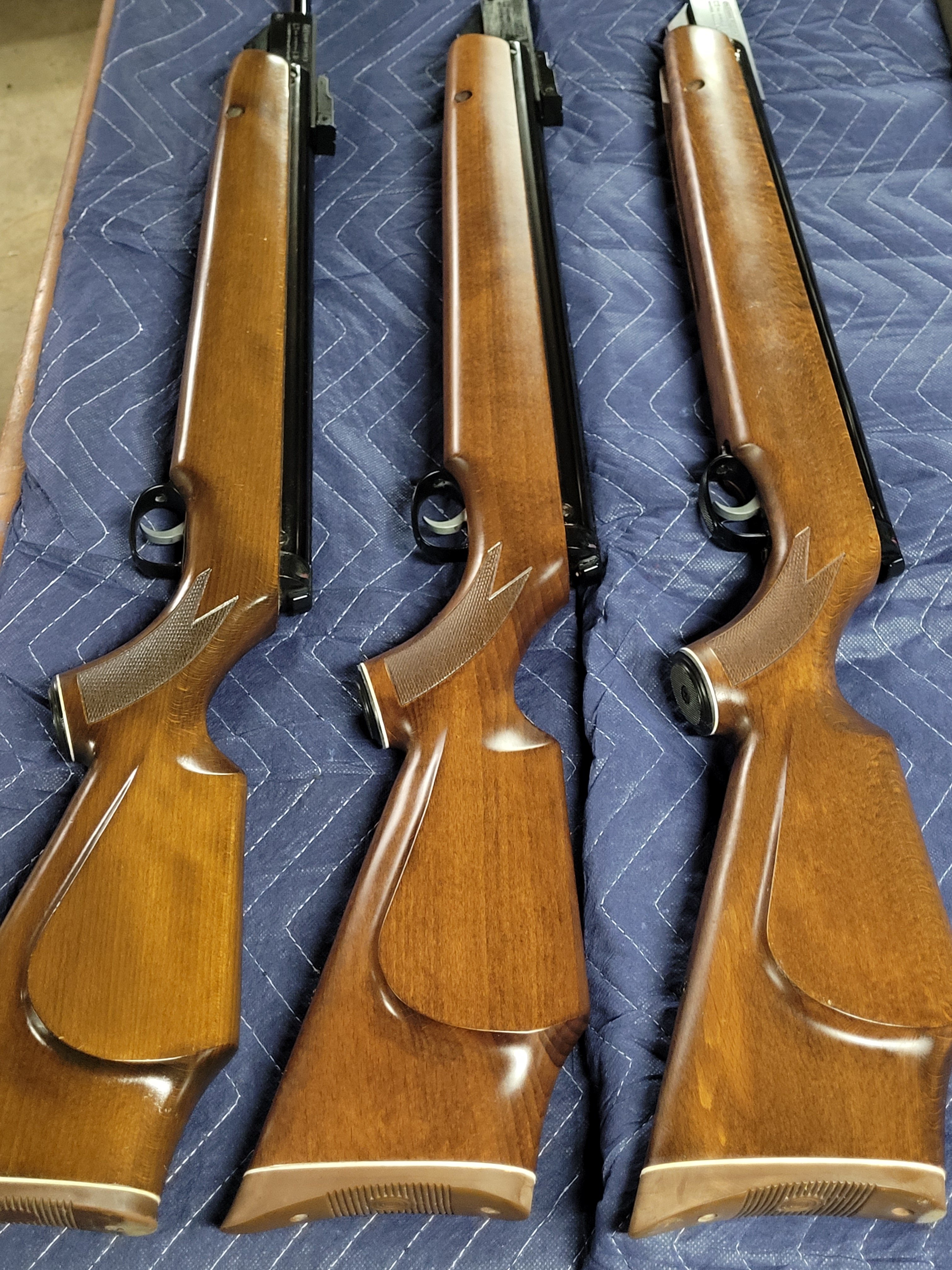

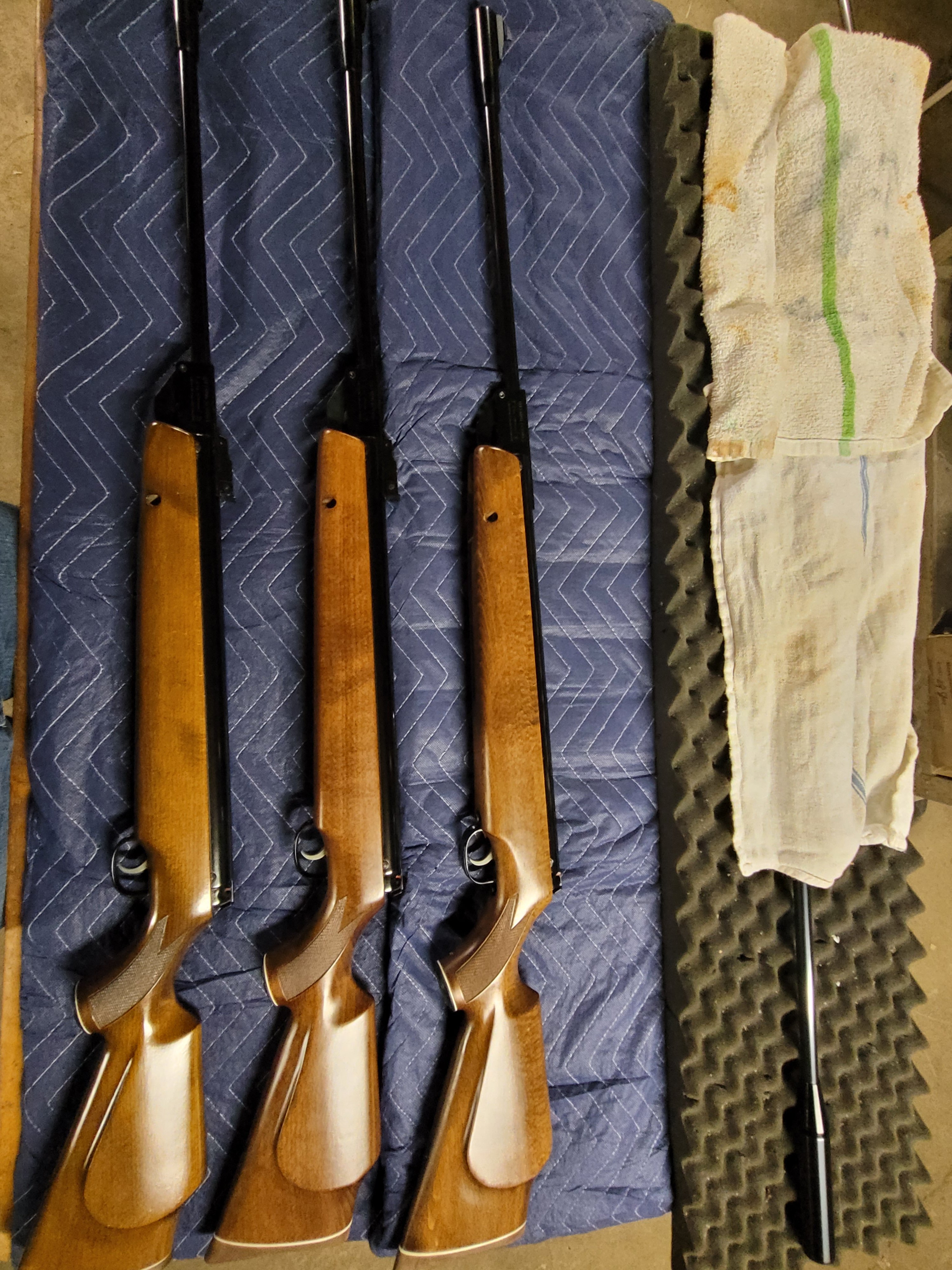

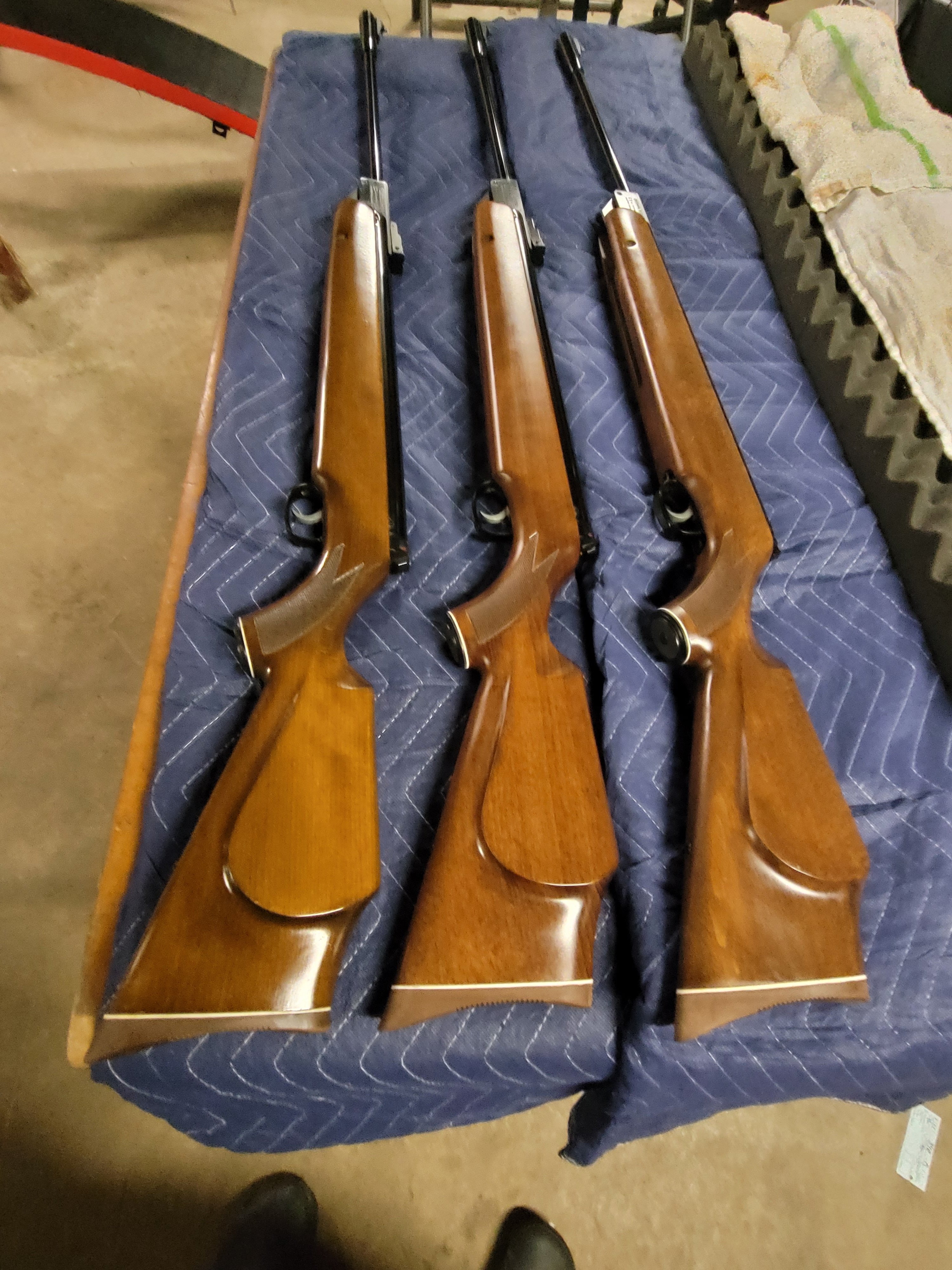

After receiving my latest rifle...a Beeman Kodiak. 22, I couldn't help but to break out my other two in .25 caliber for a group photo. Far left is the .25 Springer, in the middle is the .22. Far right is the .25 gas ram version. They're all different in the way they feel when fired. But one thing in common is they all are powerful and kick a little. Enjoy!
When these rifles first arrived on the scene in the 80s, they were touted as the most powerful airguns made. The 10 pound, very robust yet beautiful at the same time power house Kodiak ruled the Beeman roost.
English craftsmanship oozes from the deep black bluing. It breaks and closes smoothly with a reassuring click. Very Webley!

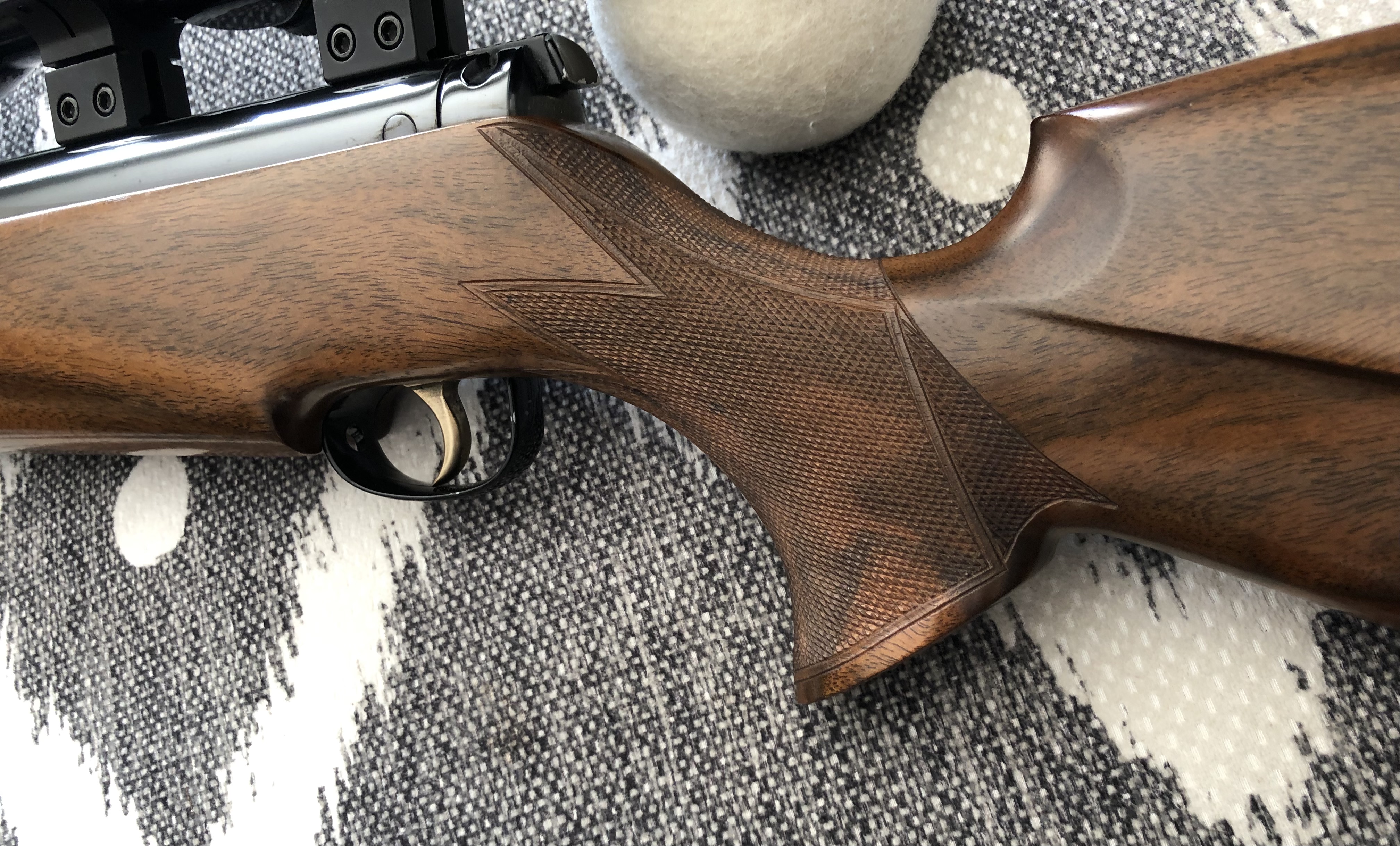

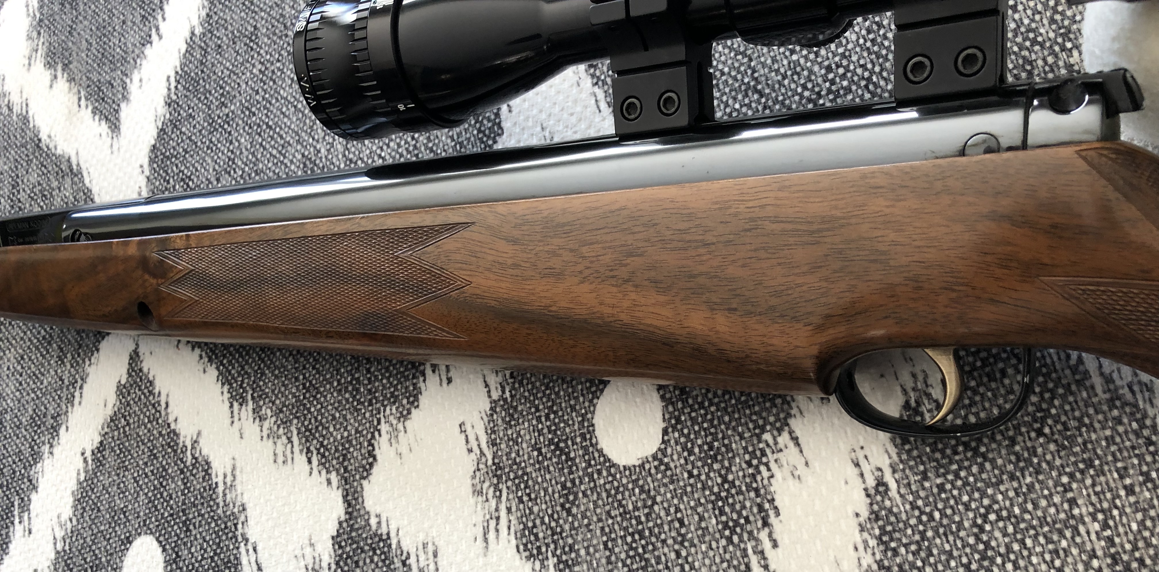

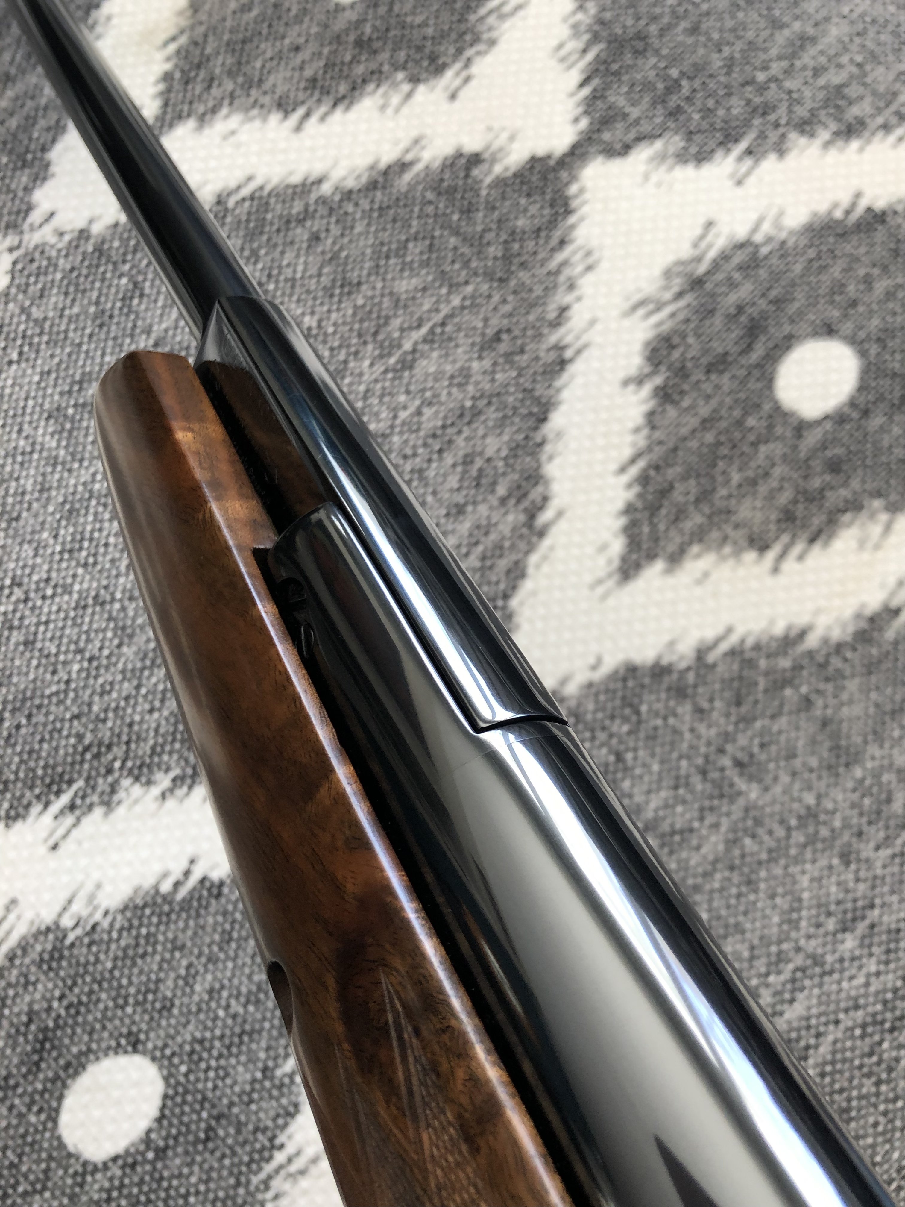

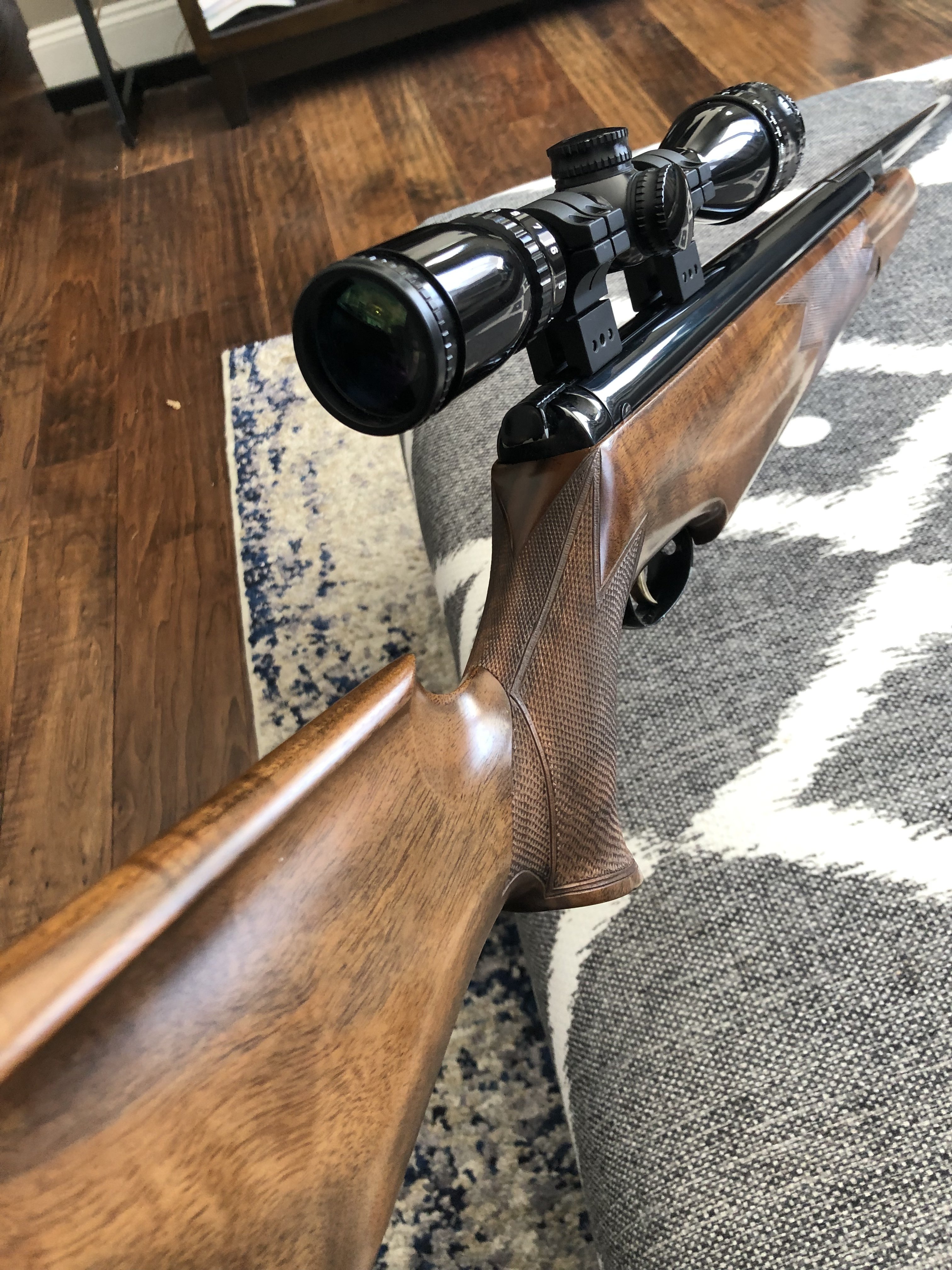

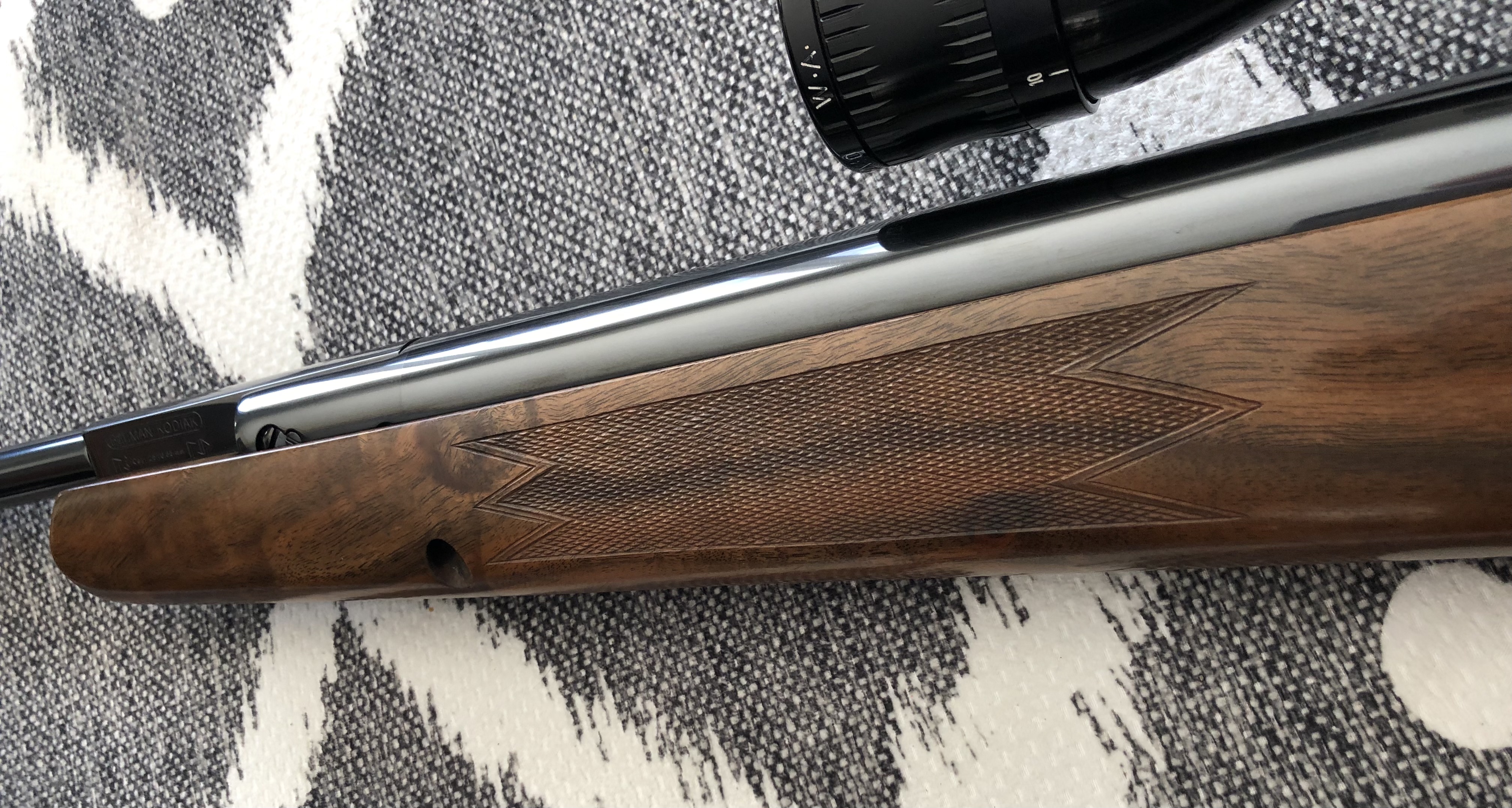

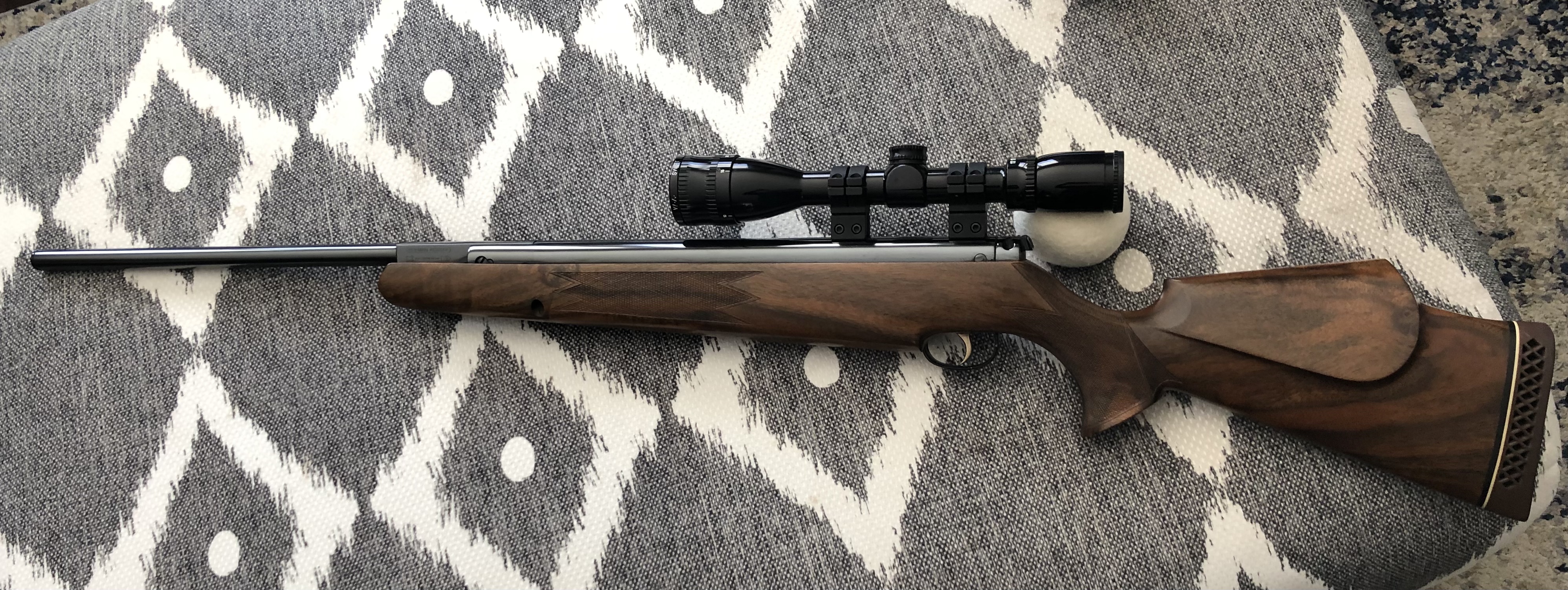

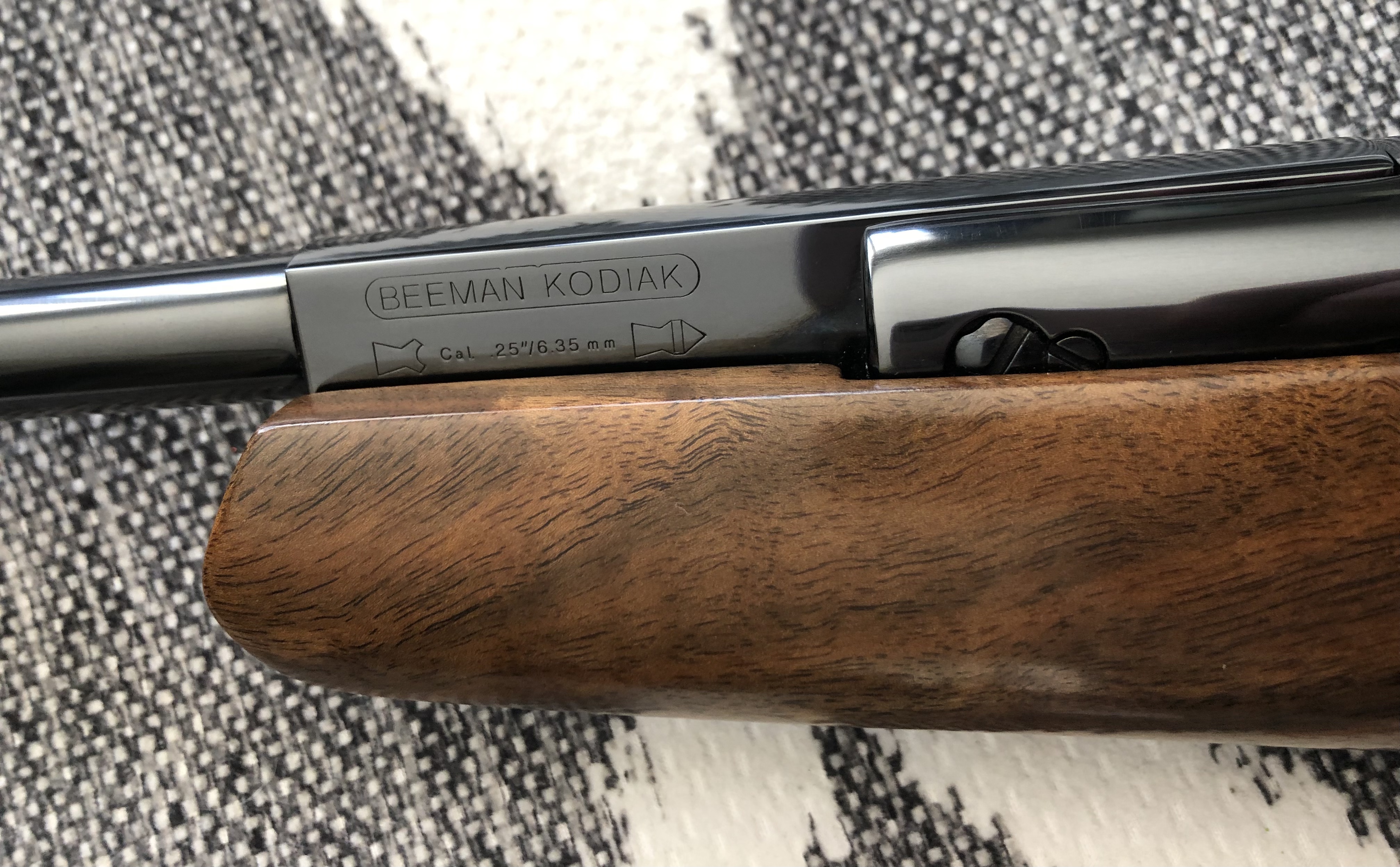

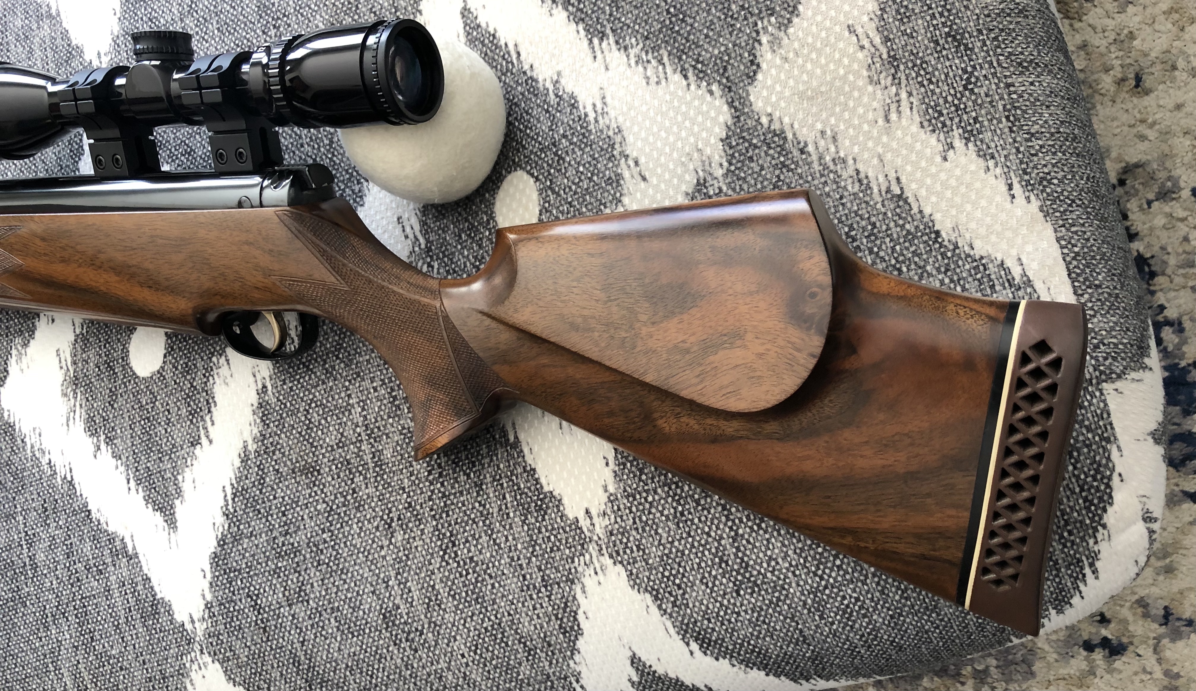

They were in a pseudo walnut . It was not American Black walnut, or a true walnut.I’ve owned several of them.
In stock form they are twangy and rough. Almost every .25 barrels were loose fitting and un choked. Making them harsh.. Tuned they can do 28 to 30 behaved ft lbs. Get them loaded up with a bigger spring and no additional work they will self destruct Your arm and shoulder.
They need extensive work to make them smooth as can be at 30 ft lbs.
This one is a shell of what a Kodiak it was. It uses the tube and breech block ,which was machined to match the tube .The rear plug was replaced with a solid metal machined one for proper holding power. The barrel was replaced with a Lothar Walther .25, and shrouded . A custom bespoke piston was made as well as guides and spring. The cocking arm was replaced as well as the Trigger re machined with hardened pins at contact points. All reblue and a custom stock make this a 30 ft lb gem.. for 30 ft lbs. There is no free lunch and physics can’t be beat,for evey action there is a re- action , so ,bent yes.. Its not a R9 to cock and had a solid rear recoil, but dead blow and accurate..

Beautiful rifle, thanks for letting us see it!!

That is a beautiful rifle....wow 😮

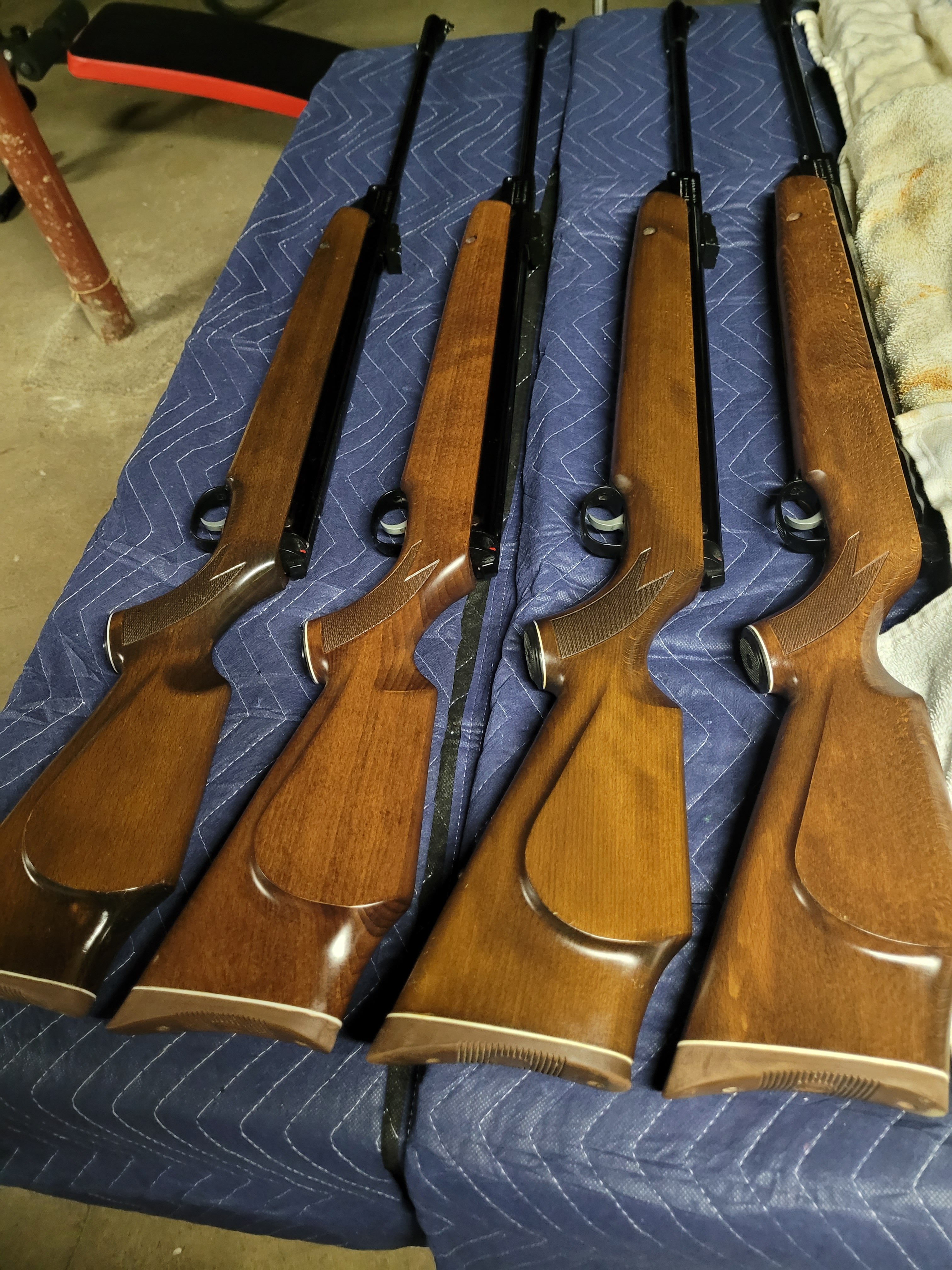

RETURN TO KODIAK ISLAND!
Found yet another one of these beasts. This one is a .22 that is equipped with the factory gas ram.
Very potent and snappy when fired. This one is dead nuts accurate. Cocking these gas ram rifles is different from cocking a spring gun. The majority of the resistance is at the very beginning of the stroke on the ram. The opposite holds true for spring guns. So, if you ever get to try one, I suggest you gear up for a hard pull (+50 ft/lbs).
Here's a picture of the current Kodiaks on the island. 2 left are spring guns...2 right gas rams. .22 + .25 calibers

As I mentioned....I love these big beasts. These and the Theoben Eliminators. ....especially. 25 calibre.
I've been fortunate to acquire these 4 Kodiaks... especially the 2 gas rams.
Some are critical of the Webley trigger, but for what it is....a Magnum springer....it has a very good trigger.
I'll keep on buying these rifles if I can. I'm hoping to find one in .20 calibre.
