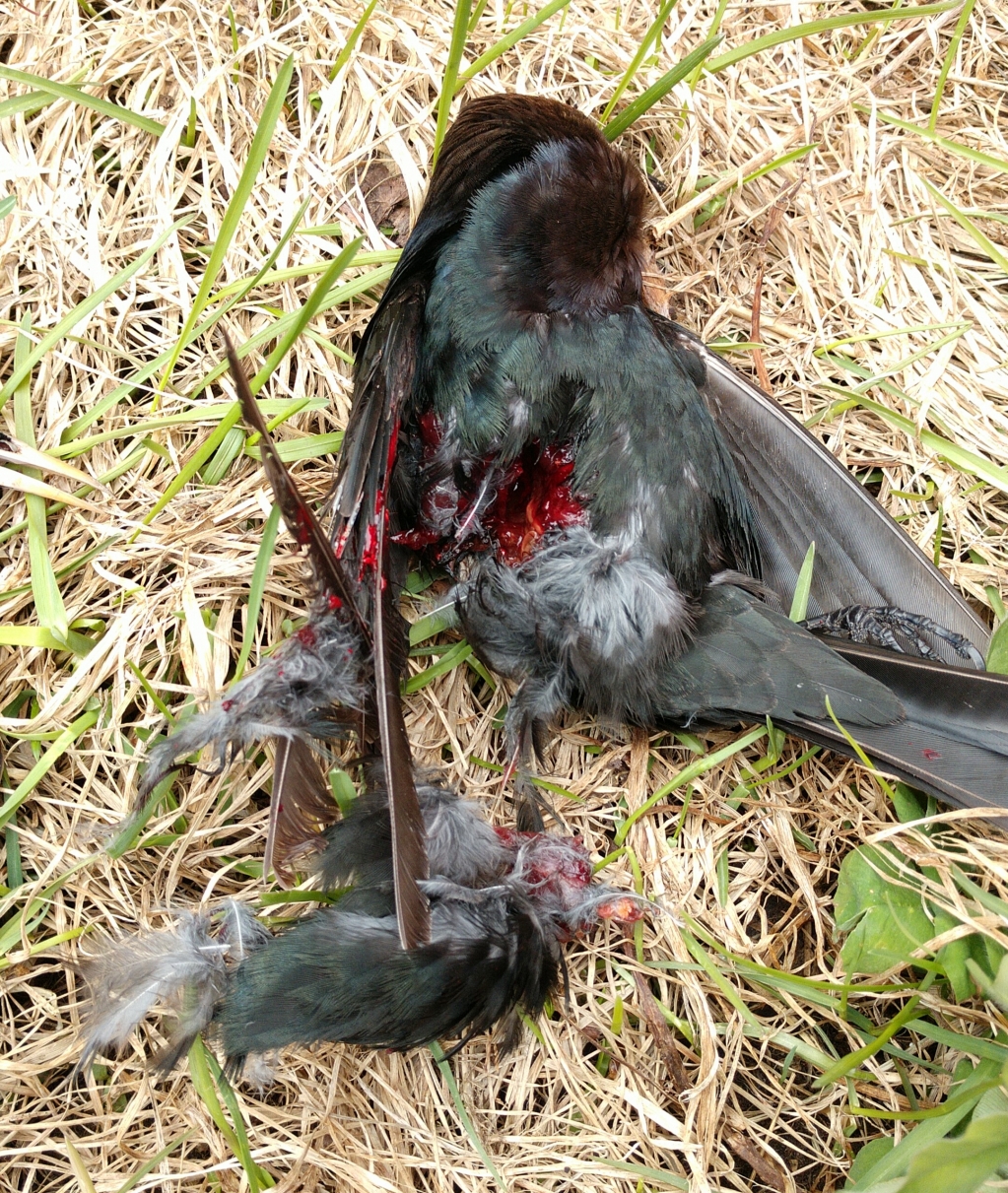

It seems odd to me that we still have conversations that include statements like “airguns dont have hydrostatic shock because they go too slow”.
we have plenty of footage of birds literally tearing in half from hits. If you want to see hydrostatic shock in action, keep an eye out next weekend for our new video where we are testing new slugs. The shock is amazing. We cant even show some of the hits on youtube it was such a violent reaction to flesh Airguns can and do have a ton of shock when tuned up Thats what that beautiful pop noise is!
There's no doubt the slugs are effective but the pop sound and ripping a bird in two don't necessarily represent evidence of hydrostatic shock. For example, the pop could also be from the cavitation trail behind the projectile. That said, you may well be right that your example represents hydrostatic shock. Do you have evidence that there is distant hemorrhaging? To my understanding, that would be pretty compelling. You seem very certain to the point of incredulous, however it isn't really us here on AGN that need to be convinced, it's the medical research community and its 70+ years of research that does.

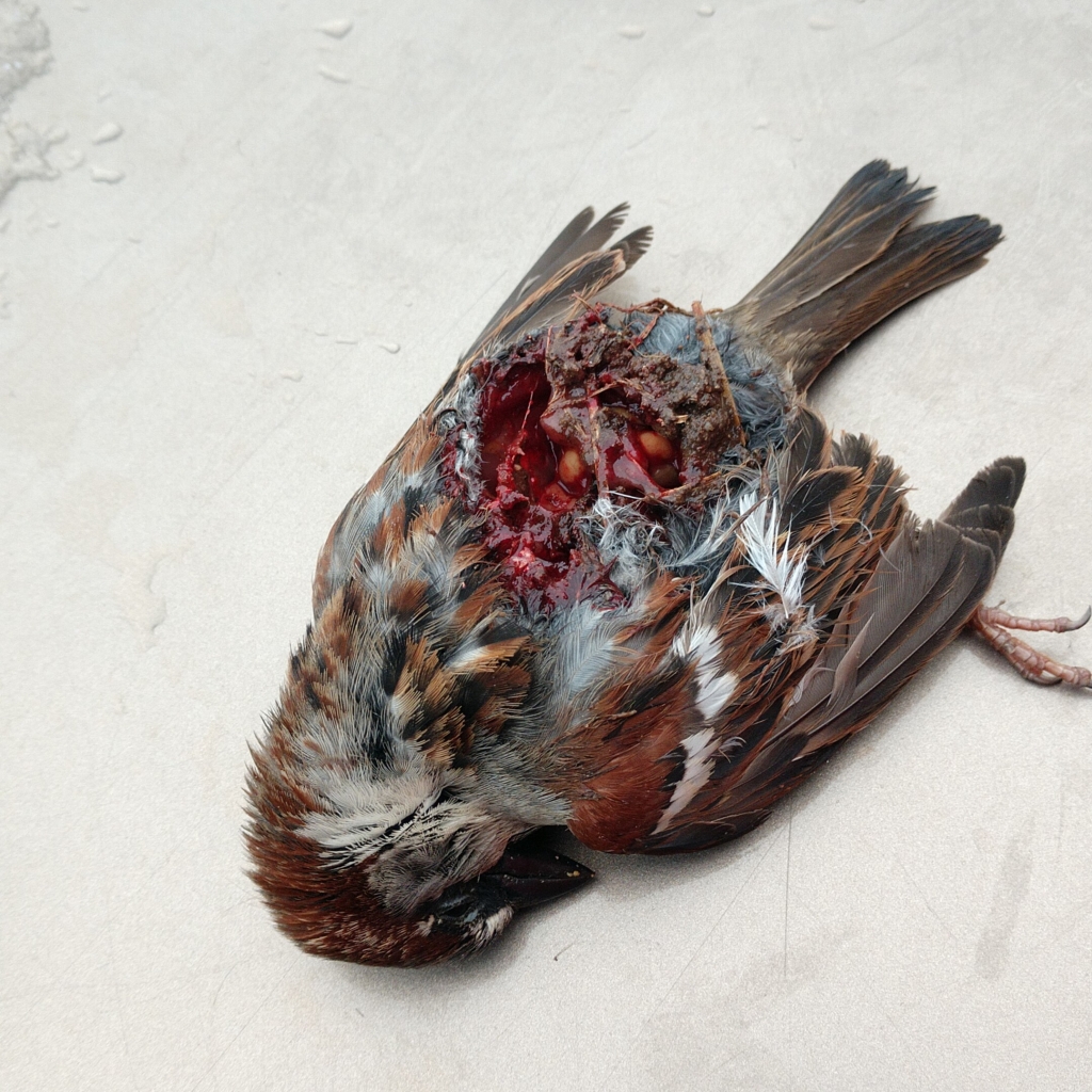

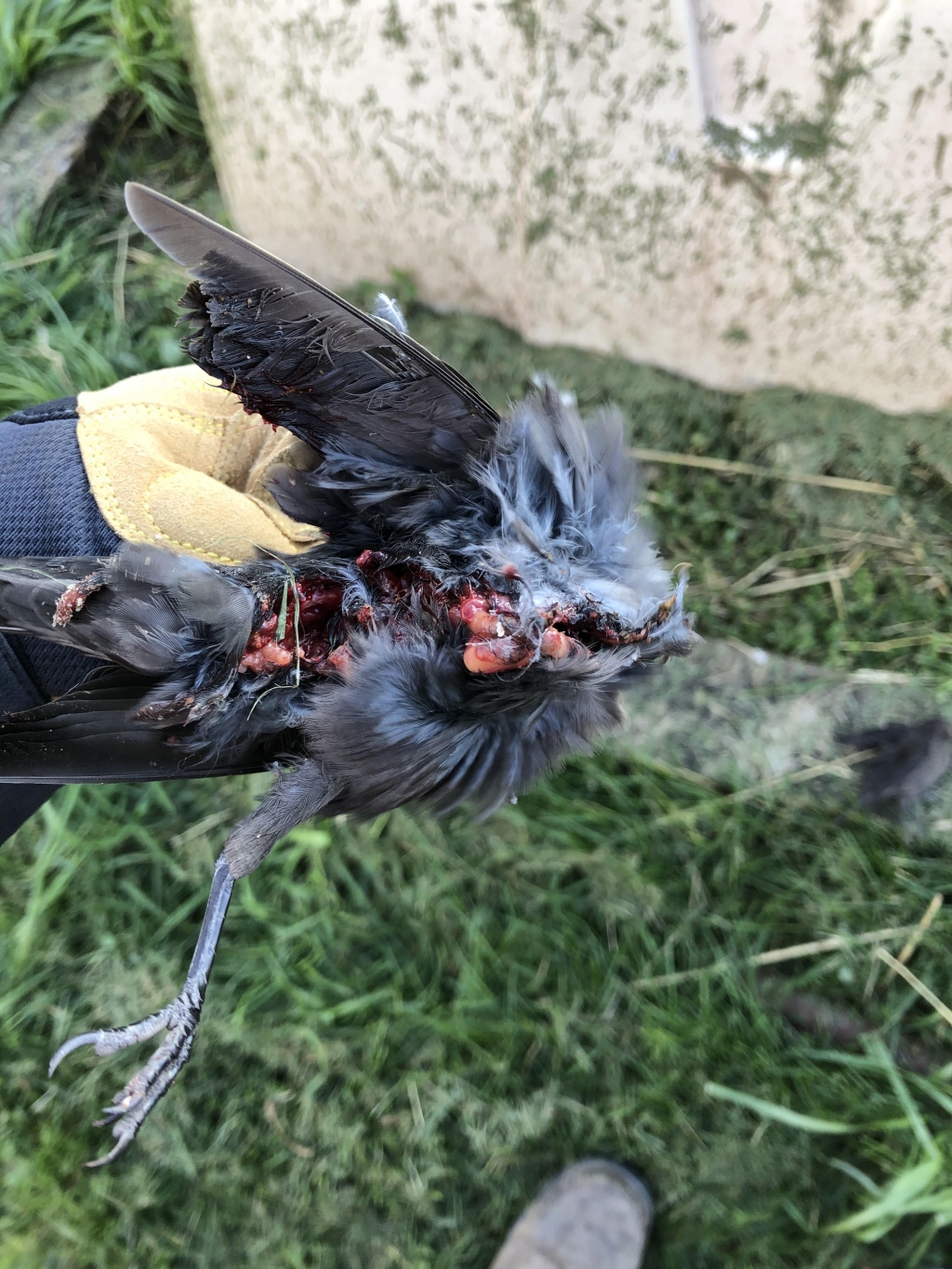

this mangled mess was shot at 60 yards with a 22 caliber slug, mz velocity of 945 fps. Given that the 22 is less than a quarter of an inch wide, i would say the condition of this bird points to distant bleeding and disruption of the cavity in its entirety. I saw this time and time again the other day. New slug designs are making a heck of a difference in the terminal performance of airguns. Quite literally and body hit we got that day resulted in an incapacitated bird. Low, high, side hits. All of them dropped on the spot unless it was truly a graze. Seemed like if the slug entered the body its entire width, it was gonna be over.
keith
I'm sorry, I'm going to need more proof that is a former bird. It looks like you took a handful of ground beef, mixed in some feathers, and then garnished it with a severed leg. :)

and to using pellets for urban pesting on low power, yes of course. I use them too. I have whole videos dedicated to 500 fps pesting. Its all situationsl wha one should use. But if we are asking if Airguns CAN cause remote tissue damage, the answer is obviously yes. No other explanation for what i just showed you guys. Too bad i cant put that on youtube, the slow mo is epic :). 100% instant.....check!
