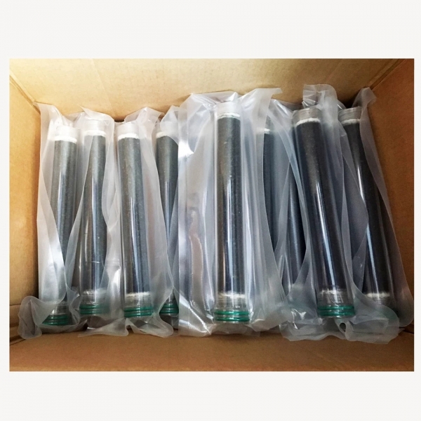

Most of us that I've seen are using the "gold" filter from China. If you search AliExpress you can find one shipped for $70. Here is the link to one from EBay. We fill the filter with Zeolite 13X and keep a small one inch section of the cotton filter on each end of the Zeolite...
​If I were you I wouldn't use the Hydraulic Oil at all and start with the synthetic Air Compressor Oil like the Royal Purple SynFilm compressor oil.

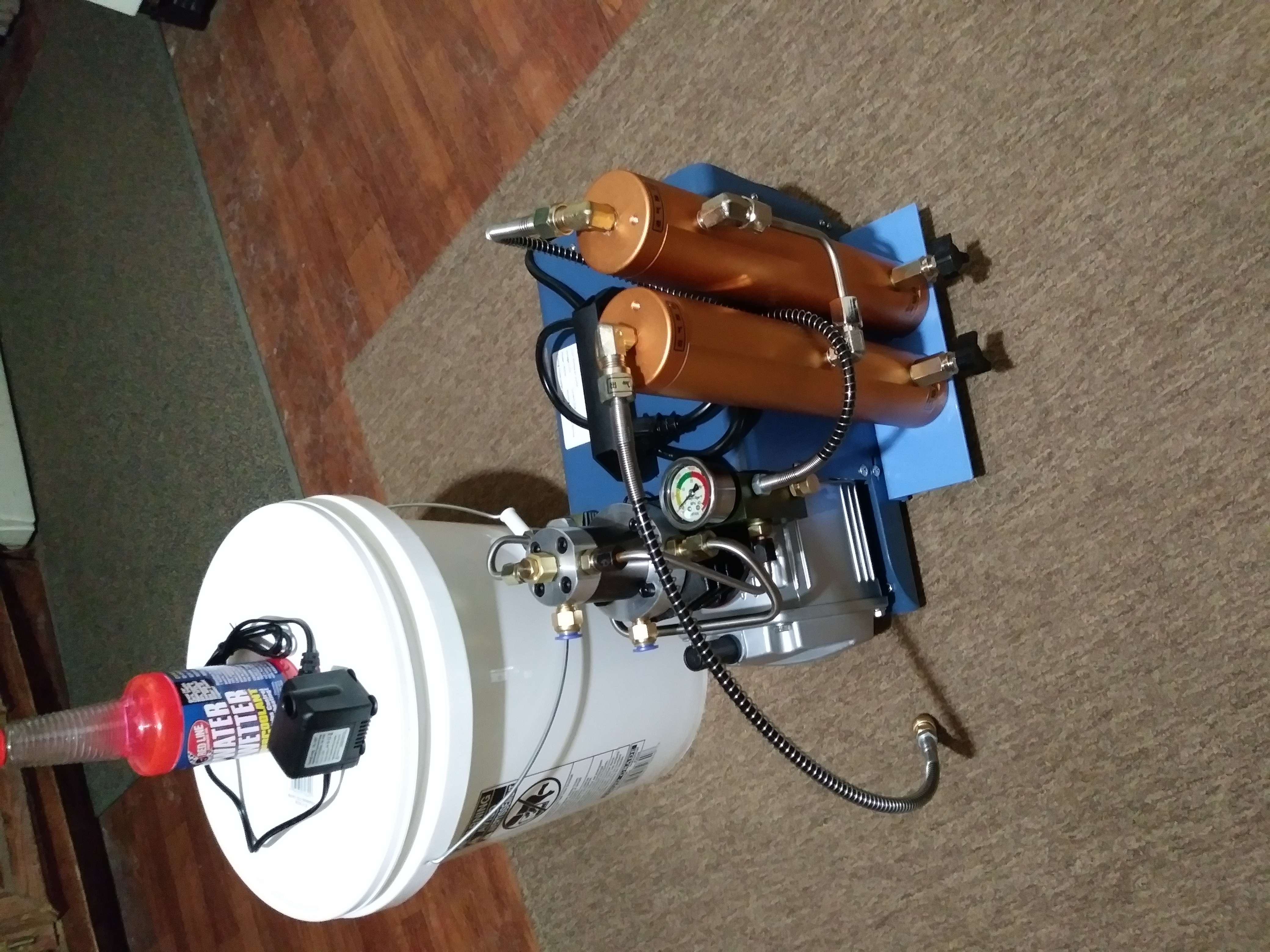

Finally got this contraption back together , just need to find some oil and sort out the coolant lines that don't fit the quick disconnects on the head . Hand pumping the crown to 250 bar two or three times a day is getting old lol

Well ran this compressor for the first time tonight and not impressed . Thing goes from 20 to 65c in under 5 min , water wetter and ice in the bucket and yes the pump is working . Turned the oil black with a lot of metallic particles in it just adding 100 bar to the crown . Looks like I will continue hand pumping while I bite the bullet and start shopping for a proper compressor . Win some loose some I guess .
I have the same compressor. The pump that came with the unit sucked sputtering and such so i bought a wet saw pump at home depot (royobi)
It takes about 30mins to top off my 109cu/ft tank from about 3200 to 4300psi. I use about 5lbs of ice and enough water to cover the pump and it never gos over 40c
I also use non detergent 30# oil in the piston block.I have run it a dozen times so far so good. Keeping my fingers crossed!
