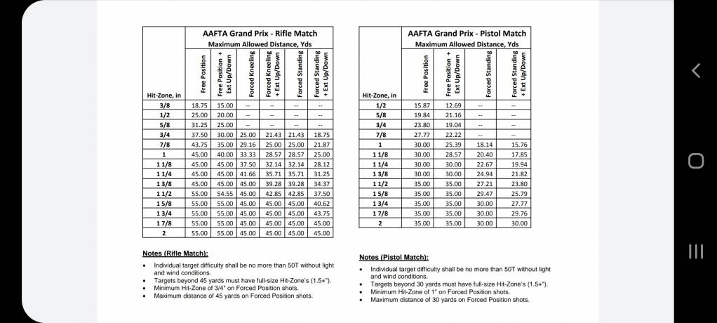

EDIT - good old Wikipedia helped me answer this. Does this sound right? And yeah, these are some pretty wide ranges! :)
https://en.wikipedia.org/wiki/Field_target
The target kill zones have three standardised sizes, which are 15 mm (placed between 12-23 m), 25 mm (placed between 7-37 m) or 40 mm (placed between 7-42 m).
this is a screenshot taken from the aafta handbook on AAFTA.ORG
FYI, don’t be surprised if you run into some KZ/distance combinations that don’t adhere to AAFTA Grand Prix rules (listed above). Most local club matches are not an AAFTA Grand Prix event and are not obligated to follow those rules. They’re definitely a great guideline and they keep the matches fair. But the KZ/distance combinations are at the discretion of the match directors. They’re also good guidelines for you to use when practicing. If you want to get really good, practice on one size smaller than allowed KZ for the distance and then every shot that follows the rules will seem easier.

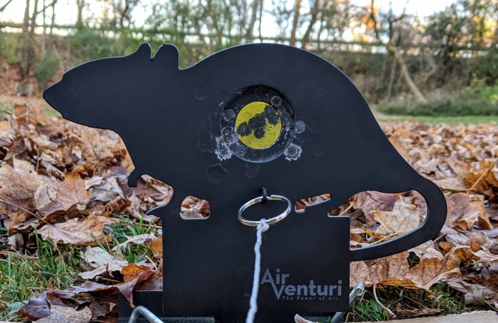

My thoughts are to work through at least a tin of pellets trying to find and get comfortable in this position. On average I'm able to knock down the target (medium KZ which is just under an inch) about 6 out of 10 shots at 25 yards. I have found it helpful alternating between shooting at the target and then shooting at paper at the same distance to see what shape my groups are taking. It's all good fun!
It's just getting challenging doing this as the average temperature is now dropping into the 40s and sometimes 30s.
Oh, here's the rat target I have been using:
