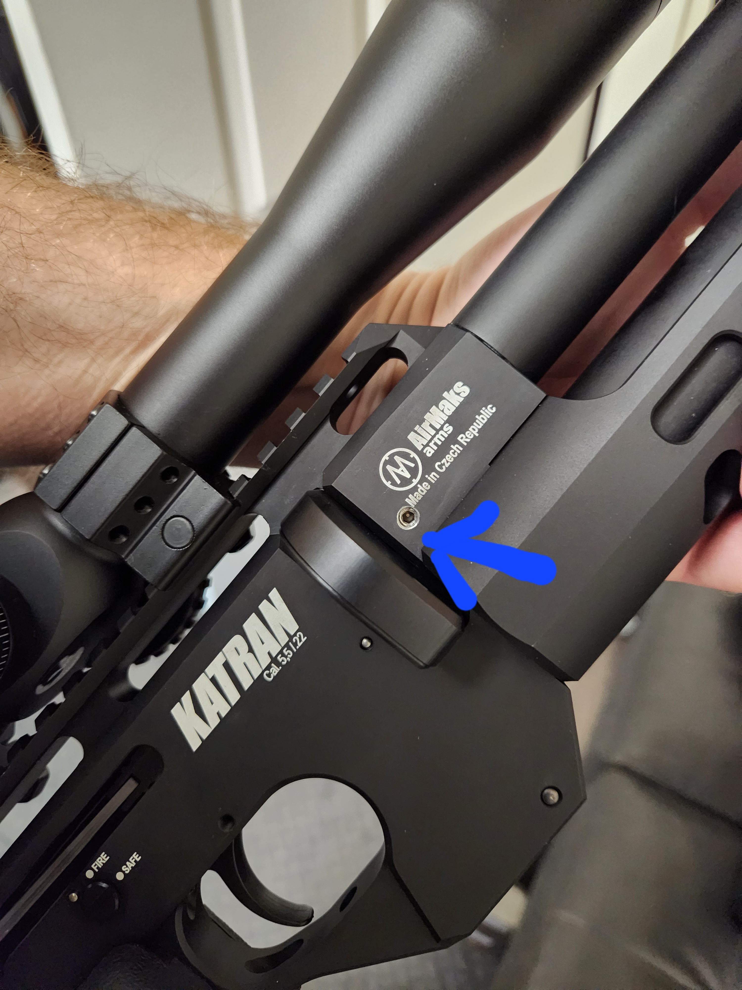

To accomplish this I put a 4.9mm transfer port sleeve and transfer port restriction adjustment screw. I turned hammer spring 1 full turn from max. Shot some string adjusted transfer port restriction. I then backed the hammer spring to just before spreads increase. The tone of the gun changed to a quieter subtle pop as it became more dialed. Hearing that reassured I was reducing excess wasted air and fps wasnt dropping.
