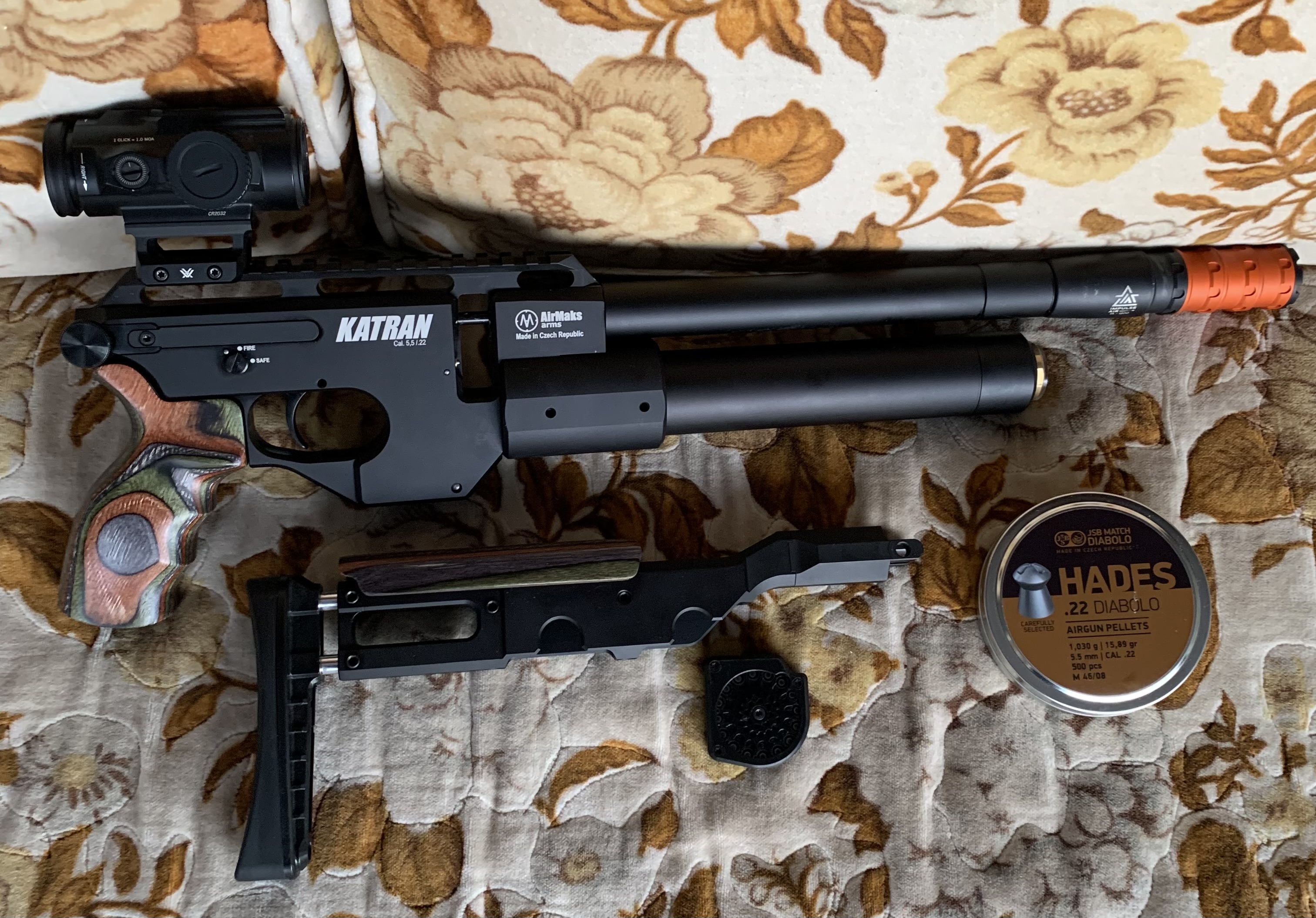

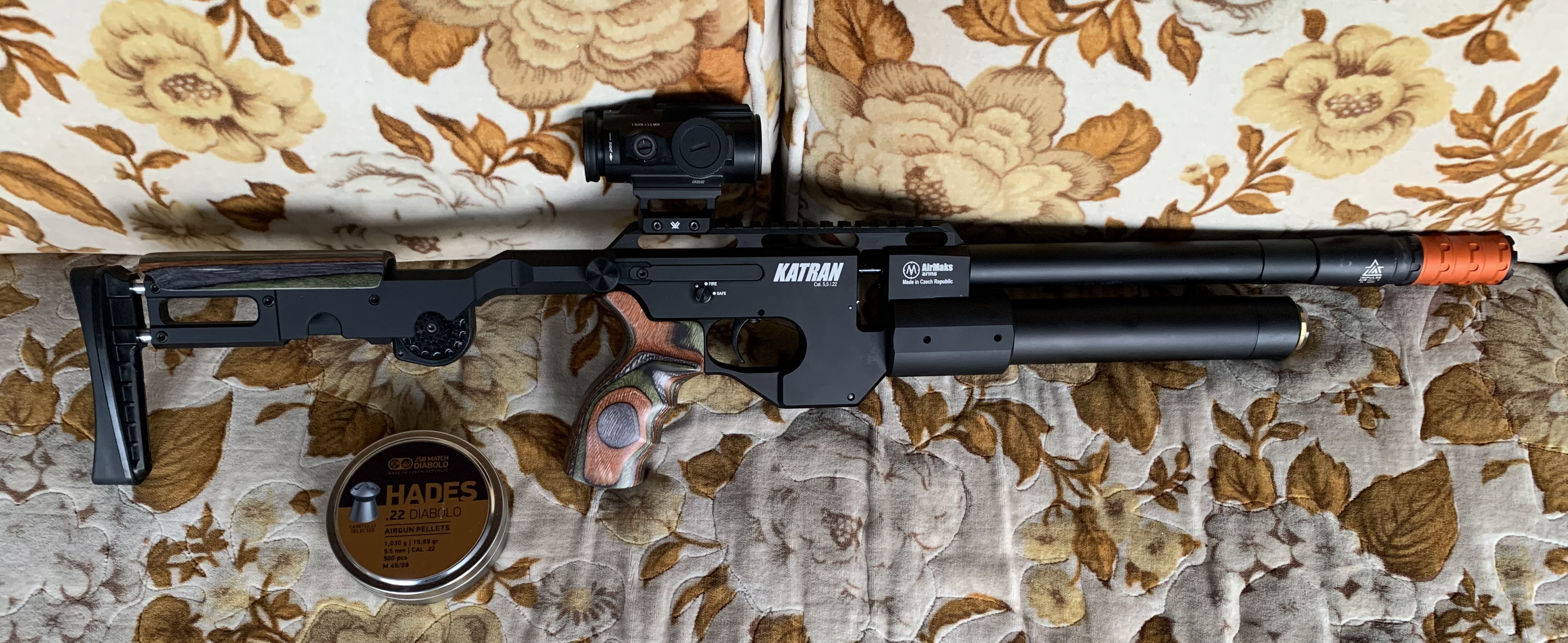

By way of intro, the SC is a subcompact Katran and this model is a 22. It can be setup as a pistol or carbine by way of a non-folding attachment that is magnetic and equipped with a grub screw to adjust so that it has no wobble, which works well. The air tube is 100cc and 300bar fill by way of the Airmaks probe. The pic rail is 20moa and the barrel is shrouded and equipped with UNF threading for a mod, which is necessary and this one has the IA1200, which is working well to keep it plenty backyard friendly. It’s also equipped with a Spitfire 5x that was modded to 50y parallax and that’s working pretty well for this config.
Pics setup as rifle or pistol:
Like other models in this genre, the KSC makes most sense as a carbine and not a dedicated pistol in the vein of the HW44, Ataman, or the godly GK1. However, with a laser, it will no doubt prove effective for pesting in confined spaces.

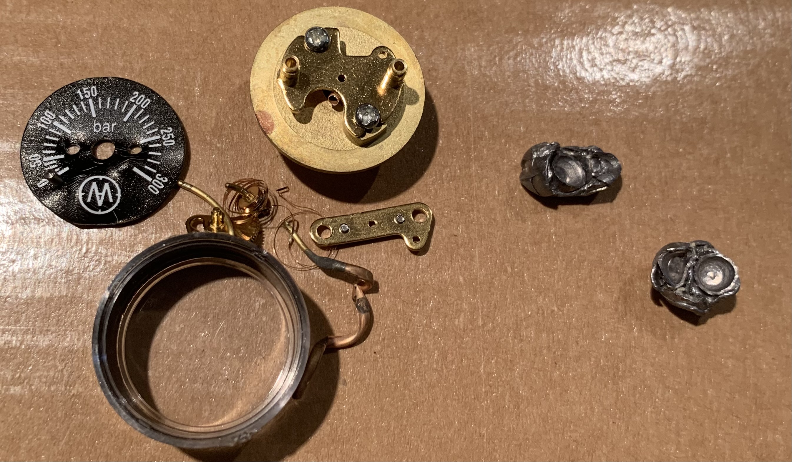

1. Upon filling for the first time, with a compressor, the pressure gauge at the front of the air tube failed catastrophically at 250bar. I wouldn’t call it a dangerous event but it was enough to give my neighbor (who is a PCP noob) second thoughts about becoming the owner. From my perspective, while I’ve never seen or heard of this, I know that the Airmaks gauges are flimsy. I once removed one from a Caiman and it fell apart. So, in this case, I replaced the exploded gauge with a Wika, which as you can see in the pics, is a little bigger and sticks out at the front of the air tube. I may put in a digital, but I won’t be asking for a replacement from Airmaks!

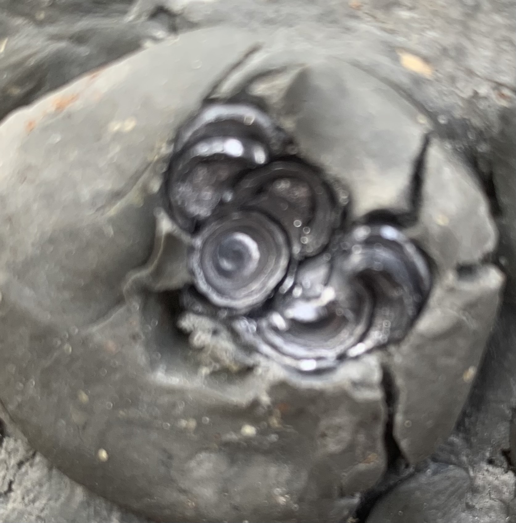

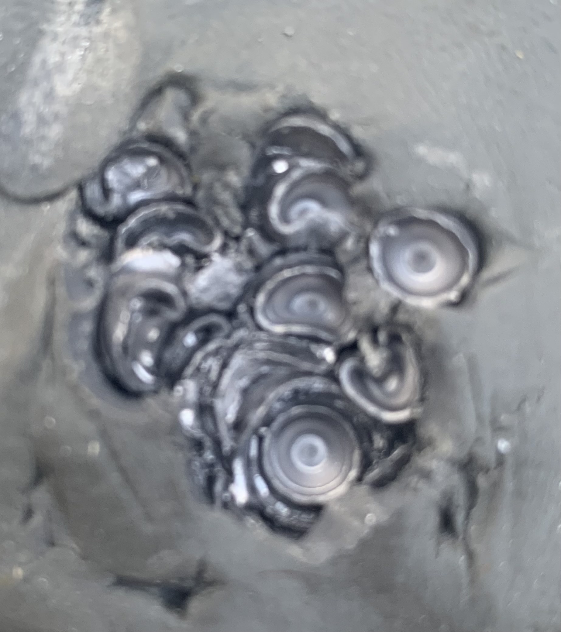

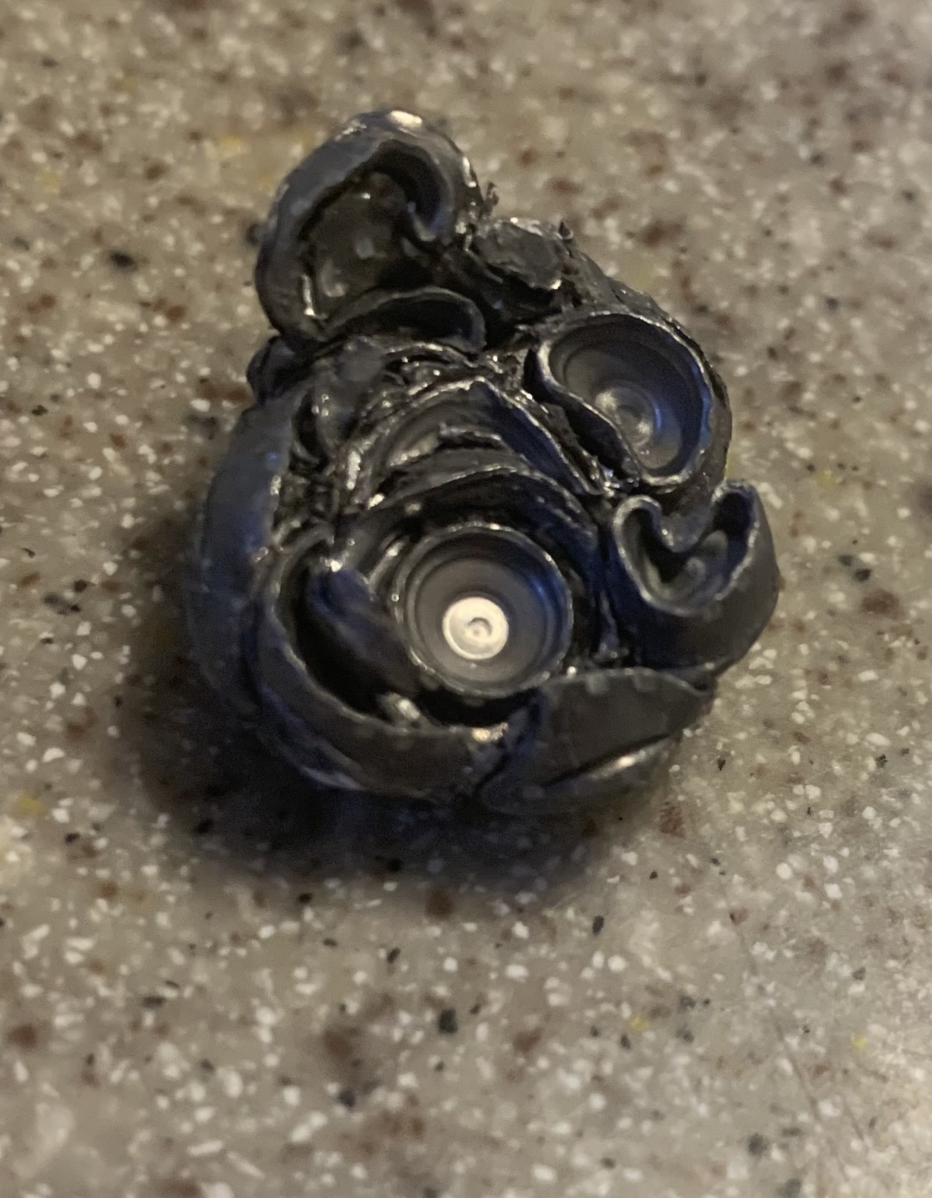

Spent the morning shooting a variety of lightweight pellets and didn’t find anything that grouped as well as the Hades. Then decided to push up the reg to see if any more juice could be squeezed from the tiny barrel. Pushing the reg to 125bar upped the speed at the knee to 728fps but the accuracy suffered. Dropping the hammer back to 710fps restored that accuracy. Encouragingly, the gun was even snappier and less noisy at 125bar, so I pushed it up to 130. Time to try heavier pellets. First out of the gate, the JSB 18.1s. Not good enough. Next up, a couple H&Ns. Going in the wrong direction, accuracy wise, but the shot cycle at 130bar was noticeably better. Really crisp and quiet. Took the dog out to think it over and then came back to survey the lesser-used pellets at the bottom of the drawer. Mostly too heavy or too funky, except for a tin of JTS 18.1s, which I’d used for a while in the GK1 before returning to GTOs. The stars then aligned in a big way between those JTS and the little Katran. Before getting to the accuracy, I’ll mention that I’d been having a few cocking issues with the Hades, strangely always around shots 4-8 from a full magazine. Nothing that led to a jam but on a few occasions I had to remove and reinsert the mag. No such problem with the JTS 18.1s - absolutely smooth. Also, I can feel a little more resistance as the pellet enters the breech. This is a good thing. The Hades presented little to no resistance and I couldn’t tell when the mag was empty. A couple useful bonuses there.
Tuning on the knee with the JTS 18.1s at 130bar gave an average speed of 718fps with the lowest ES so far observed. The extra weight quietens the gun down and increases efficiency, so I was still able to get 2.5 mags from 280bar to 130. 40 shots at 21fpe. I could tell from the chronographing that the accuracy was great, so I proceeded to put two full mags, running from 280bar to 160 into a duct seal block at 45yards. This little gun is staggering with these pellets!
Here’s the bulk of the cluster after removal from the duct seal.

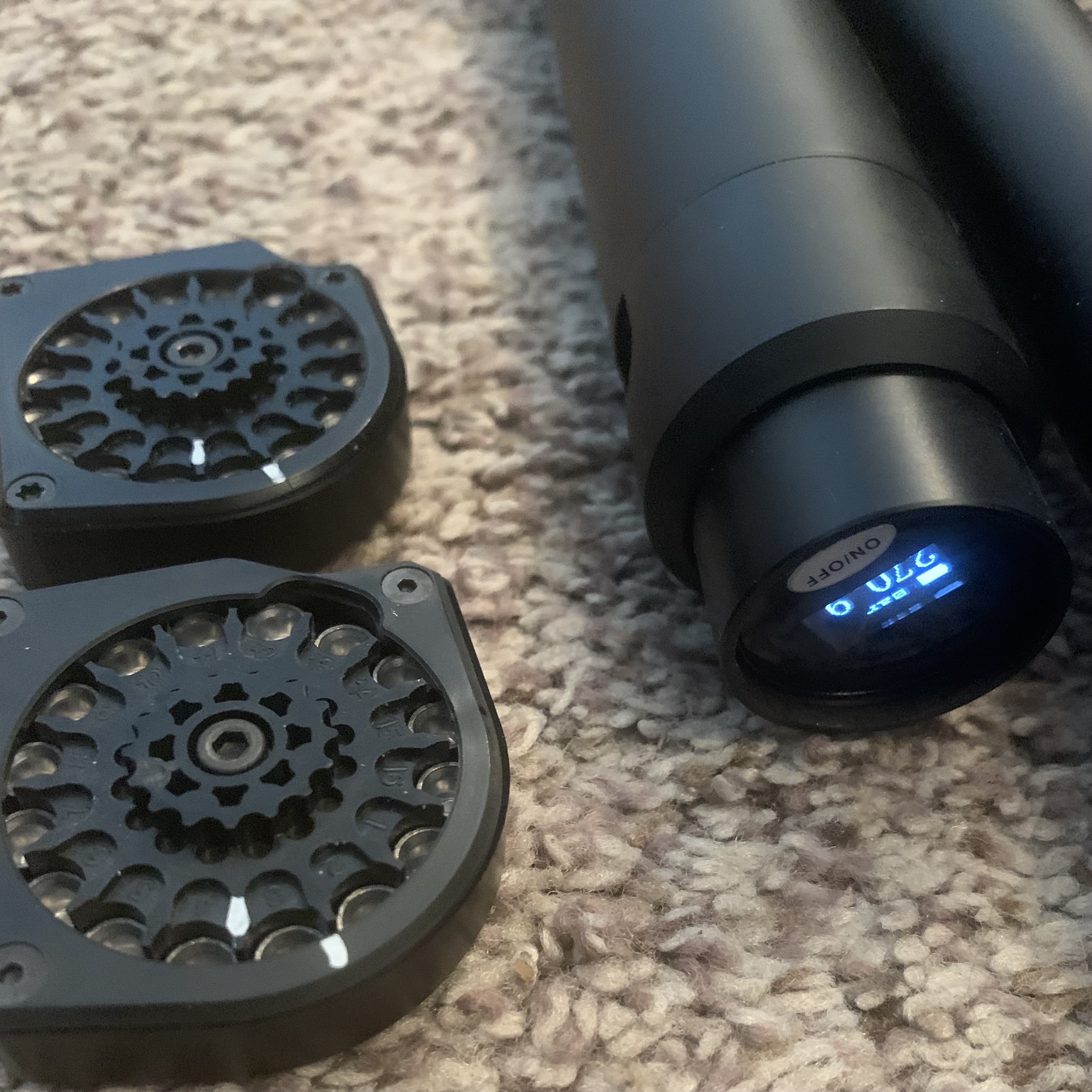

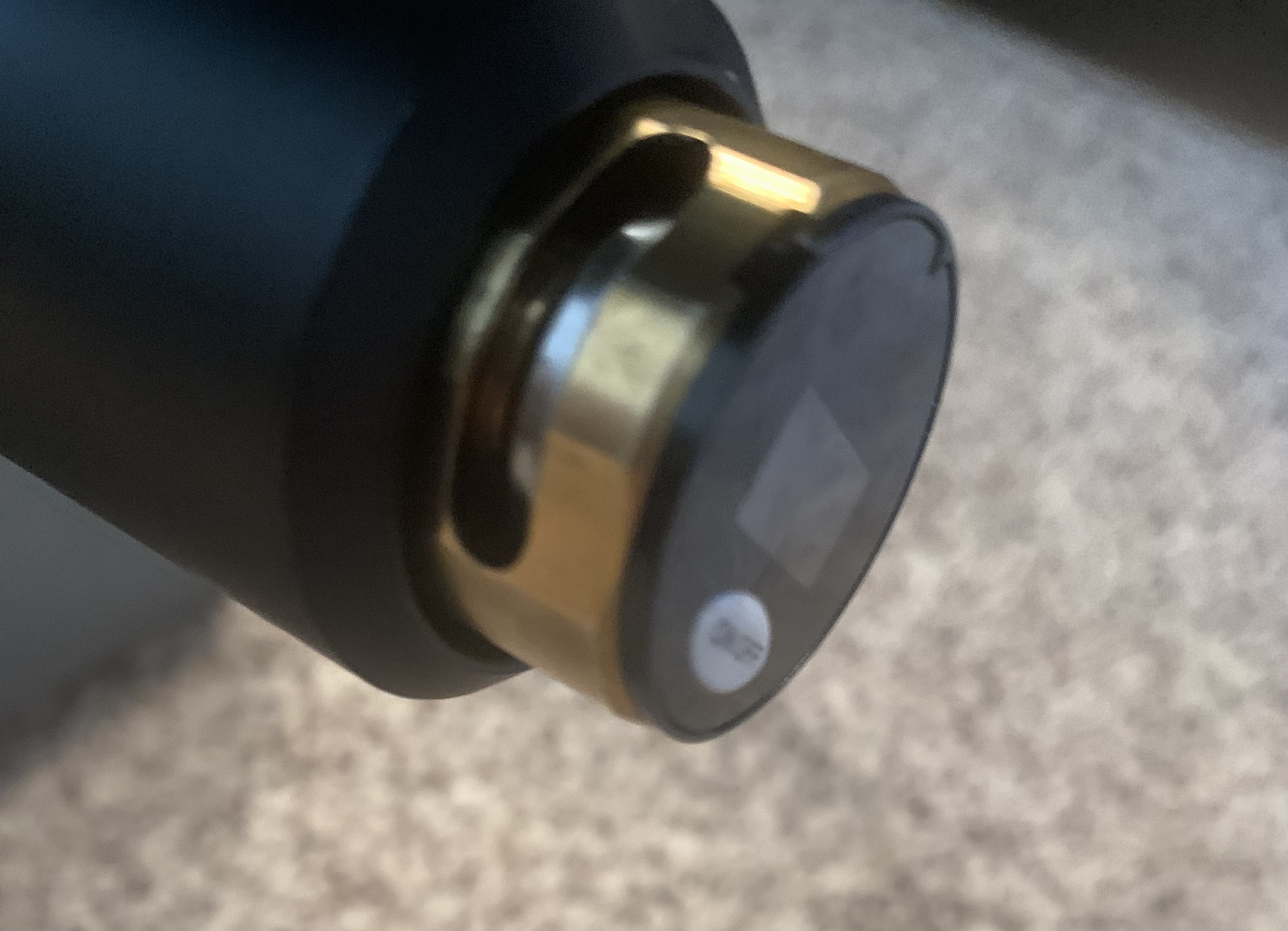

UA kindly replaced my gauge (with a digital) and after cutting the plastic cover down, I am very happy with it. With cover off, you can replace the battery without removing the gauge (it comes with 2 batteries) and I retain the ability to degas very easily by wrenching the gauge loose.
I also picked up an extra mag, which is working just as smoothly as the original with the JTS 18.1. My markings on the mag line up when it is empty because otherwise the gun will continue to dry fire. I hear that Carm mags fix that issue but you lose the anti double feed, which I like.

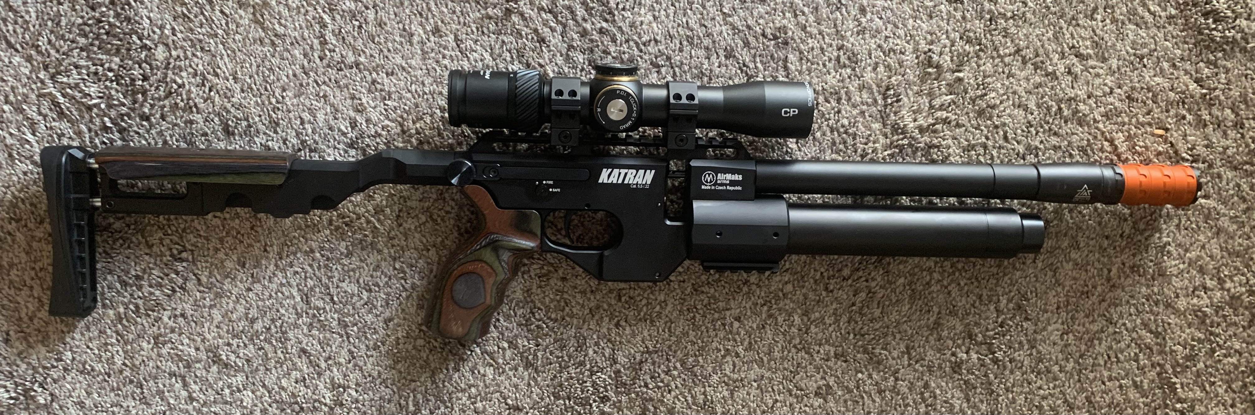

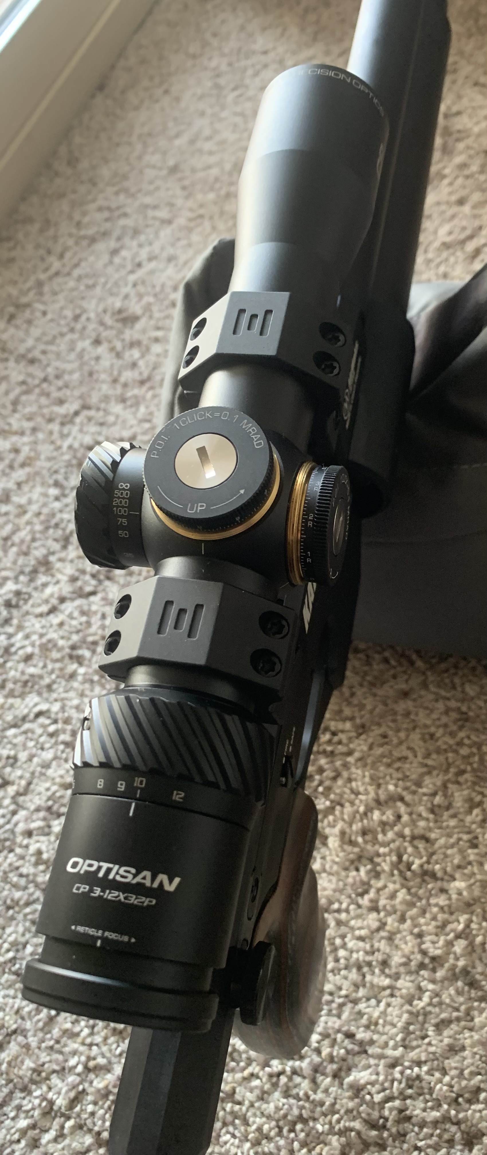

Now for the scope. Always a tricky decision especially if the gun is “special needs”. In this case, aside from the usuals (good glass, reticle, smooth/clicky adjustments, etc), it needs to be:
1. Compact and lightweight (for adventuring)
2. Minimum maximum of 9X, more than 12 is pointless
3. SFP, to avoid reticle disappearance at low mag
4. Open turrets preferred
5. Parallax down to very short range
6. The most tricky one - some level of use-ability at low mag in pistol config
Did a lot of research beforehand and decided that I didn’t want the compromise of a scout or pistol scope with low mag, often fixed parallax etc. it will spend 90% of its time as a carbine. Narrowed it down to the Hawke Airmax compact or Optisan CP2-12. A great benefit of living near UA is that I can try them out and the staff there are very helpful, knowledgeable and honest. They allowed me to put things together and test it out. This led to quick dismissal of the Hawke on the basis that the eye relief is really unforgiving. The Optisan on the other hand is way more forgiving than it’s specs would suggest - actually on a par with scout scopes at 3X mag. I also really like the reticle on Optisans and have three of their EVX fixed 10s on a Leshiy, Caiman and Huben. They hit the sweet spot for me between “clean” and “dirty”. The only negative seems to be that the turrets are capped. However, they look just fine with the caps removed, unlike in some cases where they look, well, kinda ghetto. They also have the zero reset and nice defined clicks.
Onto the mounting, I really want the scope to be as low as possible for the benefit of offhand use and fortunately the KSC has a pretty low and adjustable cheek piece. Optisan makes a nice unimount that I use with my EVXs but it has 20moa (and the KSC already has that, and certainly doesn’t need 40!) and I don’t want to add unnecessary weight. Luckily, I was able to get a perfect setup with some short Element rings. 1mm clearance for the zoom adjustment and just enough height for comfort with cheek rest in lowest position. Overall, after shooting 100pellets in different positions this AM, I am happy with this call.
Kudos to Airmaks for having a magazine that does not interfere with scope/ring mounting even with a ring right above the mag.

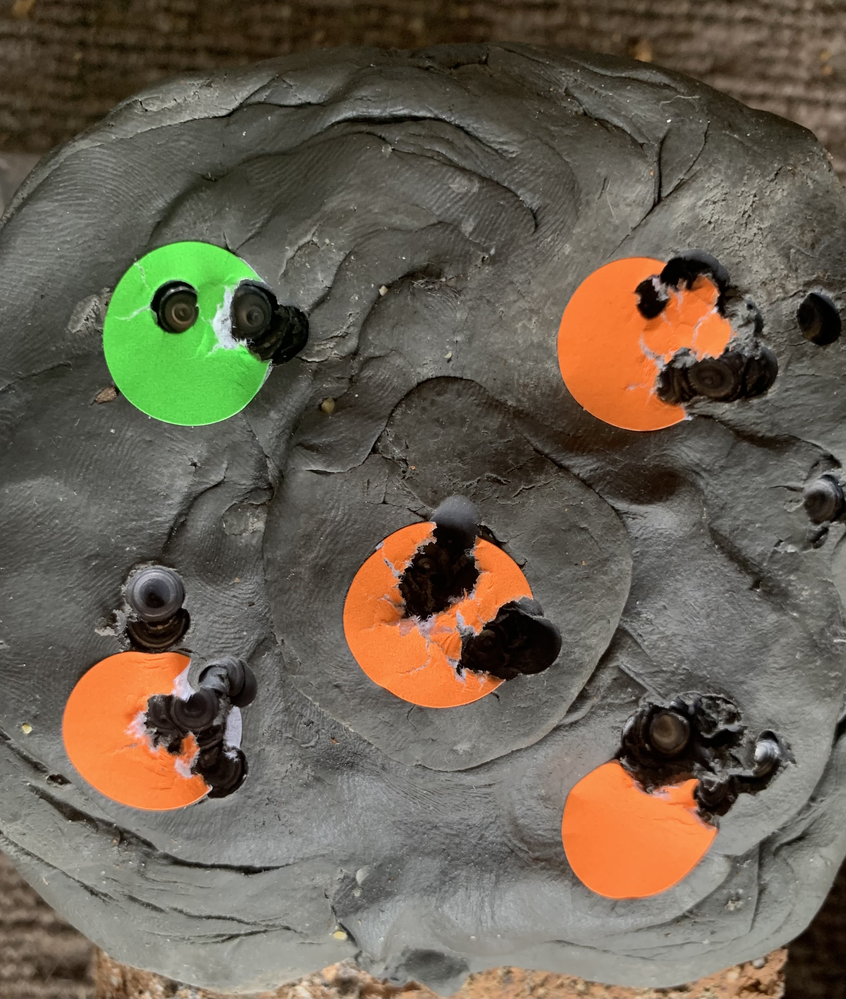

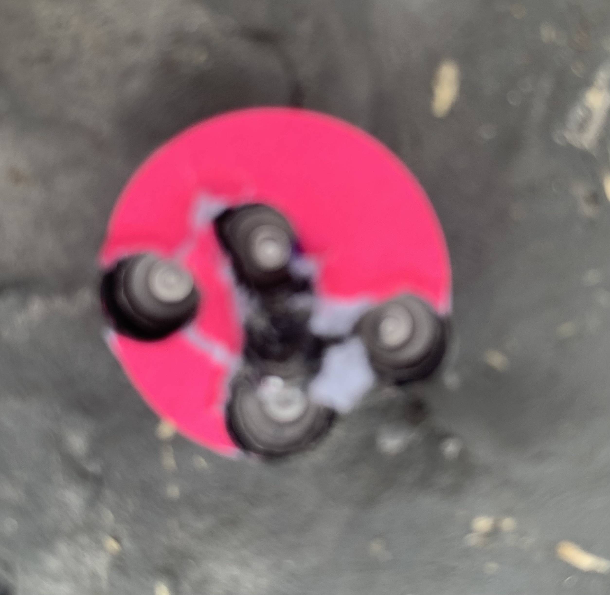

Some pellet testing with the current tune, which shoots JTS 18.1 at 720fps with stellar accuracy.
Initial test at 30yards:
Center circle was used twice. Hades at top and JTS 16.08grain at right. 5 each. Both great.
Upper right: JSB Express Jumbo 13.4 grain. The worst tested. Put in 10 to be sure. 2 flyers.
Lower Right: CPHPs. 8 shots. Not too bad.
Lower Left: HN FTT 14.6 grain. 8 shots. Pretty bad.
Upper Left: JSB 18.1. 5 shots, one flyer.
The Hades and FTT both had loading issues.
Looks like this Katran likes the JTS in terms of accuracy and loading. I tried the JTS 16.08 grain at 45yards and here’s a 5 shot group around 0.5in CTC and a 3-5mph wind. Looks like they shoot just as well as their bigger brother. I will run over the chrony later.
Would love to know if other Katran/Krait owners favor these JTS…
