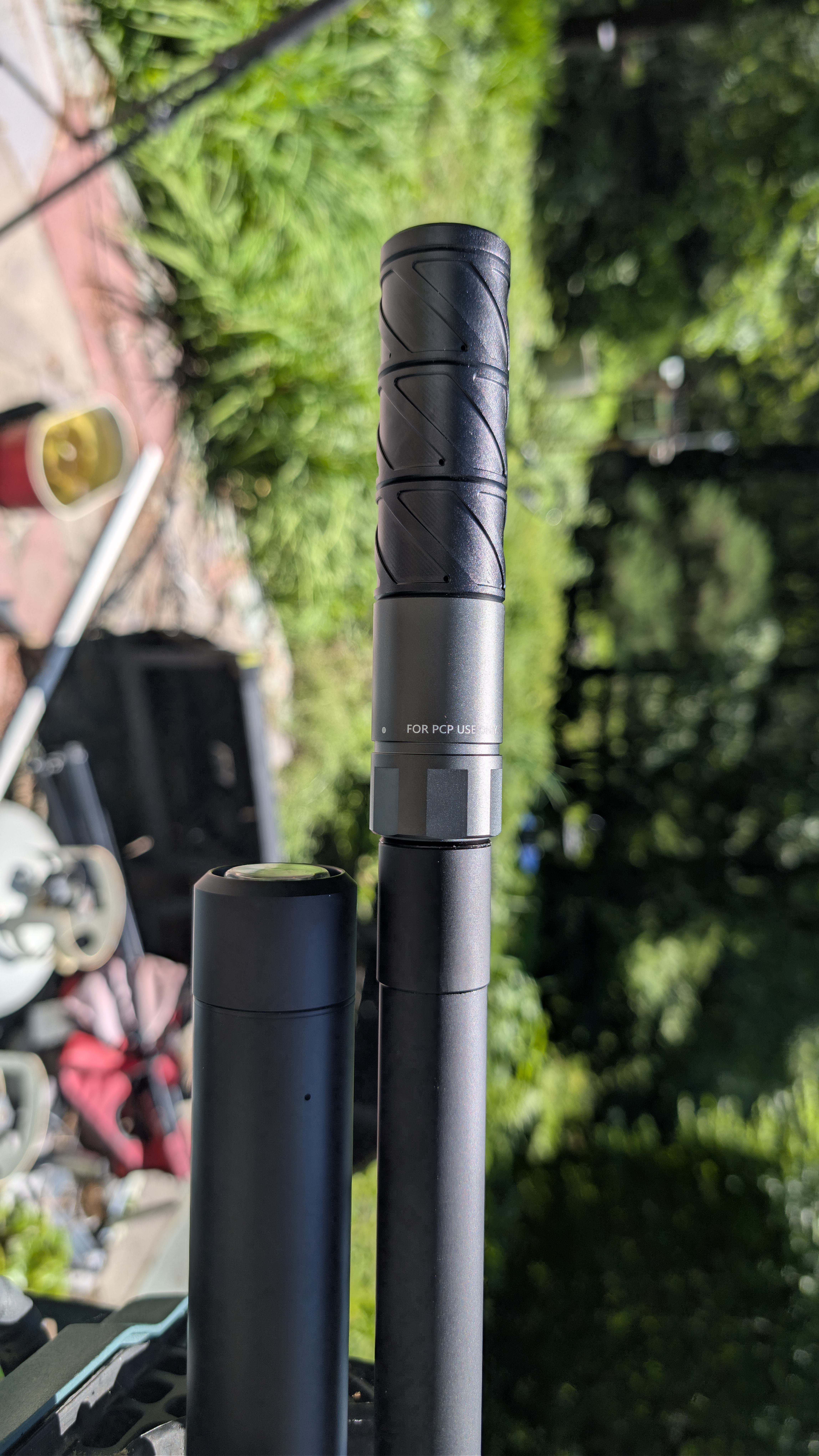

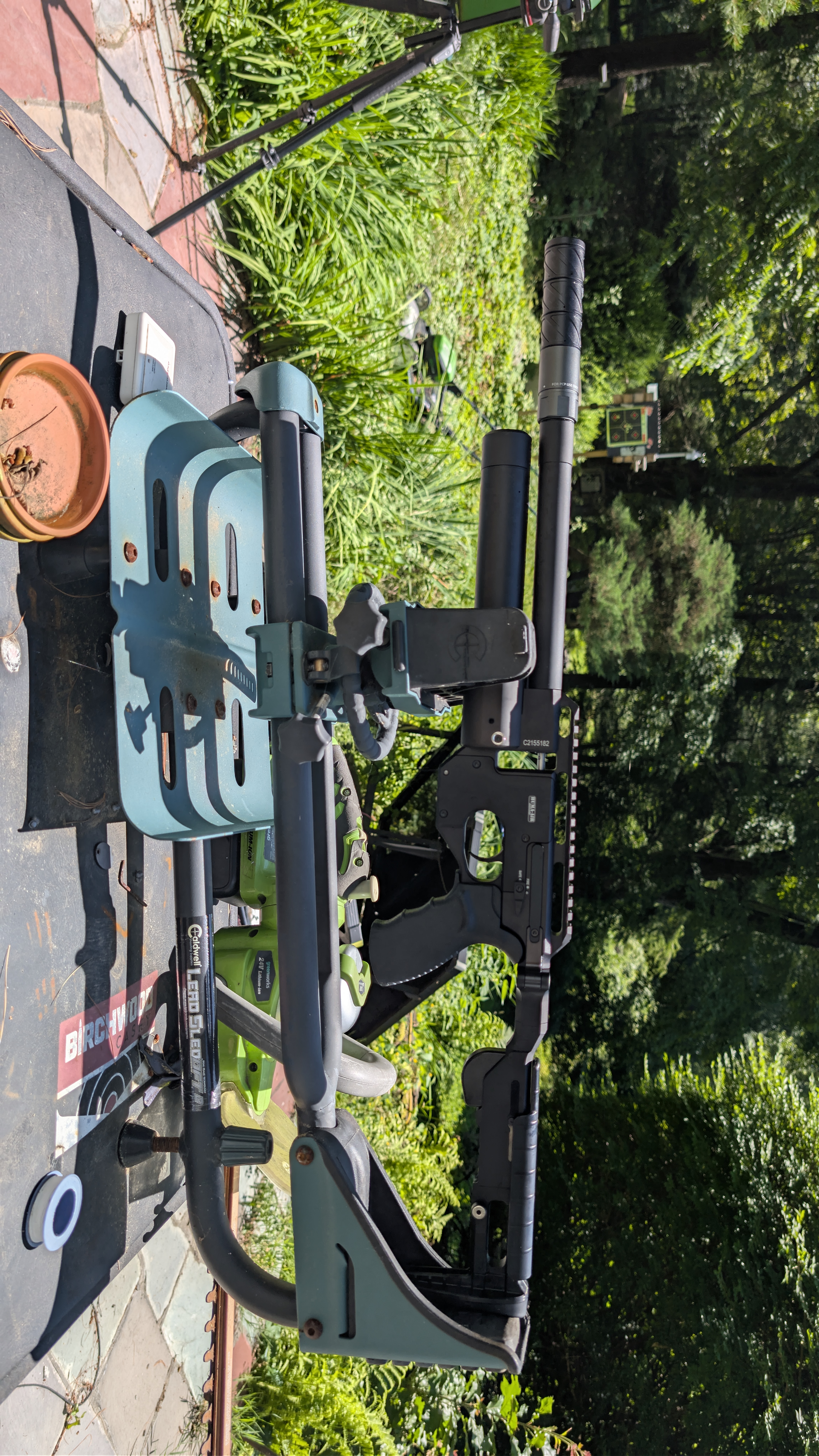

The Donny FL "FX" moderator. The tanto is slightly skinnier than the diameter of the stock muzzle device. Using both in conjunction really hushes the gun to a high extent, if you don't mind the gap from the airmaks 3 chamber mod to the tanto, it'll be just fine. I'm somewhat neurotic and it ground on me. The tanto gave me great suppression at 90b running 10.3gr at 890-900 to 115b running 13.5gr slugs at the same or higher velocity. If you plan to shoot at 30 I'd personally leave the reg alone and shoot 10.34s and 10.03 slugs. The gun will be near silent.
edit: keep forgetting "COMPACT". I don't know what velocity they're advertised at, but yeah, thats what the "L" model did.
