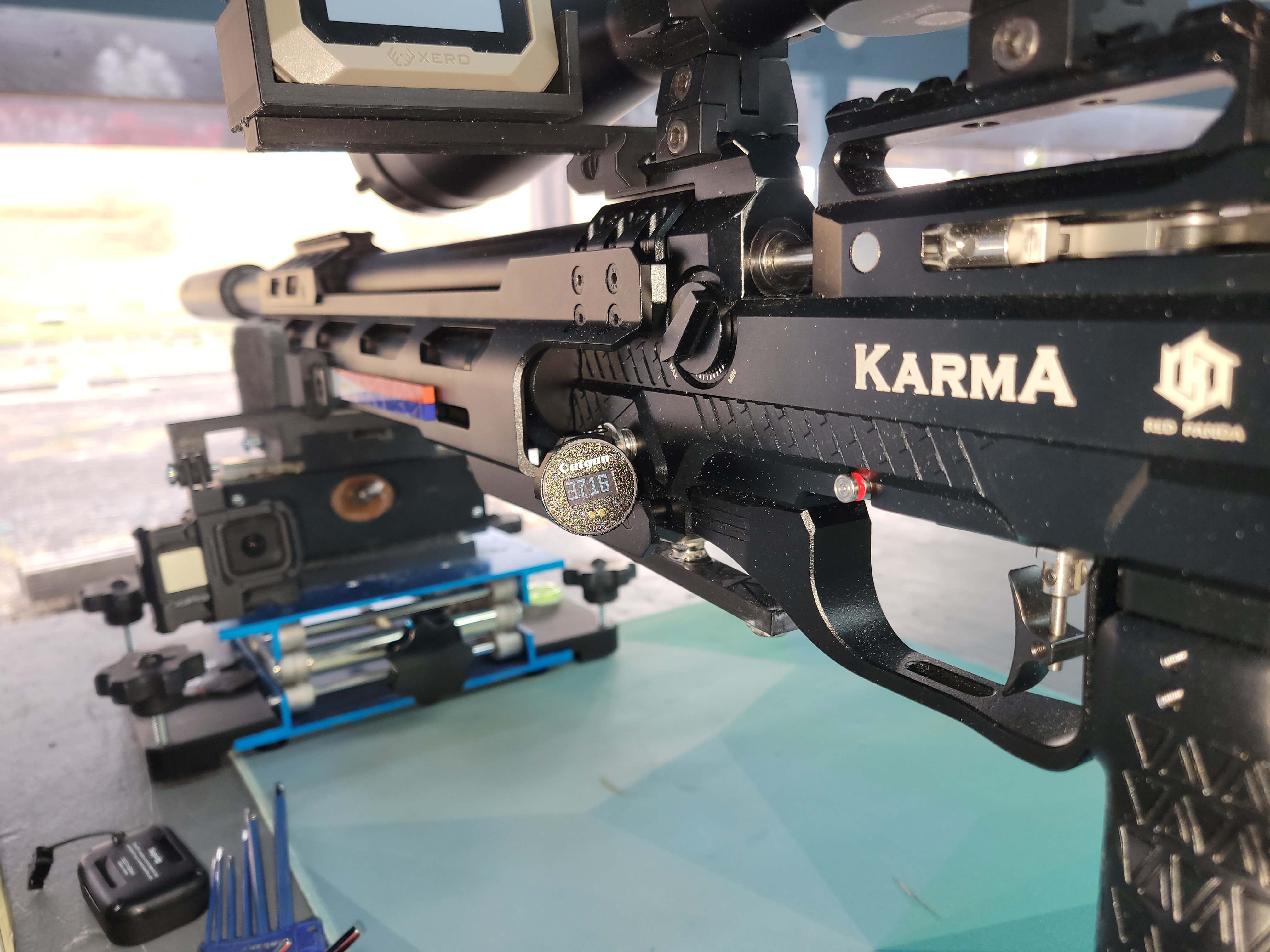

Good afternoon, went shooting today and notice that I have a regulator issue. When I start a slug testing session. I noticed that the second regulator will start falling off pressure when it's not tethered to a bottle. When the gun is tethered.
The regulator seems to work normal. When I get home and set the gun on my table. I notice that the regulator will creep past the original setting. Gun is in 22 caliber, SHOOTING THE NEW AIR MARKSMAN, 40 GRAIN PRECISION slug first regulator is wide open.
The second regulator setting 2600 PSI.
Any help would be greatly appreciated.
