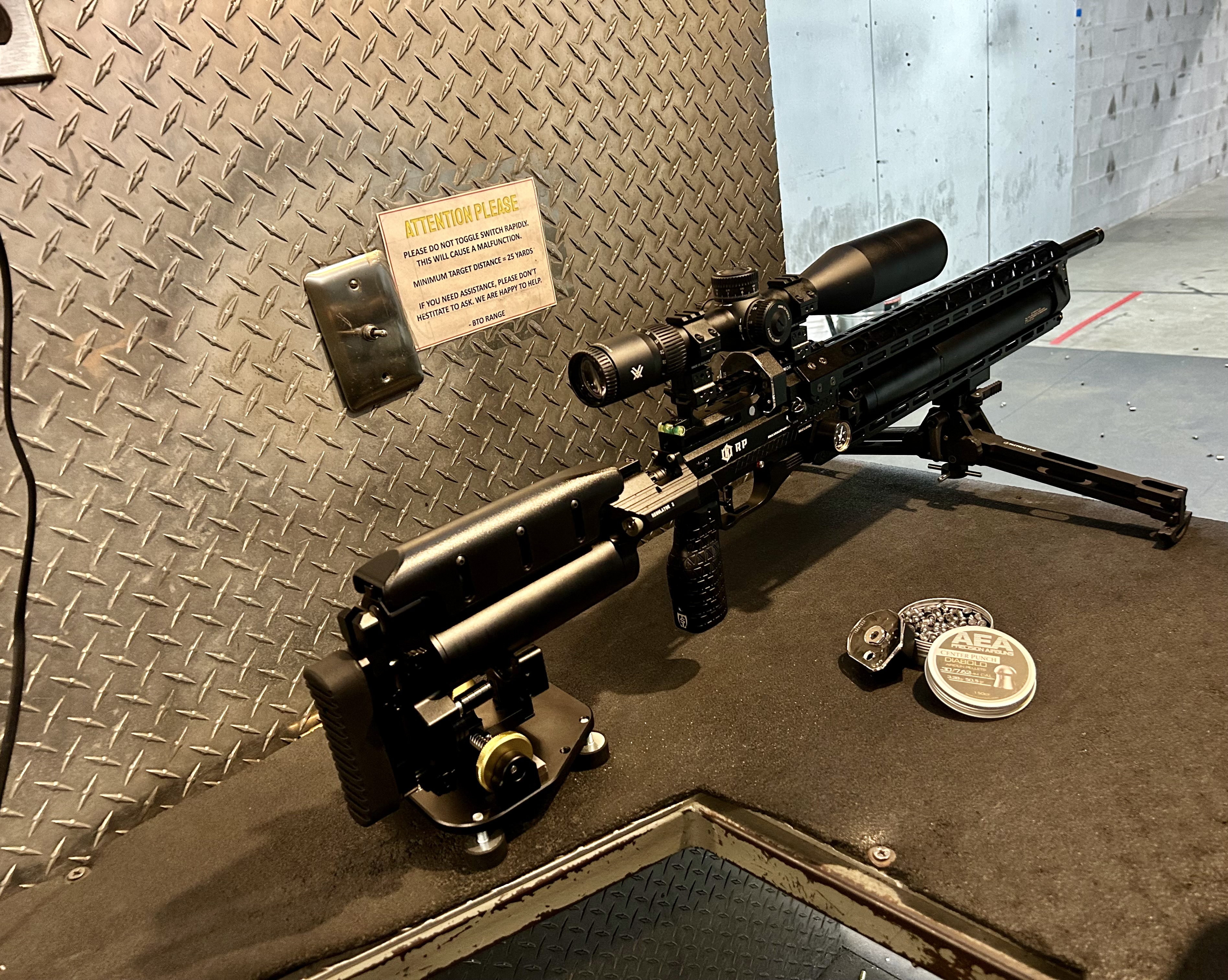

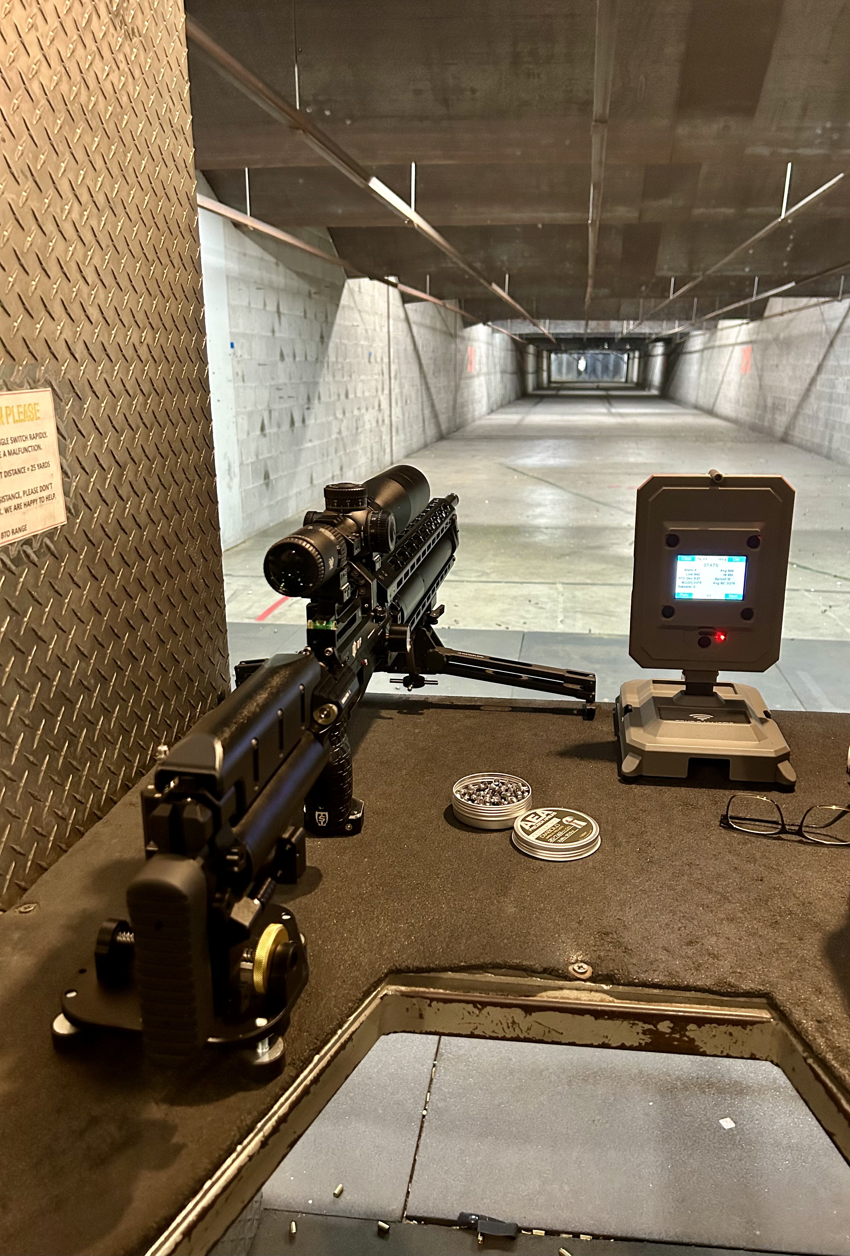

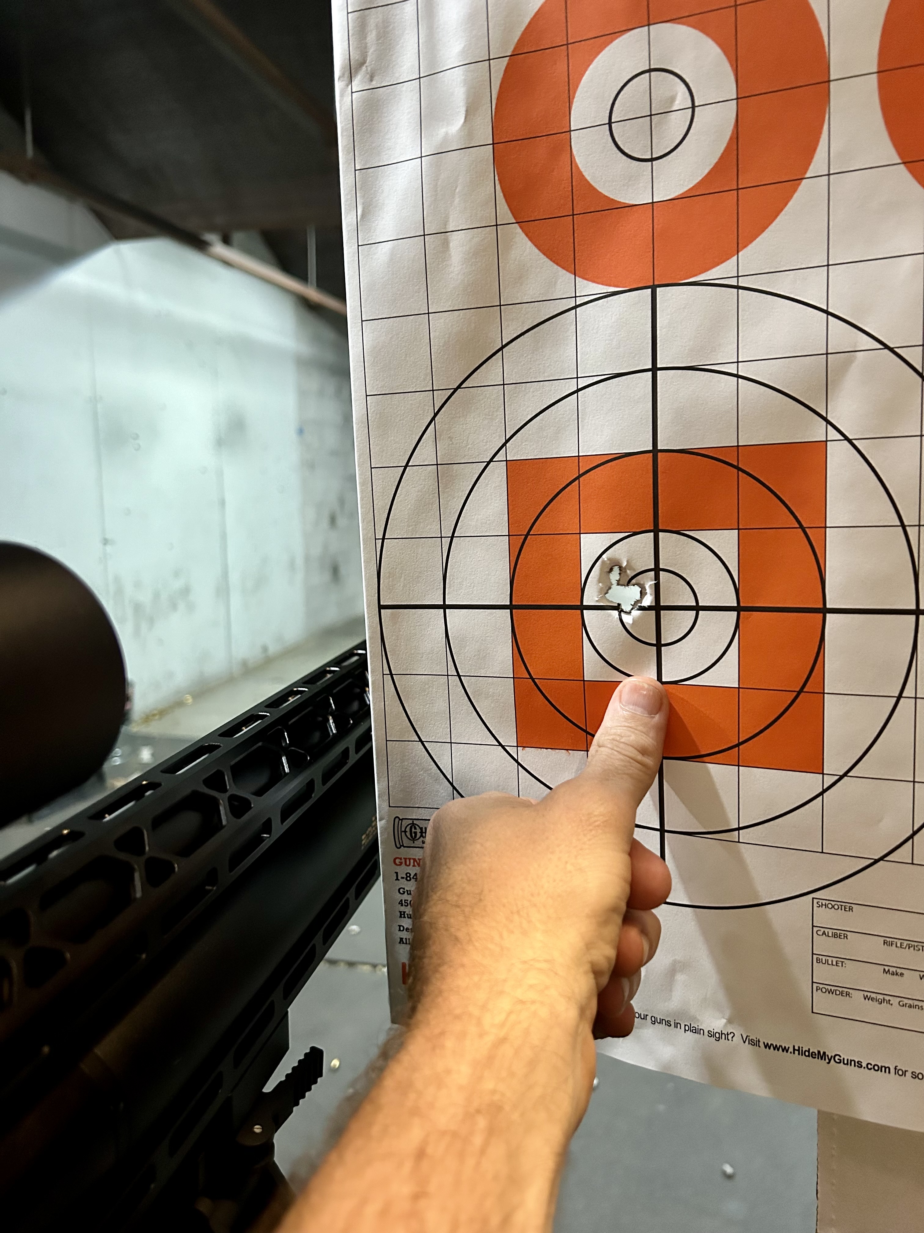

The gun can shoot! It’s very stable and obviously born for the bench. Upon arriving to BTO indoor range, I got sighted-in in short order. Sent the target to 100 yards and shot my first 5-shot group with it:
After bringing this back and seeing it, I knew things were serious!

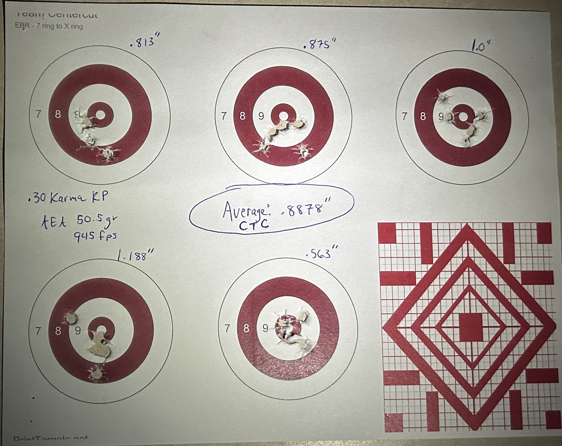

Okay, went for the proving ground; 5 consecutive 5-shot groups and pull average. Best my .30 Cricket 2 Tac has done is .97” CTC average.
.8878” CTC average.

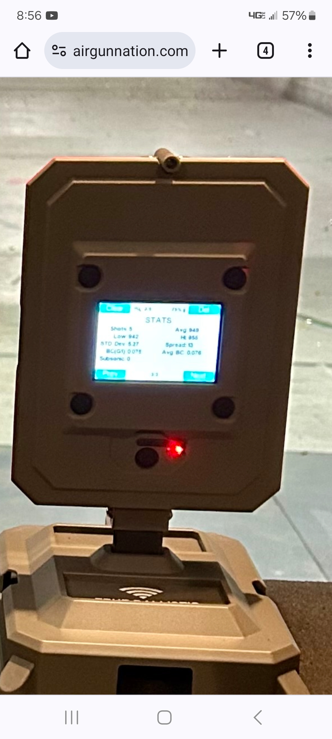

Yep, it was indoors. I’m sure all critics could have done much better. I am getting a very good BC with the AEA pellets. I look forward to the challenge of competition with this PCP. See y’all at RMAC 👊🏻

Ain't nothing wrong with that! .076 BC?! From a pellet?

Where did the 0.076 BC come from? I think he told me the avg was 0.072. Still pretty awesome. I get about 0.066 with my Delta Wolf from those pellets. I’m curious if it’s because I’m at 885 fps and Derrick is at 940 fps. I know theoretically from @Ballisticboy Miles posts, it shouldn’t change with speed if the profile is accurate for the pellets, but G1 isn’t even close.

Zoomed in AVG I thought looks like .076 but I could be wrong. Regardless very good BC from a pellet.

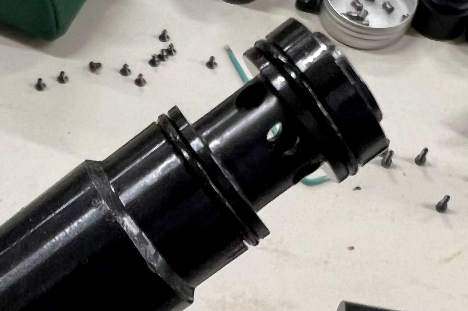

Downstream of the valve, you have a large exit port which can rotate and choke off flow. One you have it set to your liking, the Red Panda has a feature that locks the desired position of the transfer port. This adjustable transfer port sends unfolding air into a cylindrical chamber that surrounds the barrel’s 6 radial transfer ports.
Instead of feeding a single or dual port, it’s funneling into 6 ports. I hope I’ve explain that well enough.
The kind of port i have been asking for since i got back into airgunning.
rerally the single or dual transfer ports are so,,,,,, SIGH
Also i dont know if its just me, but feeding a pellet forward with a pin probe over a dual transfer port,,,,, that never feel good.
Back around 2005 we called then "spools" (ala ChrisK) and this can be done for any airgun. Designed correctly (and that is big) can increase both power and efficiency and that was w/out any adjustments available.
