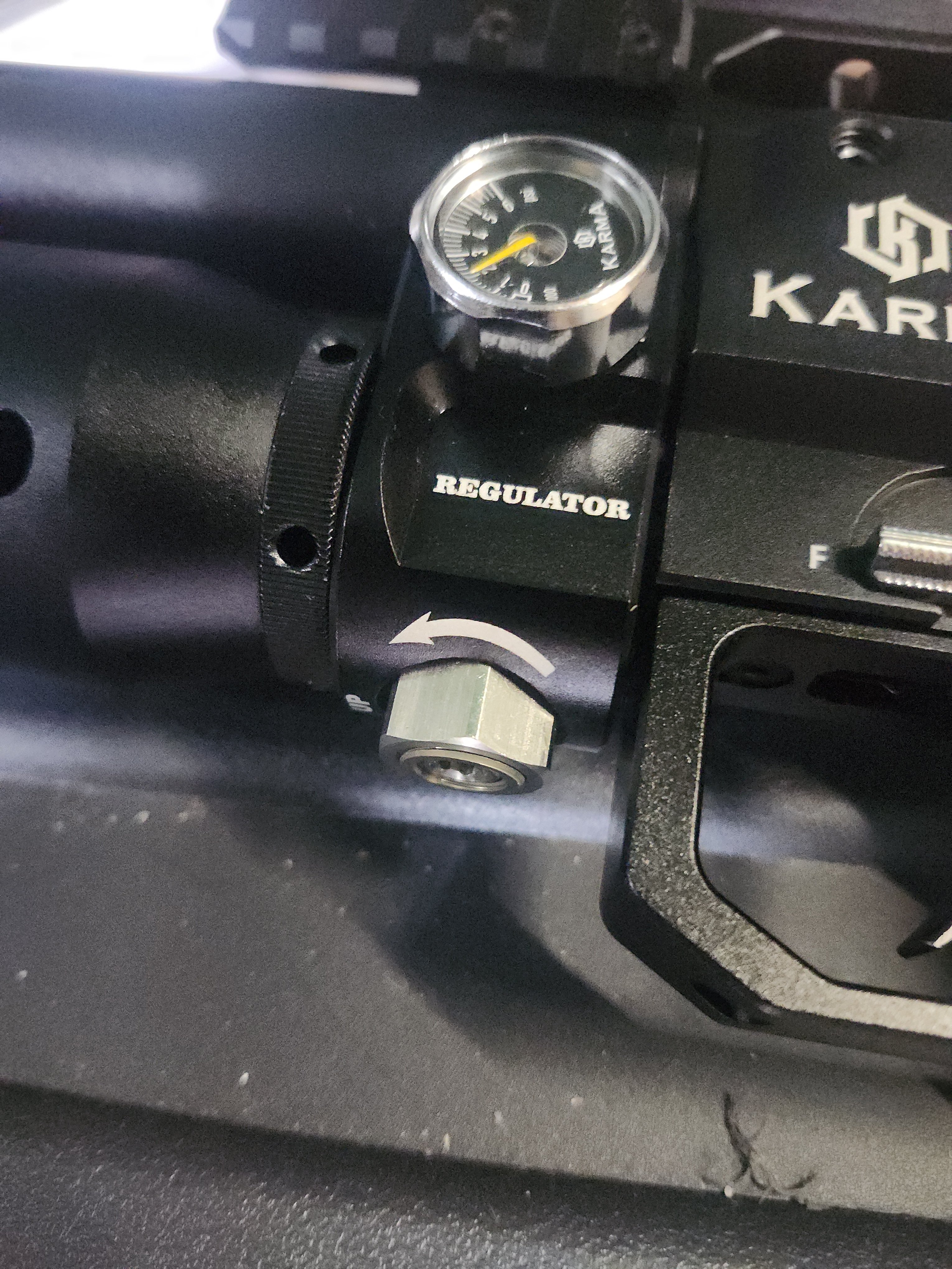

No, the reg can come out without affecting the plenum. However, the block that holds the reg is part of the plenum and valve body assembly. It has to be rotated to allow the reg to be pushed out...and it only rotates until it contacts the barrel. My reg barely clears.

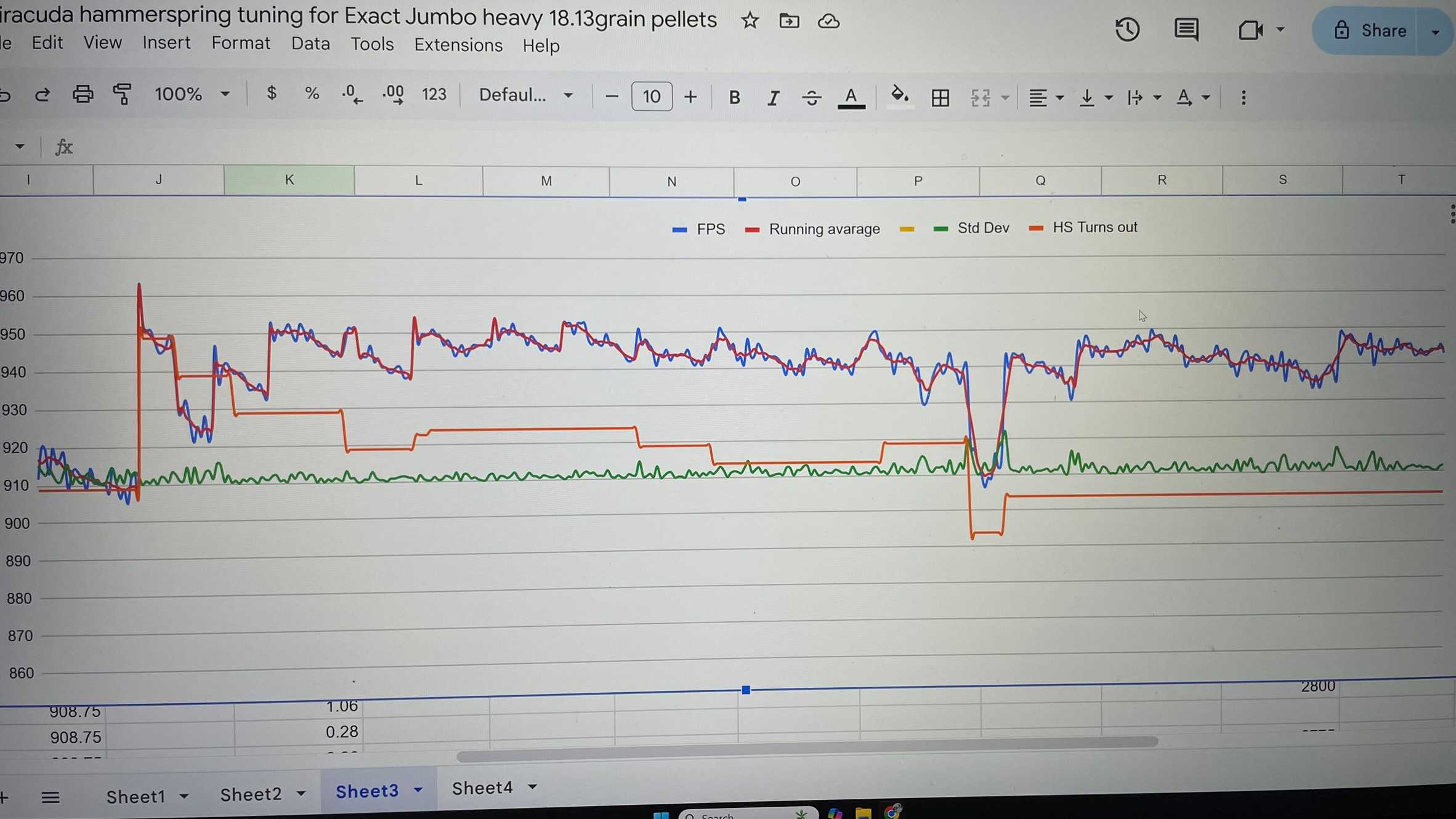

I understand. Thank you for the help…. The more I look into though I don’t think creep is the issue. Because it doesn’t move when I’m not shooting… rereading the terrible “quick start guide” they specifically say to dry fire 6-8 times after making a change to settle the reg. So I’m thinking this is just a quirk or known factor with this reg. On the flip side it’s nice to know that once it settles this reg really doesn’t want to move.
It is an AEA reg. but I don't know enough about them to judge. I followed the guide too but mine would keep creeping after the "settling" dry-fires. All good now.
Yeah and that’s why I think mine is just the reg settling because it doesn’t move unless I shoot it. Honestly now that I figured it out I like it even better. The barra tends to creep up so when tuning it I wouldn’t know the true reg setting for like a day after. It got much better after the reg butter though. I’m not affiliated with him in any way btw I just really really like that stuff. It’s hard to describe but everything about my 250z got better and “snappier” after I redid the whole gun with it.
