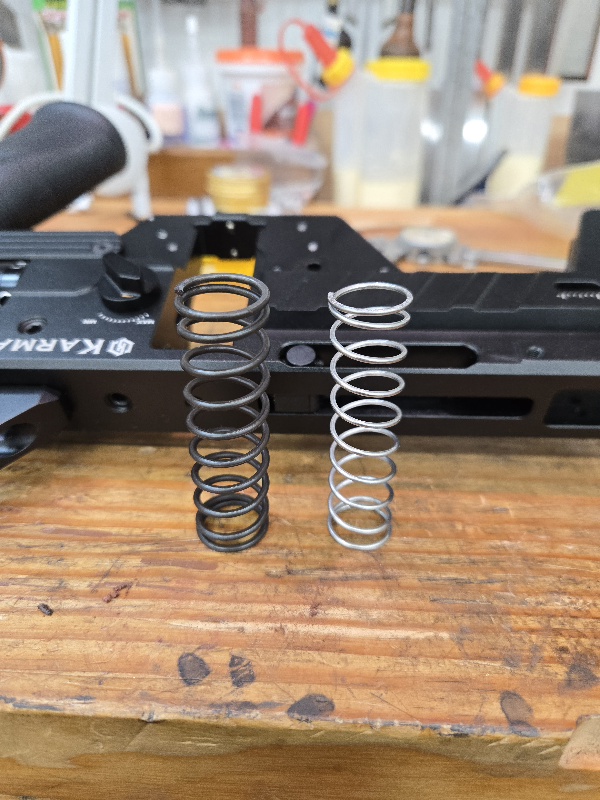

Is this the same area where you had the valve seat issue? Does this look like it could be tighten up?Tested a lighter Hammer Spring tonight...
Left is the original, right is same dia (5/8" ID) and length (2.75") wire diameter is 0.055". The original is 0.080".
Unfortunately, the new one is also stainless steel, which adds another layer of softness.
I installed the new one and it certainly proved a point...velocity dropped out the bottom, not registering on my chrono with it at its lowest setting. Cranking about halfway up the range finally got me on the chrono @ 450fps (33g pellet). At the highest tension, it topped out at 550fps.
This was all performed with a reg setting of 1900psi, which, with the original spring (at min), ran 870fps with the same pellet.
So...back to hunting a spring that is somewhere in between. If I can match the size, maybe a wire dia ~0.07" would get it done...and not stainless.
Of course, I can install a second spring inside the new one...back to the McMaster-Carr website!

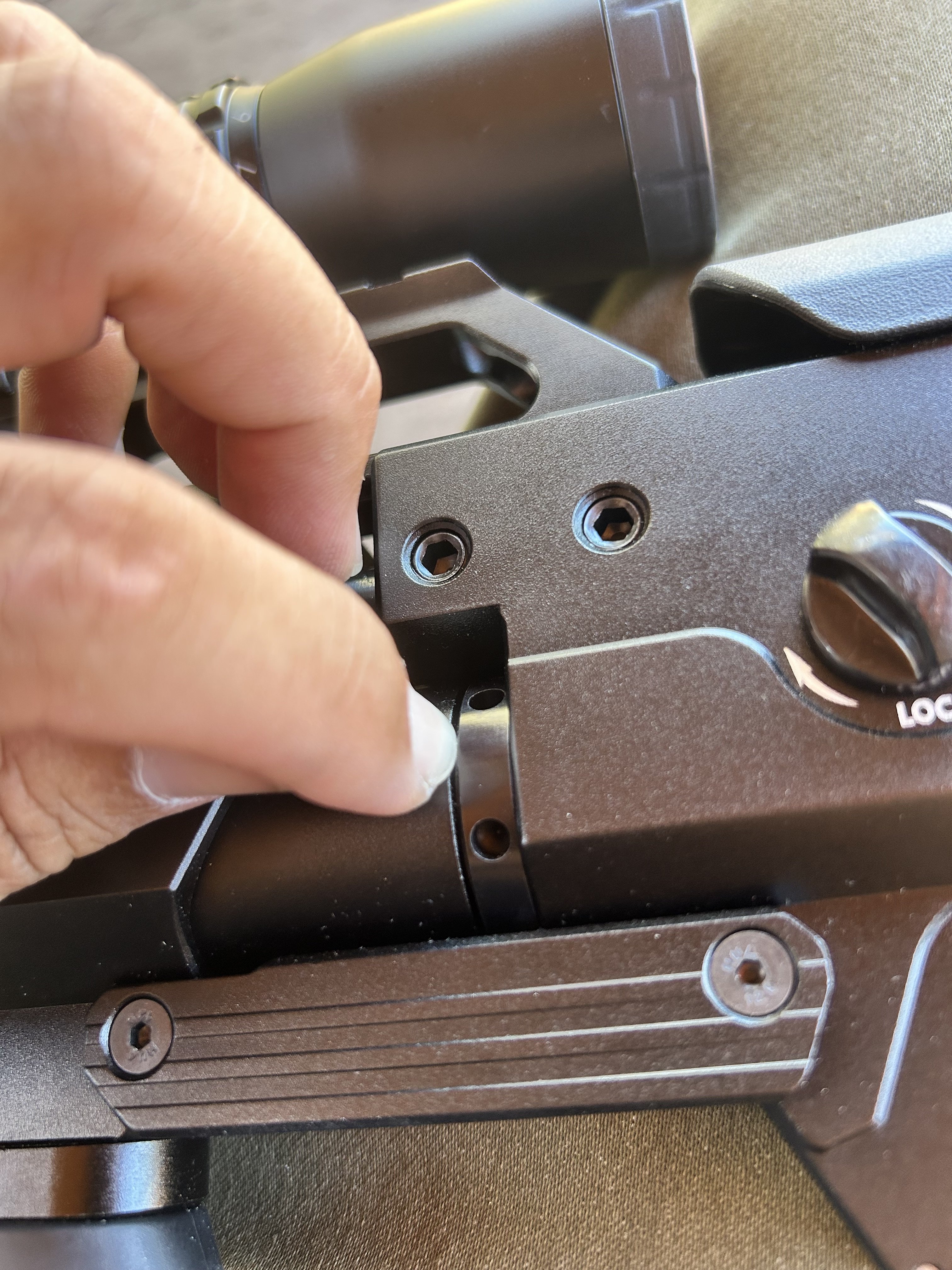

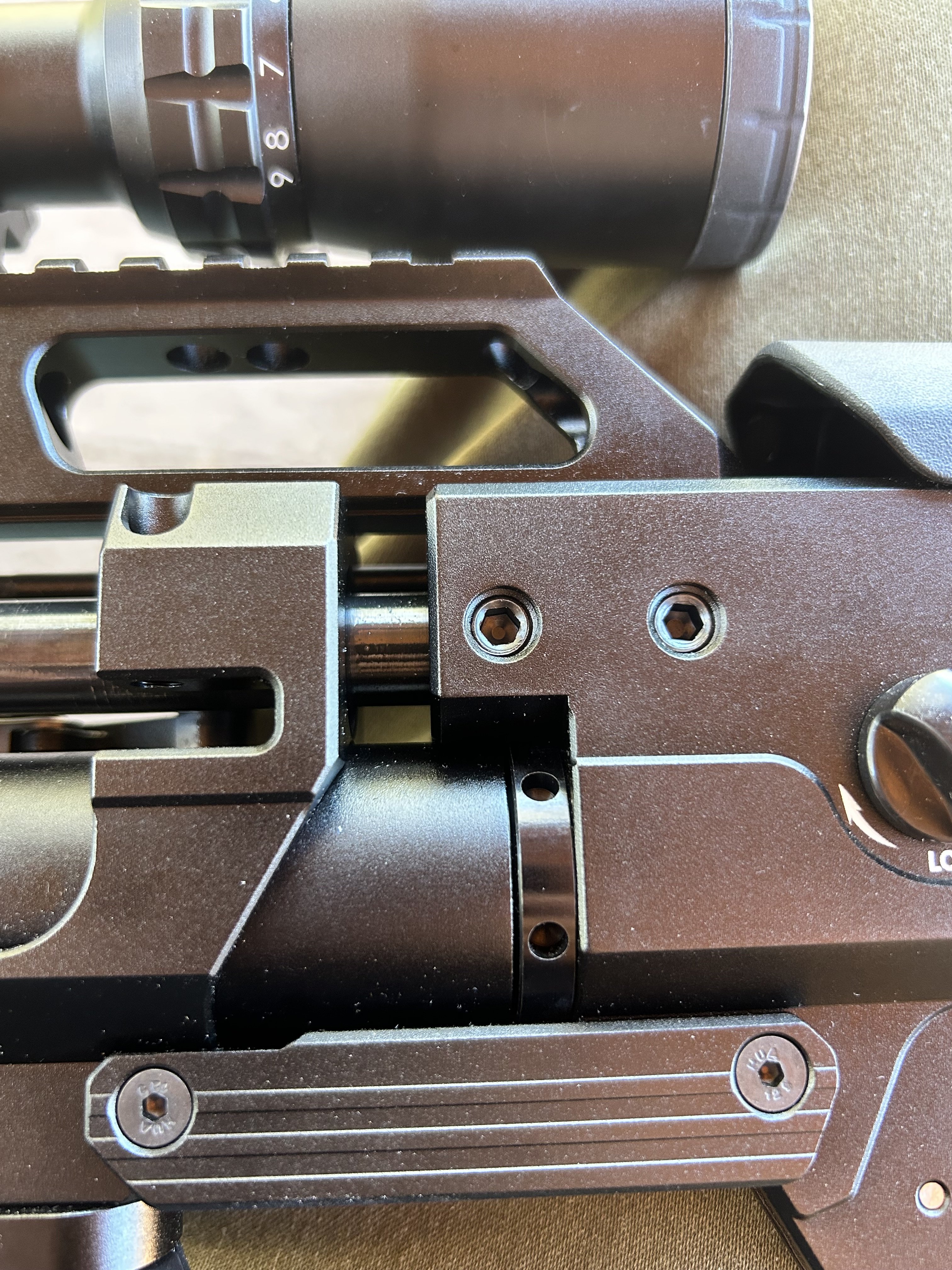

That's the plenum-to-valve body connection. There's an O-ring in there, so if it isn't leaking, there's no immediate issue.Is this the same area where you had the valve seat issue? Does this look like it could be tighten up?
I can fit my fingernail in the gap.
Ohhh okay cool. I didn’t think it was an issue but I wanted to make sure…That's the plenum-to-valve body connection. There's an O-ring in there, so if it isn't leaking, there's no immediate issue.
The other side of the holey part (the valve body) is where my gap was. That is how you coarse-adjust power...controls how far the poppet valve stem sticks out.
Very interesting, but that was the point that I think you were trying to make and that I refer the yes have a little bit too much spraying from the factory, but of course with use it’ll settle down a little bit and then we’ll have more adjustment. Maybe you should try again with a little bit lower pressure on the Reg. Maybe 1600 psi would do it.Tested a lighter Hammer Spring tonight...
That’s correct just think about it like the barber adjustment on an FXThat's the plenum-to-valve body connection. There's an O-ring in there, so if it isn't leaking, there's no immediate issue.

My point is to find a spring that is more optimal at all settings. I've tested the original from reg settings of 1100 - 3000...but that was before I figured out the valve body problem.Very interesting, but that was the point that I think you were trying to make and that I refer the yes have a little bit too much spraying from the factory, but of course with use it’ll settle down a little bit and then we’ll have more adjustment. Maybe you should try again with a little bit lower pressure on the Reg. Maybe 1600 psi would do it.
