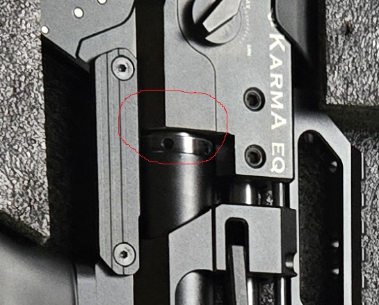

Well! I think I have solved the problem.
When I disassembled the poppet valve and body, the valve body was ~ 0.080" from fully seated. I'd noticed that when I got it, but didn't know enough to recognize it as a problem. Not being fully seated means that the valve stem wasn't sticking out far enough for the hammer to drive it fully open. Worse, it was loose, so it may have been moving a bit while the rifle was being shot.
I dug out a picture of the day it arrived back June 4. The circled area shows the gap.

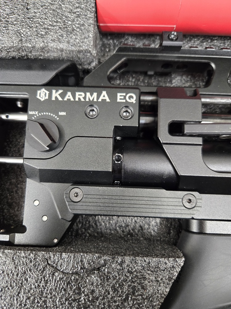

Here's what it looks like properly screwed in:
With it screwed in properly, I did some chrono testing...about an hour ago. At 1100psi reg, I got over 730fps...I knew I'd done something right. I hit 900fps at around 1900psi (.25 cal, 33.9g AEA pellets). First time this rifle has shown what it can do!
So, I aired it back up to 4300psi, set the reg to 2000psi and shot a magazine. Max 930fps, Min 903, 28fps drop, SD 7.94...26 shots.
