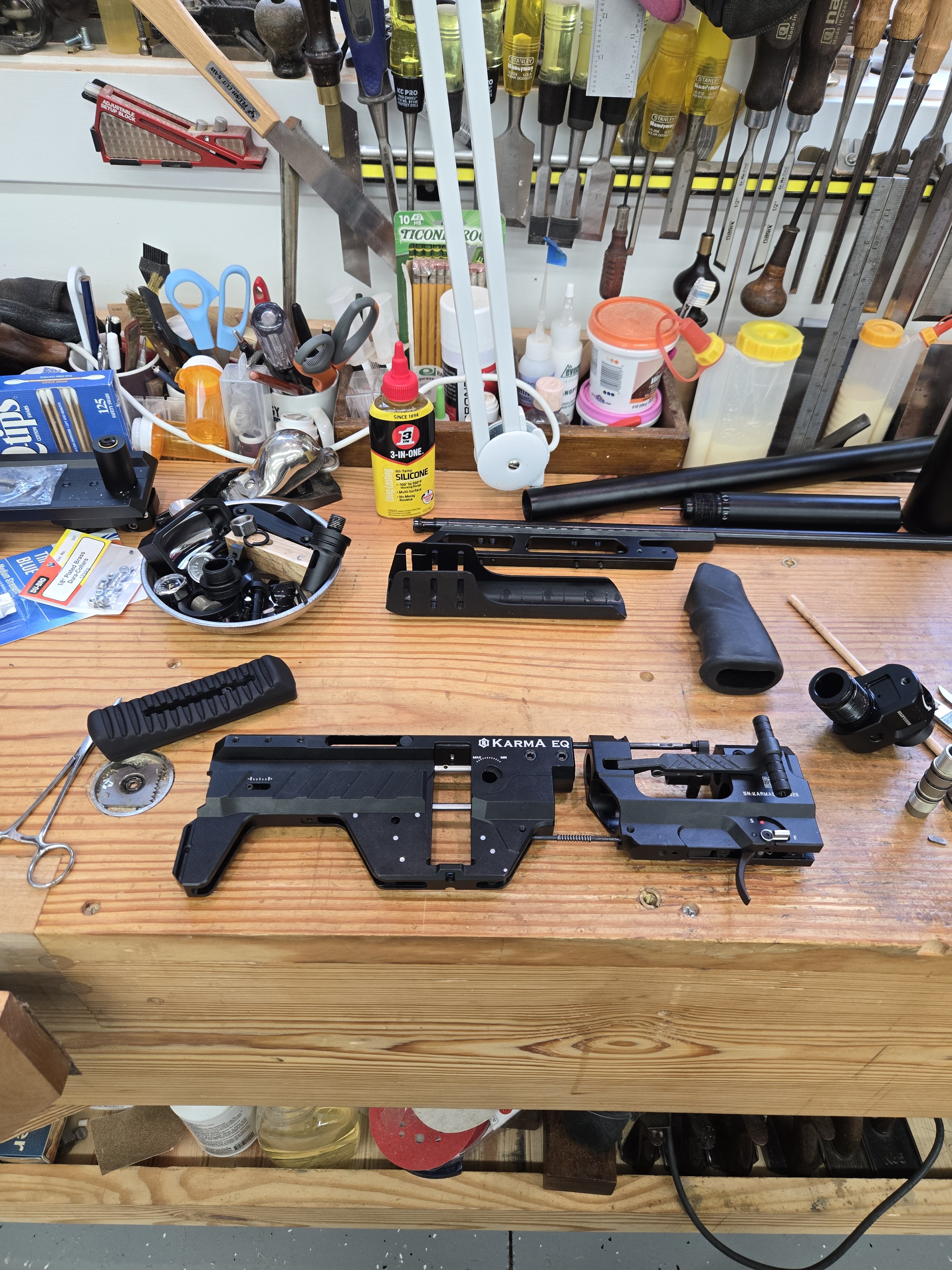

Yah...I tore it all down today. Very interesting build. Took a good bit of study to get it to this level.
I've been having screwy issues with the regulator...at least that's what I'm hanging my hat on at the moment. So...I yanked it out.
Actually, it looked fine (the whole rifle). Clean, no bad o-rings, well lubricated. The reg had some corrosion on the pressure bar (tiny little bar that sits crosswise under the adjustment screw. I polished it up. The nylon seat looked good too. I don't have a split screwdriver to get to the spring washer stack, so I just put it all back together. I'll test it and either its good or I'll make a special-tip screwdriver and try again.
At least I know how it comes apart and reassembles now!
The only "pick" I can mention is that the barrel screws were torqued down unevenly (one was loose). When I pulled the muzzle plug/shroud mount, the barrel was so tight to one side (at the muzzle) the damn thing took a lot of force to unscrew...and once it was off, I could see the muzzle was off center in the shroud.
In removing the barrel, I noticed the barrel screw issue...and going back together I took care to balance the torquing sequence, checking centering, etc. Now the muzzle plug spins out comfortably with my fingers. Might shoot better with less side pressure on the barrel too...
I've got it mostly back together...but I'm gonna work on the trigger tomorrow. I removed the e-clip from the trigger push-rod and replaced it with a 1/8" stop-collar (which has a grub screw). No more chasing that tiny e-clip all over the workbench and floor!
Seen one apart?

I had the opposite issue. My reg creeps down 200psi in just a few shots...and I can't get above 870fps with 33g pellets (it's a .25) no matter what I do.
I want to shoot slugs...but I can't get the velocity.

One of the reasons I disassembled it was thinking there was an obstruction somewhere. I could not get to 900fps, even with 25g pellets.
I need to recheck the barrel seating depth. There's a plug on top that allowed them to drill the transfer port. I forgot to check it yesterday. Although the barrel has 360° of porting, it is possible there's something I missed there. The transfer port adjuster is fine, nothing I could see there...but it acted like it was closed down.

I did get the reg apart, cleaned, polished...no more creep, solid from 1000 to 3000. I should get my Reg Butter soon. The washer stack requires a spanner screwdriver...which also should be here soon.
Still chasing velocity issues. At 1800psi reg (4300 cyl), I got just over 700fps with AEA 33.9g pellets. I went up in 200psi reg steps and at 3000psi, only 840fps! Transfer port verified wide open, ran the hammer spring thru its range...only velocity loss.
Am pulling the valve body today. There's gotta be a restriction somewhere.
"There's yer problem!"
Yup, the valve body/plenum wasn't screwed completely into the action. The picture I took when it arrived back in June shows a distinct gap...so it has been a problem since day one. It took a lot of larnin' to finally figure it out. Of course, now I can disassemble/reassemble it in my sleep...which is pretty normal for me.
After reassembly this afternoon, I did some chrono testing. With the .25cal, 33.9g AEA pellets @ 1800psi reg, it now shoots 900fps. @ 2000psi, I was able to run a full magazine averaging 916fps with a max of 930fps. SD over 26 shots was 7.9.
I'm very much relieved. Now I can stop being a detective and get out on the range for some groups!

I woke up this morning and realized that the valve body seating issue isn't a "bug", it is a feature.
The valve body has spanner holes around its periphery because it is an adjustment. This is the "power wheel" of the EQ. Moving the valve body aft to "fully seated" = max power...and max air usage (meaning fewer shots per charge). Moving the valve body forward (using the spanners holes to turn the body in its threads) reduces how far the valve opens, regulating the volume of air available to the transfer port.
Now we have the full tuning suite:
1. Cylinder pressure
2. Regulator press
3. Power valve
4. Transfer port
5. Hammer Spring
