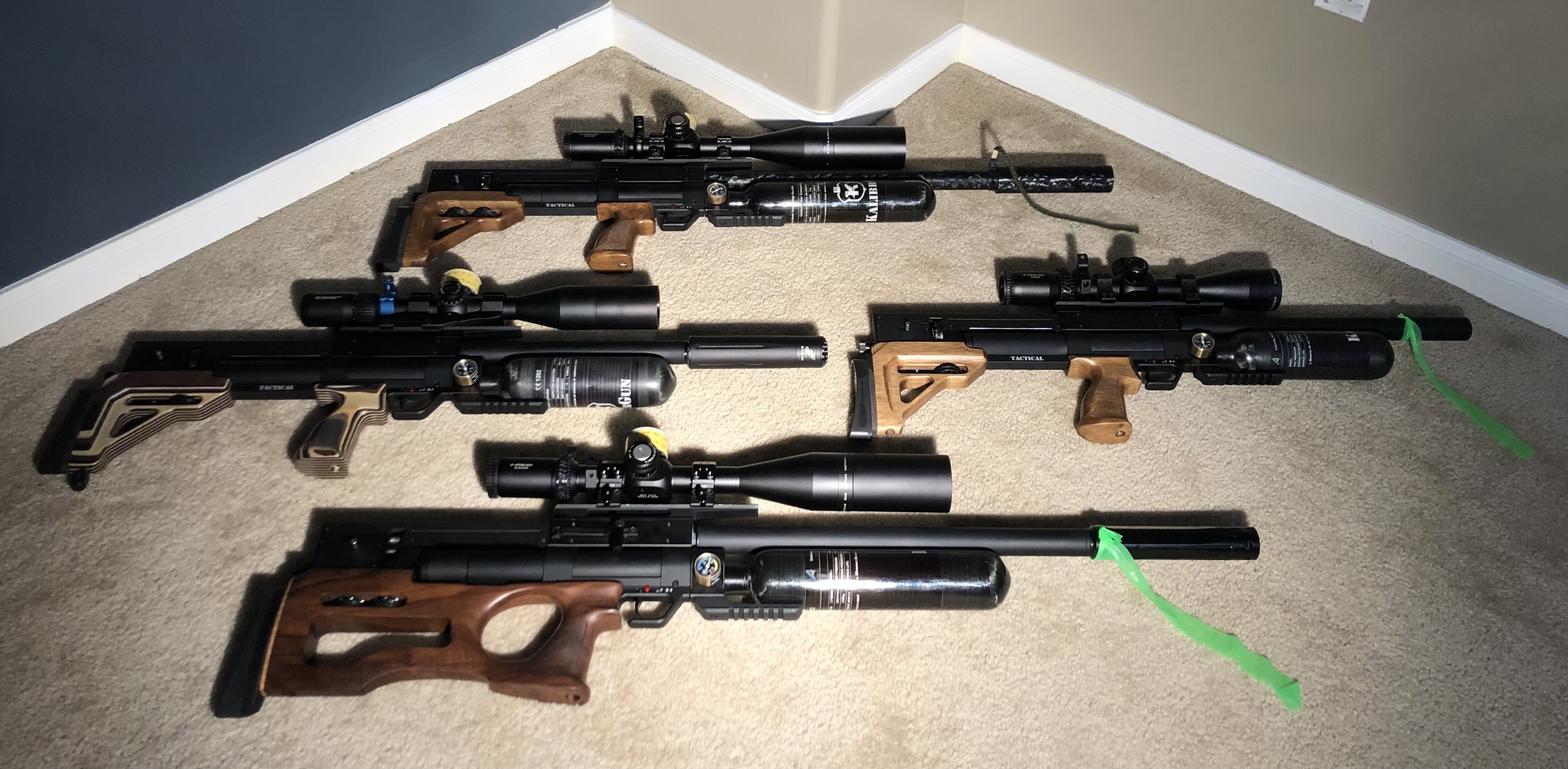

Exactly what Derrick says above. I’ve owned over 10 Crickets in the past 5 years. Every single one was very accurate and reliable. Easy to work on. I’d recommend the mini Carbine over the Cricket2.
