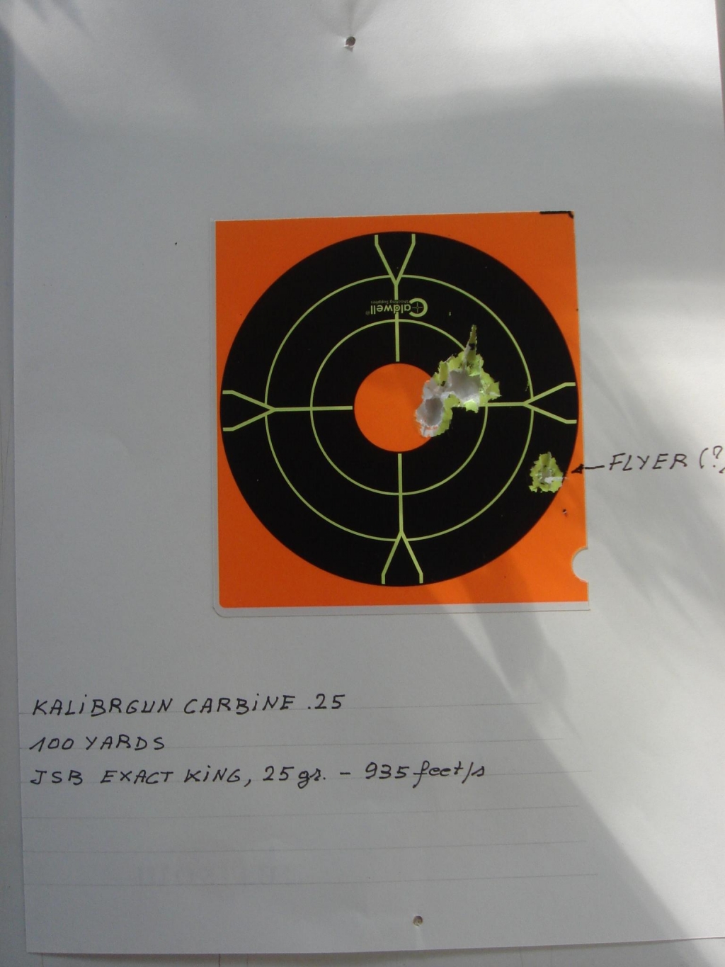

HI , this is one of my first attempts to shoot +/- consistently at 100 yards.
I first tried with my Cricket.25 , shooting JSB KING HEAVY MKll , but the groups were not those expected ; I suspected a problem with the additional moderator….have to check this.
I took my Kalibrgun Carbine .25 , same pellets , and once again the grouping was not very good. I then switched to the JSB EXACT KING 25 gr at 940 Ft/s and bingo , the groups were tight enough,...well for a beginner like me. The conditions were very good : sun and no wind ( it was 7 in the morning).
Scope is a Hawke 6-24X56 , pellets were resized , not lubed .group is 0.7" CTC ,....without the flyer😏.
I usually use the KING HEAVY in both the Cricket and the Carbine to shoot at 50 yards , and it's pellets over pellets . I don't understand why the groups spread at 100 yards. More experiments to come with these guns : pushing the speed up
with the KING HEAVY , lube the pellets , trying other pellets , but I don't think I can do much better than this group . The beginners 's luck , maybe😄 , but I'll keep going.

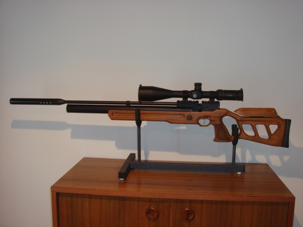

The gun is untuned ; I'm living in Belgium , a small european country in which very few people are interested in airguns .We don't have tuners like Charlie or Ernest Rowe , but the videos and good american forums can help 😃👍. Maybe one of these days I'll try to put a .22 cal barrel on it to see what JSB Monster pellets can do under 55 Fpe , the power of the gun.I just modified the moderator a bit with small holes to make it backyard friendly , as there is no shroud ..Amazingly enough , both guns have the same power but the Cricket , with a shroud AND a Donnyfl moderator is louder than the Carbine.
Just a few more words : the only "tuning" I made was to enlarge the barrel band hole to make the barrel fully floated. The gun is very light , but I consider it more a bench gun than hunting , being a bit long.
